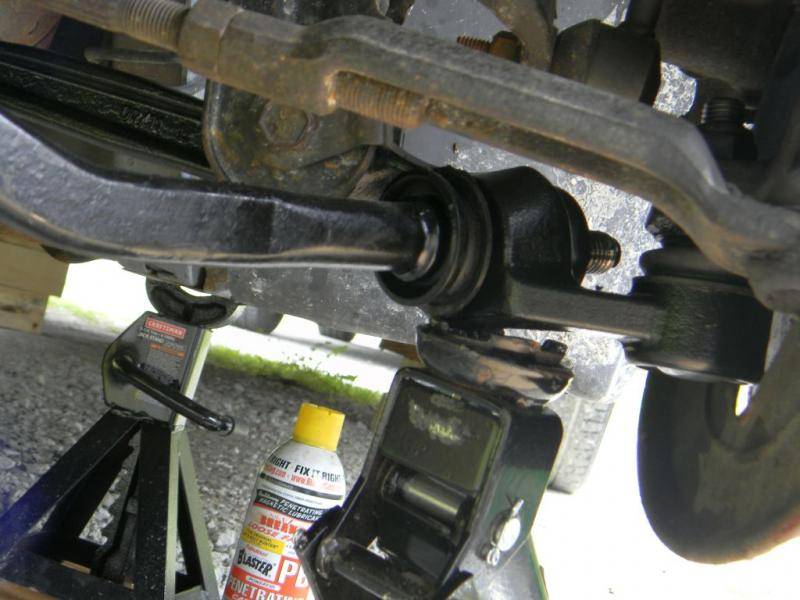

Nothing...mine made no noise or vibration's but had a slight pull to the left (very slight) when applying the brakes, still drove perfectly straight, but there was a noise when slowing down (not sure how to describe it), but when I sprayed PB blaster on the LCA ball joint, the noise would go away for a week or so. From what everyone was saying...it sounded like the LCA,s or the SRB's so I thought I would change both. Waaay to many miles on these!
Was just checking out the ball joint for the first time tonight and there was just a little play and it wasn't smooth when turning it (not smooth at all)! It was defiantly bad (but would have probably lasted longer). The SRB's through the LCA's were bad...bad causing a clunk when turning all the way right or all the way left (still would have lasted longer).
I'm convinced that if there is no play in your forward bushing's, (like mine had....no play), then there still good, but I thought I would change everything anyway (since I bought them in advance).
If you change your FRW SRB's, make some spacer's like I did....they fit like a glove!! These spacer's are SWEET!

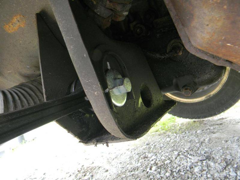

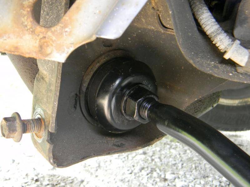

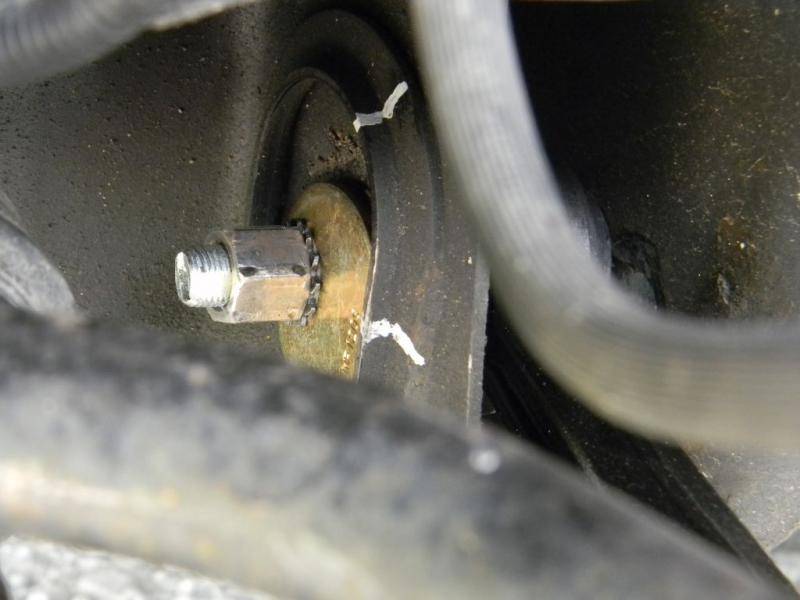

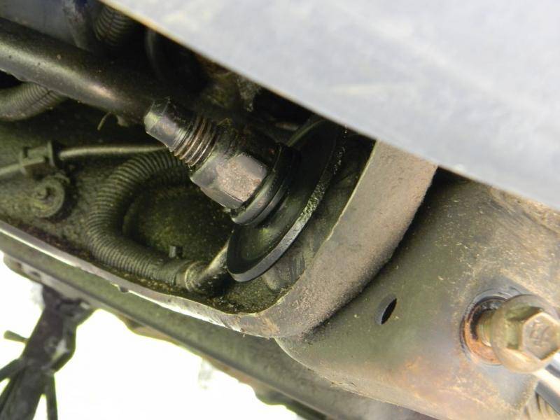

Everything is back together and looking good. The camber bolt was set at -3 so I set the new one at -3, the tire seem's to be pointed out (to the left) at the front. If I adjusted the camber bolt to "0" or +3, would that bring the back of the tire out to a straighter position? Trying to figure this out so I can drive it to get an alignment instead of towing it 25 miles.

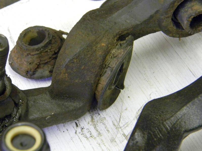

I'm on the passenger side now and the camber is set at "0". This side is coming apart a lot easier, but the SRB's to the LCA are ten time's worse the the DS. Wasn't going to take pic's of this side but I guess I better, (maybe this thread will help someone else out down the road).

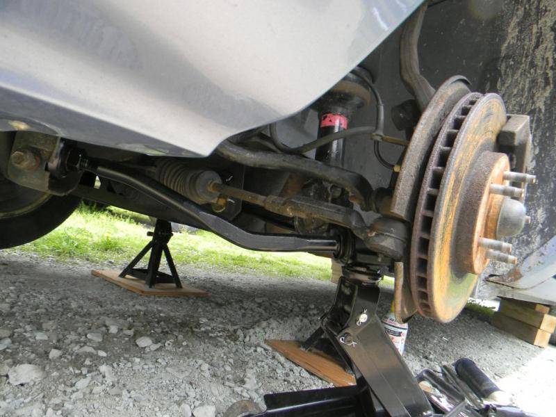

I feel bad that you’re doing this in a gravel driveway, but it looks great!
Laying on cardboard...lol Not too bad, I've worked in worse! Could be snowing or raining!

Anyone have any idea's on the DS...(kicking the back of the tire out a little)? Don't want to mess with the tie rod end if I don't have too.

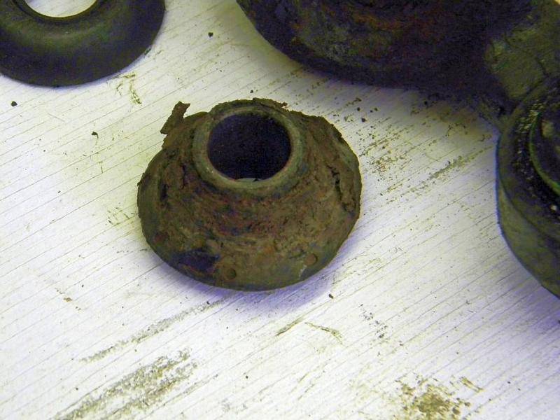

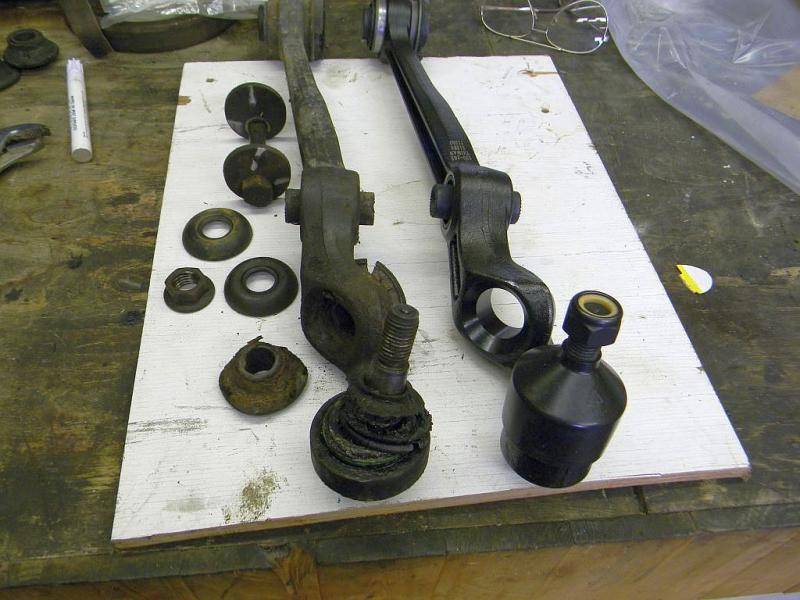

I replaced the FWD's just because I wanted everything new. They were probably still good but I didn't know that until I took them apart, but the spacer's were a rusted piece of crap! They looked like one solid piece instead of two. There's no way I could have re-used them! But both side's are almost done! There is light at the end of the tunnel.
Passenger side is done! LCA bushing's to the SR were terrible! This side was worse then the driver's side, but easier to take apart for some reason, (just a couple hour's to take apart and put back together). Ball joint was shot. LCA bushing to sub frame was also shot.
Adjusted the driver's side camber bolt to "0" to bring out the rear of the tire (eye balled it) (I may have had my +'s and -'s mixed up, I dunno?) but looking at it I knew what had to be done. Rotated the tire's too.

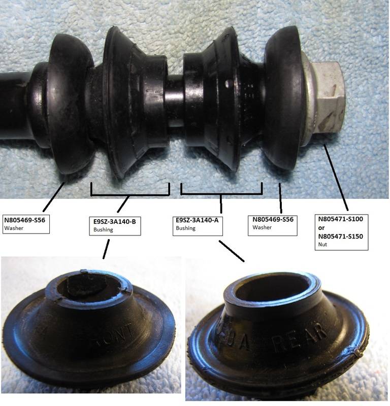

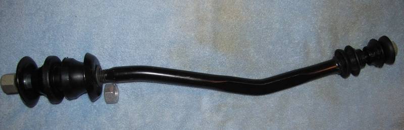

For what it's worth, here are some pics of the proper positions of everything:
