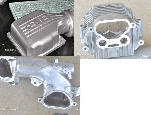

also is your blower ported . i do blower porting and since you are the leader of the blower install here I can offer you a good deal on a D port and modifiy your inlet plenum and port blower and raised top for shipping cost + 430 materials .
I really want to see this project take off . looks good or do you do your own work if so m90s like porting my porting increases mid rpm power .
the raised top lets more air flow and lowers out let temps .
are you running a intercooler? if no room try a pre cooler it will keep the temps down cooler air is power. a buddy of mine does water cooled blowers he winds alluminum tube around blower case and has braught down blower case heat by some 30 deg email me

I'm working with Geoff Knight of BoostHead.com - he's a great guy and ports the casings all the time. The M90 I'm using right now is from him with a 'mild' porting he did during the rebuild.
It will be a long time (IMHO) before we need to look at making more power - I'm already over the boost levels we initially planned for.
My goal is to get the car on the road, tuned, dynoed and then look to the trannie and read-end. The car really needs a LSD.
there are no aftermarket internal available yet (that I know of) so we are stuck at the limits of what the stock lowerend can handle.
You're differently a good contact to tap as we move this to the next levels. I'll also be looking for some nice 'polished' and ported plenums and SC to add a little bling factor and pick up some efficiency once we get it rolling.
