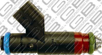

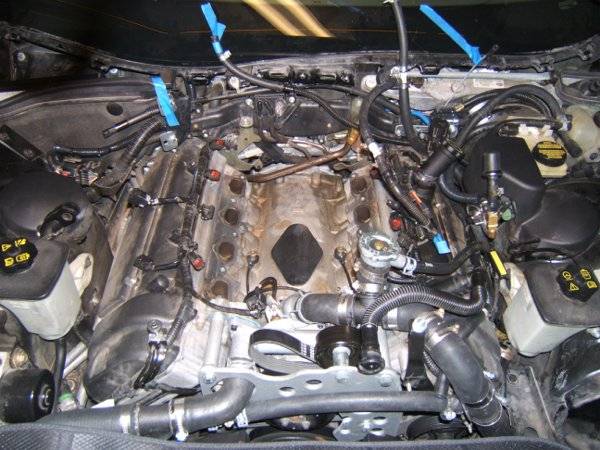

This weekends update....
I was actually in town for the entire weekend.

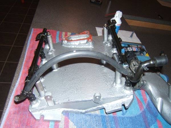

I pulled the SC off the car, removed the manifold and swapped the injectors.
It sure is nice to be able to pull the manifold off without draining the rad!
The pics below show the car wide open - yet again.
The stock 'air-assist' injectors beside the new 2005 Mustang GT injectors.
and the assembled manfold.
I'll put it all together with week and hopefully it ill run much better now that we eliminated the vacuum leak.
