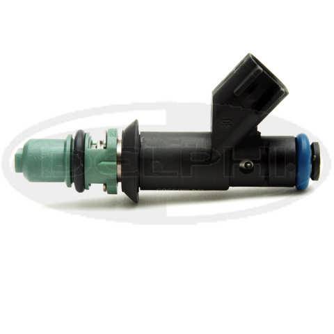

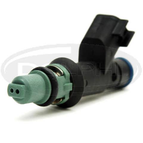

The LS uses a Delphi FJ10533 injector - crazy 'air assisted' design - that the stock intake manifold has an 'air-rail' half way up the injector bung. There is a line from the intake to the air rail. The idea is that each time the injector fires it mix some additional air into the mix providing better atomization of the spray.
The manifold we made does not use the air rail - so I'll dump the air assisted injectors since all it will do is cause a huge vacuum leak for me.

Shouldn't be too bad to tune. You might not have to worry as much as your thinking with the air assisted injectors. They are pulling already metered air from the intake before the charger but after the MAS so its air already accounted for. All it is doing is giving it extra time to mix. You might not be as far off the tuning mark as you originally thought with the air/fuel pre-mix setup swap. As you already know dynotuning with a wideband will be the best/only way to dial it all back in perfect.

Quik...what injector are you using? On our Cobras, we usually go to a 60 lb injector (39 lb is stock) but we have to use harness adapters to make them fit the factory harness. I'm wondering if the 39 lb injector would fit the LS harness? If so, there are a ton of those around cheap and they would be plenty for your application.
Good point 2001ls8sport, I would think it should be the same clip. Just like the picture above. You know whats the funny thing, I didn't notice any air assist crap when taking a look at my injectors on the 05. It must have been something they changed when going to the 03's.
