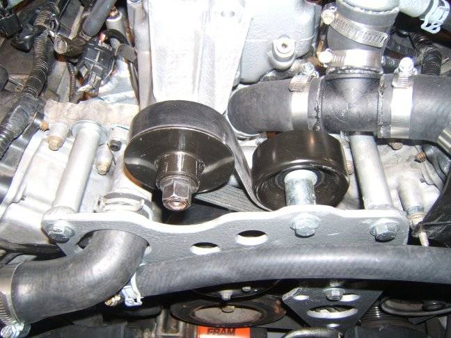

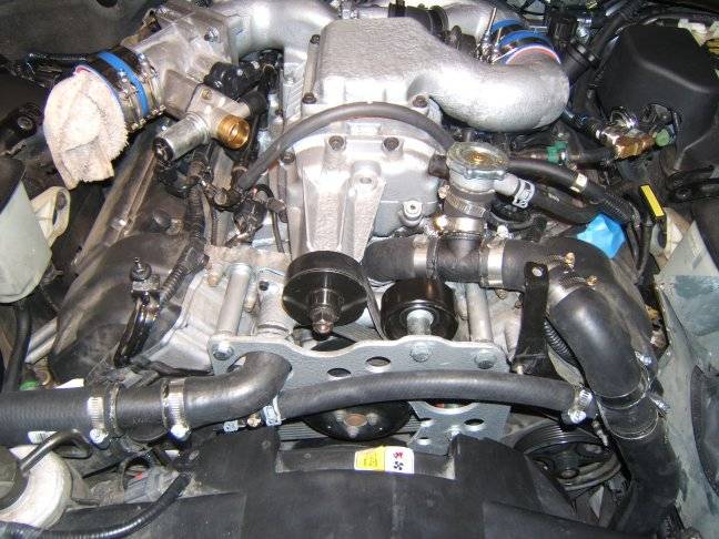

good news - got a belt - it's a Ford stocked belt for a truck 132.44" 8 ribs. I cut it down to 6 ribs and spent 2 hours getting it on - fits perfectly and the tensioner is in the stock loaded location.
I filled the coolant up and charged the battery. Then uploaded a new tune from torrie into the car.
I then started it....................
and it ran for about 5mins - sounds very serious.
but I shut it down when I notice a leak on one of the injectors - at the rail.
so I have a 'little' work to do......
I probably pinched an o-ring or just have it a bit off on the mount....
very close...(I hope)!

looking good. quick how much clearance is there to the lower right where the belt almost touches itself off the dummy pulley? looks in the pick like its nearly rubbing.
yep - it's close (1/4") but everything clears - I'm amazed. At least I have good wrap on the SC pulley ;)
I'm sure there's more troubleshooting after I fix the leaky injector....
Honestly I don't claim to be an expert by any means, and would never attempt half the stuff you do...but that sure seams like quite a wrap around the SC pulley. Are you concerned about damage or the belt coming apart at high RPM's? just wondering

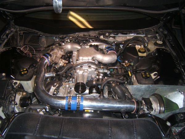

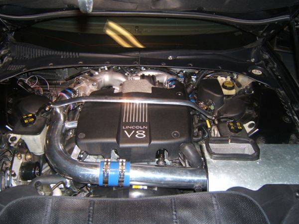

Do you have a intake designed for this setup?
I assume since you have a scoop you are going to try route it back to there.
If you have it designed can you post some pics?
Or can you post sketches of what you have intended;
Well - I gonna keep is as much in the stock locations as posible.
Here are pics of the engine bay with and without the eingine cover.
nah - look at most OE applications - even the cobra is like that.
