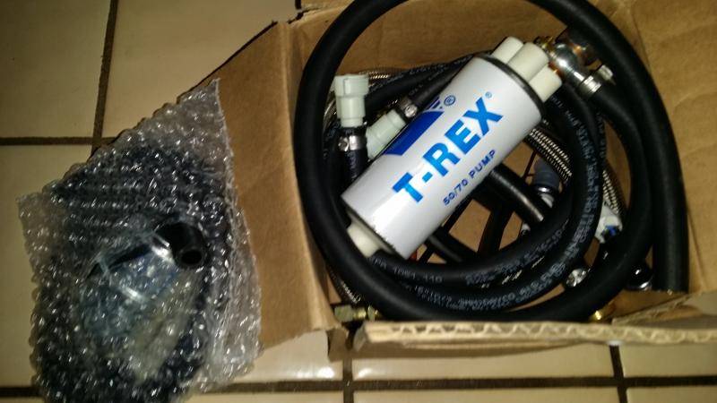

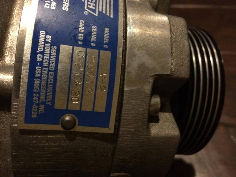

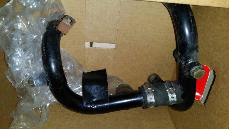

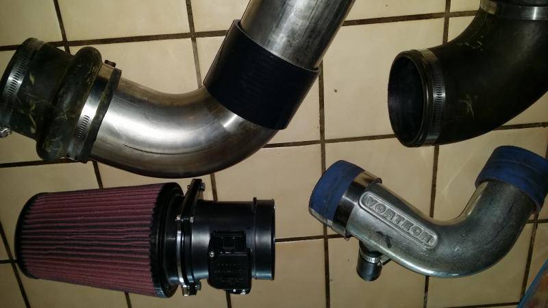

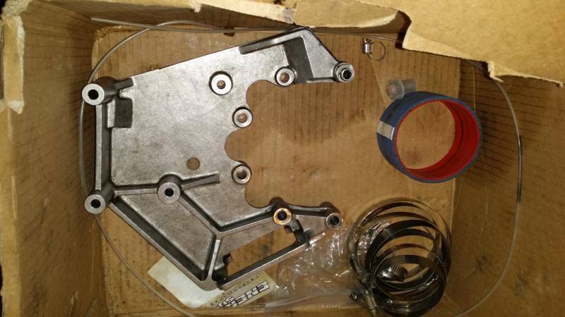

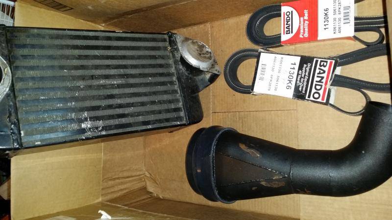

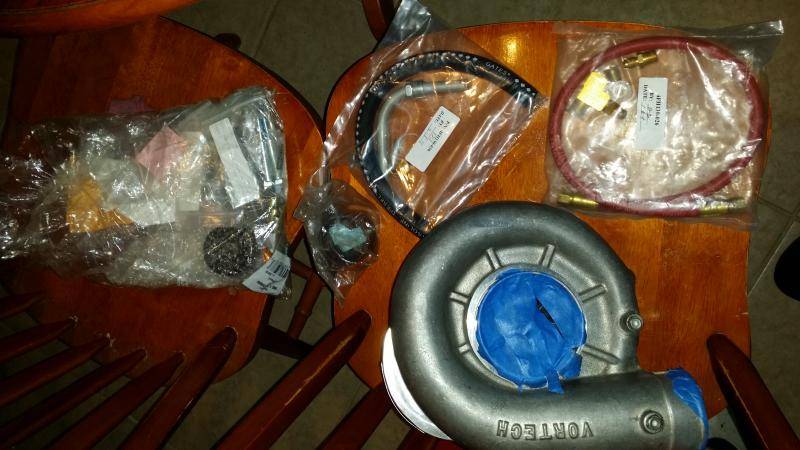

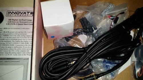

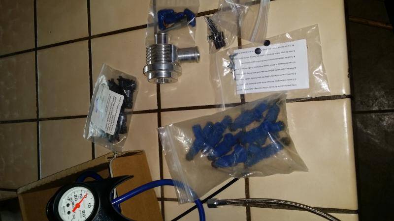

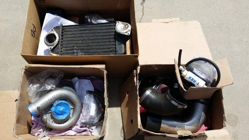

Here is what I have picked up so far.
20140403_134541.jpgIMG_2296.jpg20140403_142340.jpg20140403_142312.jpg20140403_142248.jpg20140403_142110.jpg20140403_141952.jpg20140403_141701.jpg20140403_141429.jpg20140403_142634.jpg
That intercooler looks funky and small. Also make sure the headunit mounting plate is the newer improved one.
how can I tell if I have the newer mount? And what Is the difference between the old and new revised s/c mount.
If you flip it over there are #'s cast right into it. They would break where the idler bolted on. One guy here has pics of it because it broke on him.
