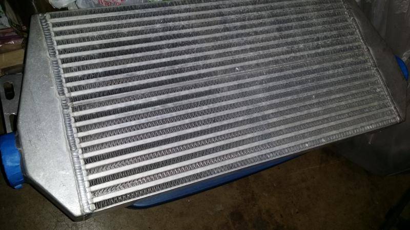

Okay after doing some research I have settled on using the vortech 8n301-390 air to air intercooler. Also I am trying to figure out what piping kit would work best with the least amount of cutting. Any tips or tricks that would make this easier are all welcomed. Thanks.
i picked up a few parts this week. i grabbed a intercooler and a piping kit for the intercooler. now i just need to get the parts for my blow thru mass air flow sensor setup. i may do a pulley shaft seal replacement on the supercharger also since there is a little bit of oil build up around the pulley area on the supercharger.

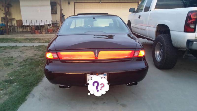

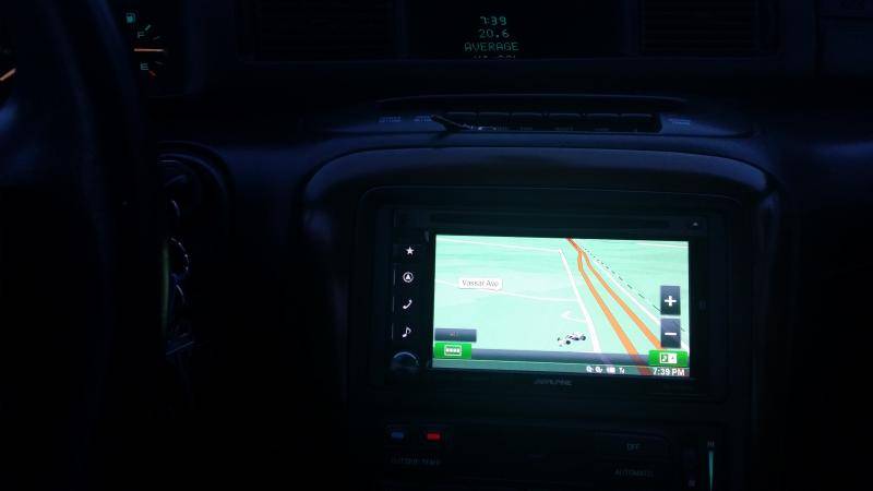

I finally had some time to wash my car and took a few photos. It looks a lot better clean :)
