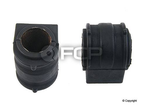

@Damaged,
I can NOT recommend the 30mm Universal bushings and brackets from Energy Suspension! Telling you now, they're too narrow and will end up moving side to side by an inch and half on the sway bar itself.
Instead reuse the stock bracket, clean it up and replace the bushings with the REIN XR819697 Jaguar bushings.
https://www.fcpeuro.com/products/jaguar-suspension-stabilizer-bar-mount-xr819697 order QTY 2

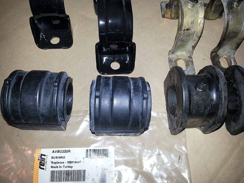

Should stay away from the Energy Suspension sway bar bushings, they are too narrow for the bracket and slide side to side.
there is too much play on these. Member Hite337 put me onto Rein XR819697, I also confirmed the ES bushings move about.
http://www.fcpeuro.com/products/jaguar-suspension-stabilizer-bar-mount-xr819697
You'll need to order qty 2 as the shopping cart misleads you to think qty 1 is a set, which it is not.
Use the old OEM bushing brackets, clean them up and use the Jag bushings. They are a direct fit on the 1st GEN LS.

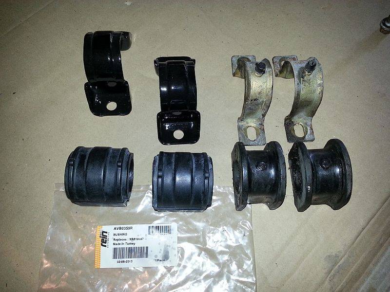

Removed the Universal Energy Suspension bracket and bushings as they are not a good fit.
Replaced with original brackets and REIN Jaguar bushings.
Fits like OEM. Bolt near the DCCV was a PITA again!

Didn't sound like you wanted my comments in your other thread as these ES bushings and brackets are not on my LS anymore.
You could have gotten collars for the ES, or reuse old bracket from 1st GEN and put REIN Jagar bushing in.
The sport front sway bar OD is 30mm, the non-sport base model is not. The REIN Jaguar bushing would sit slightly loose on any non-sport LS. The REIN bushings are more suited for the 30mm Sport model.

Things to keep in mind for others,
1st GEN 00-02 ~ bushing and bracket can be removed by associated hardware, bushings themselves have a split in them so as to manipulate/separate them from the bar itself. Bracket can be reused.
2nd GEN 03-06 ~ Bushing and bracket are molded along with the bar as a single unit and removal would require cutting through the bracket and bushing. Bushing and bracket are not reusable.
1st GEN bushings are no longer in service and replacement is an entire 2nd GEN swaybar which includes the molded around bar bushings and brackets. Sold as a whole unit.
2nd GEN owners wanting to utilize the REIN Jaguar direct 30mm sport replacement bushings could potentially source a set of brackets from a 1st GEN at local salvage or scrap yard.

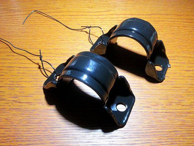

The Energy Suspension front sway bar bushings and brackets, although too narrow, can be fitted with collar clamps to prevent lateral movement. The ES bushings themselves are of good quality.

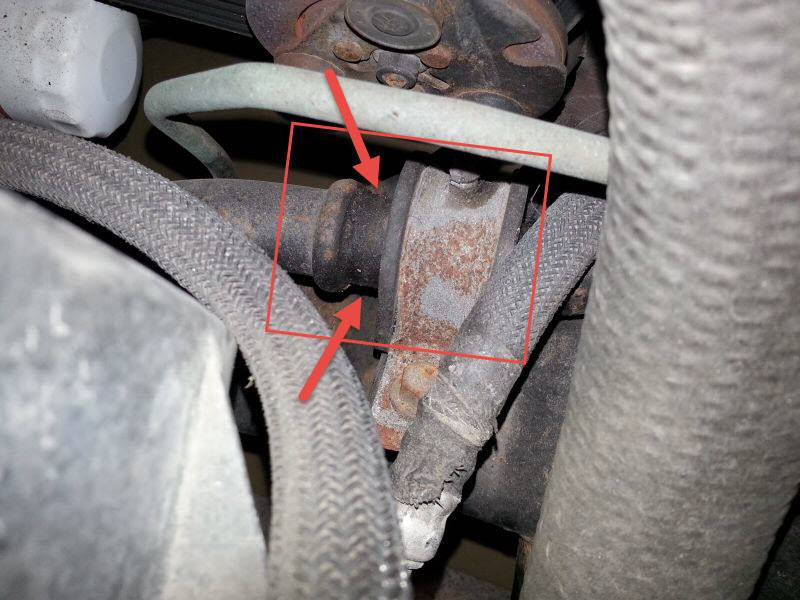

Deacon I thought about the lateral locks, it's just my 2002 sport v8 still have the older style bar that have lateral stops prefab into the bar itself.
Like the one BigRig have in the pictures he posted above.
So it would be less stressful for me to go the route of the jag bushings.
