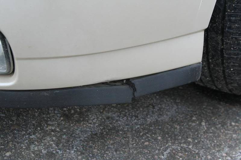

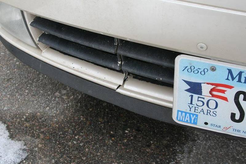

Here's the damage:
I just lowered my LS and just put a new LSE bumper on it. Im very worried this is going to happen. I dropped my car of to get new tires and when i came back my bumper was within a inch of hitting the curb.
