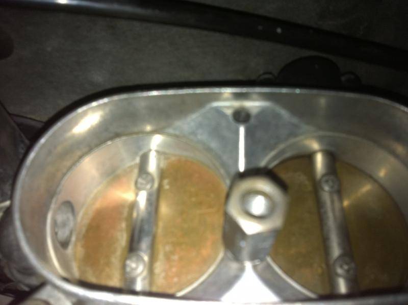

Just replace every vac line you have to eliminate it. Also, cleaning an IAC with carb cleaner is not a fix. Get a new Motorcraft IAC and replace, along with a new gasket and do the TPS at the same time. You'll need a new TB gasket. Don't forget to plug the TPS in before you put the TB back on.
