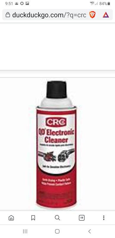

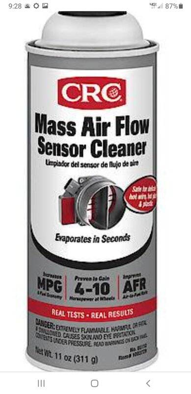

I use the CRC cleaners when needed. I live in Houston where humidity is high.
