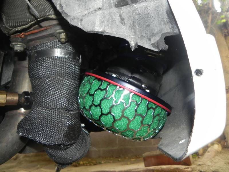

I am one step closer to being able to fully enjoy my ls. A big reason I have not posted a serious video of my ls with the kit on is because I don’t have a filter on it. The turbo sits too close to the bumper so nothing will fit, even the custom filter Brett made with is as small as can be, got compressed once the bumper was installed and it basically shut the turbo inlet close.
I just received the spare cold side turbo housing that I will modify in order to fit a filter on it. I just have to take off my bumper, take housing off the turbo and verify it will fit, then I can begin to modify it off the car without losing my ls while I'm working on it.

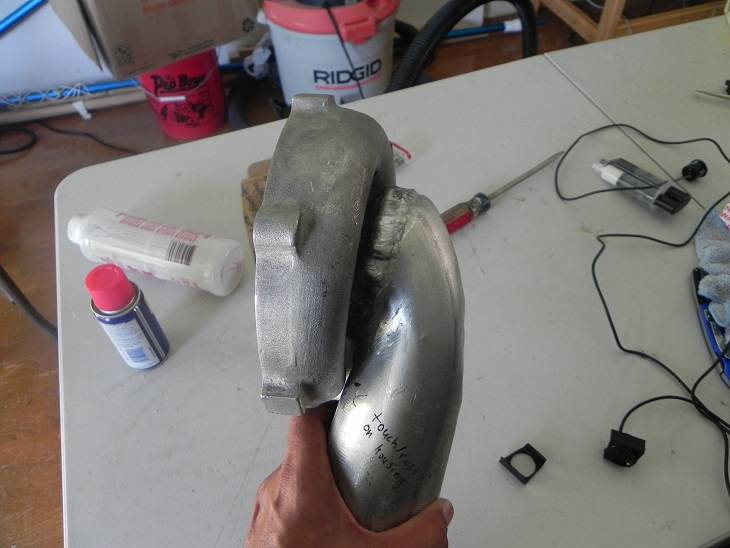

I got my compressor housing welding. Started hammering away and cutting in to the 90 degree bend pipe until this came out in order to be able to run a filter below the housing while sitting so close to the bumper. The kit is pretty much completed now. I can now drive her harder without worrying about destroying the turbo or my engine. So it looks like I will have no more excuses for not getting videos up :biggrin:
It has been painted low gloss black but I was too excited and anxious to finish that I put everything back together along with the bumper and didn't snap pictures of it installed. This was just a test fit without bolting anything down.

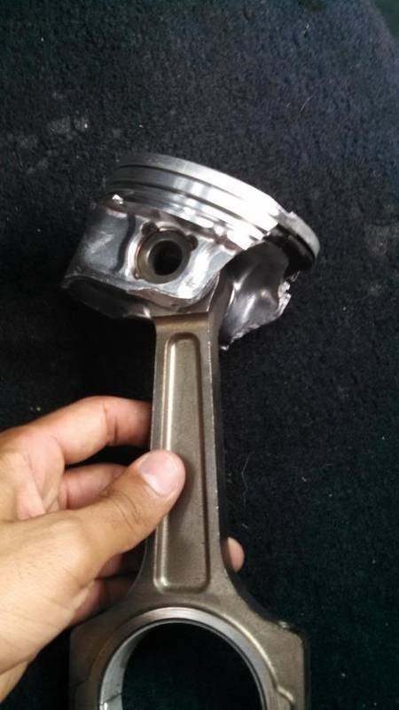

She was up and running great with the new filter and modified housing. She sounded great! But then a week later something happened, I heard a pop like a pressure hose came off, the some loud and continuous clicks, then smoke came out. Not check engine light or anything though. Checked some stuff around, took the valve covers off to see if there was anything obvious that got damaged. A few of my coils were flooded with oil so I got an atc failsafe after putting them back on. That's why I'm going for accels soon, need new coils that are super expensive.
I had some other expenses so I haven't been able to fund fixing her up yet. I wanted to get new coils, plugs, and the valve cover gaskets to get it running without misfires and just have that clicking noise to narrow it down. I've been told lifters or a rod for the clicking sound. Depending on how extensive the damage is and the cost, I'll either fix it and keep boosting or wait and save up to upgrade the internals while they are in there with the motor torn up, kill two birds with one stone.
You might look at what it would take to install a set of Chevy LS coils. Those coils are rock solid, lasting hundreds of thousands of miles. The ones on my truck have close to 300K miles on them and are showing no signs of failure. It would require a custom valve cover, and perhaps a set of plug wires with rubber caps on them (2000 Corolla has this sort of plug wire, for example) that would plug the spark plug wells. If mine fail again I'm going to look at doing this myself, because then I'd never have to replace another coil again.
Some progress...... I guess I was enjoying that turbo too much. Went and picked this trophy up from the shop.
