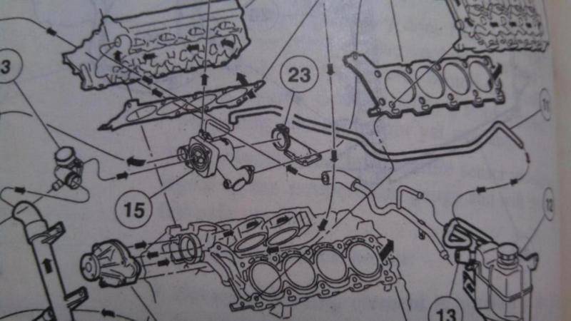

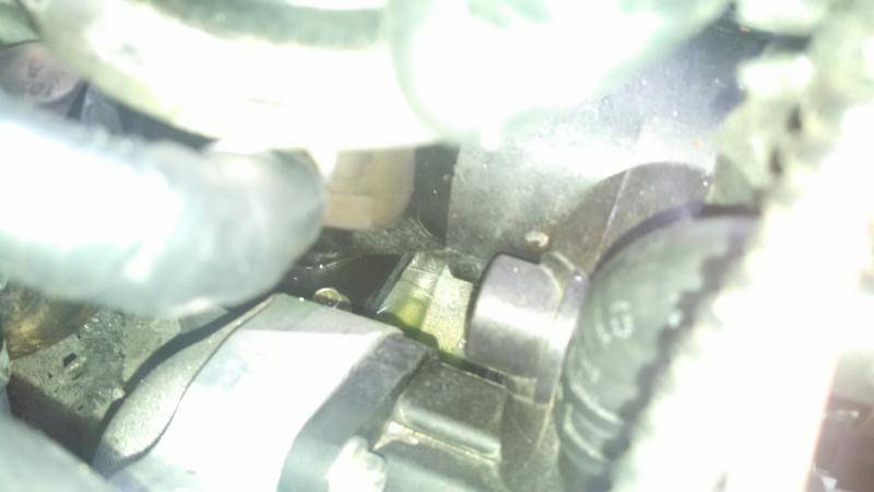

Anybody know where this goes? It's been almost 2 years, I can't find where this hose would go.....
Yea Alax, that is the famous under-the-intake elbow piece. Many of us have had to cut those back two bolts to remove. You can replace them with the same bolts used to hold the Tstat in, and they are the perfect length.
