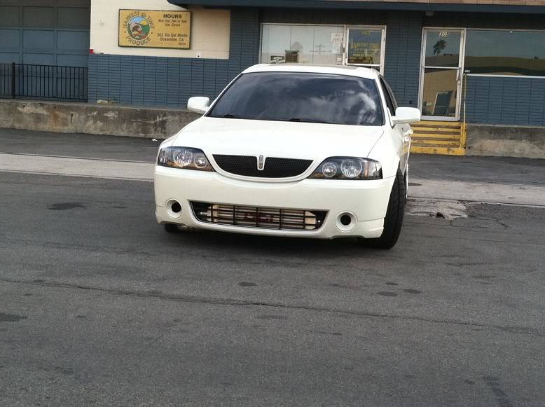

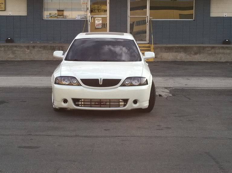

I didn't know Home Depot sold intercooler :shifty:

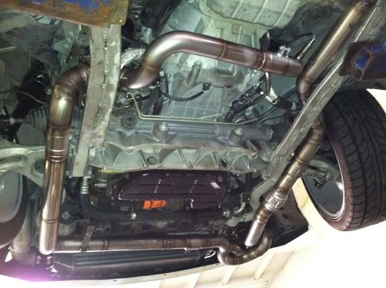

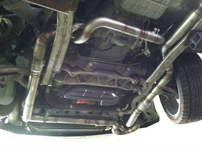

What about the cats? Why an "X" pipe if the exhaust has already gone from 2-1-2? The tubing is lower than the frame braces which tells me if you lower you will drag that nice tubing.
That's what I was wondering? Those sub-frame connectors are the lowest spot on the undercarriage of these vehicles.
Damn there is not much room under there!
I understand the wheel lift concept, but that is cutting it reeeaalll close. At least on my car.
Because I can see on those A-Arms on my LS where I sometimes scrape on humps. And those pipes are awfully close to that point.

In the first picture the pipe seems to be hanging down quite a big, but the second it looks more hidden.
That's some crazy routing, not much space. Also, good looking welds.
