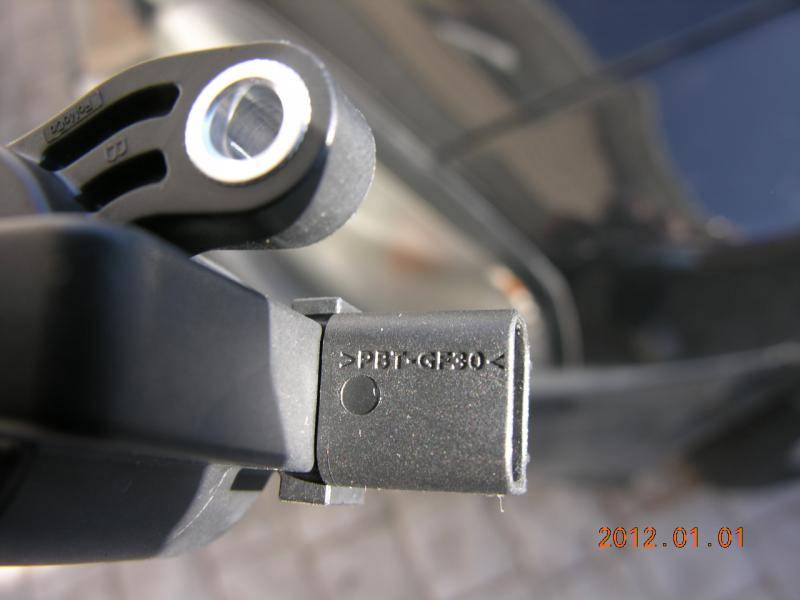

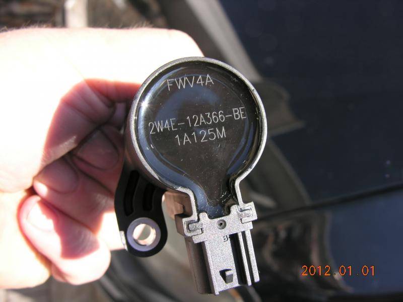

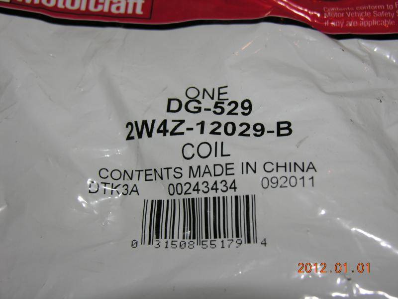

Here are the pics from the latest batch of Dealer sourced coils which are China based. On the bottom of the mounting leg is cast FoMoCo.

I think I'd buy Hungarian sourced coils before China sourced......
No, I KNOW I would!
same here...that's why I brought back the 'chinese' Motocraft DG-529's...and picked up the 'hungarian' Visteons...saved $200 of my coin
trust european fingers touching 'my coil' more than chinese ones....you know....with SARS, STD's and sh*t running around ;)
