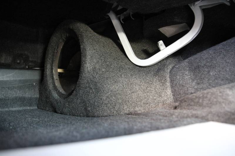

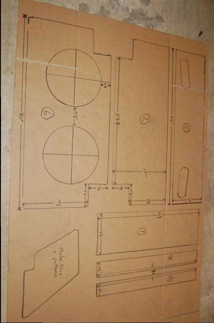

Basically to get this kind of fit and clearance you have to remove the factory speakers then make it piece after piece screwed with drywall screws out of MDF checking fit after every piece starting with the base going up the front then around the trunk springs across the top then the face with the sub holes.
The smaller side pieces that seal it up are made using cardbord patterns after the other pieces have been screwed together and some bondo was used.
I used a hand grinder to make the angled edges for the sloping instead of a table saw.
MDF grinds very easy.
The subs vent into the car through the 6x9 factory holes and I also used some tuned ports for that instead of the slots in the picture on the advice of some members which is written about near the end of the thread.

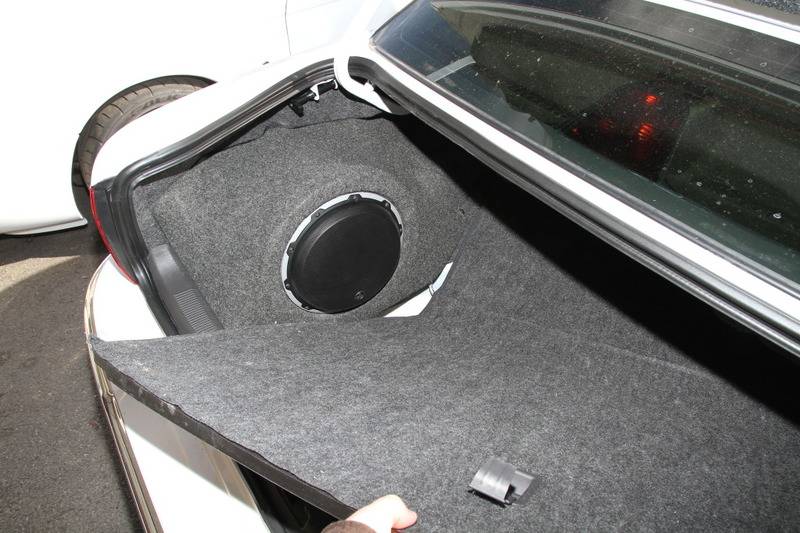

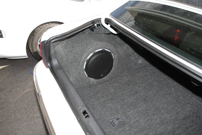

My 3.9 cu/ft box is built piece by piece to efficiently use all the space available as tightly as possible while taking up very little of the useable trunk space and allows access to the battery and tire well without having to remove it.
I'm running 2 12s but it can hold 2 15s too.
That still takes up ALOT of space. Not being able to fold the rear seats down would kill me.. I travel all over the country in my car lol.
Here's what I did. Amp is hidden in the spare tire well.
Battery and Spare access is still available
Doesn't get any closer than that..

so what if you need to do rear suspension (struts/springs) work? Is it easily removable?
sorry if its a noob question, dont know much about these things. I've been happy so far with my THX system lol
It doesn't interfere with with getting to the struts at all.. In order to remove it, you have to remove the woofer to gain access to the two screws drilled thru the bottom of it that go into the trunk floor/rear subframe.. I could have it out in 3 minutes if I needed, yet its mounted solid :)
