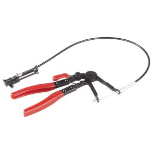

It's not too bad. Especially if you have the tool that compresses the factory clamp. I got mine at Sears.....

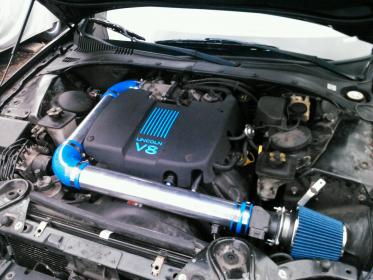

Got a part in the mail and all I have to say after installing it is... Gen1 intake go vwoop :)

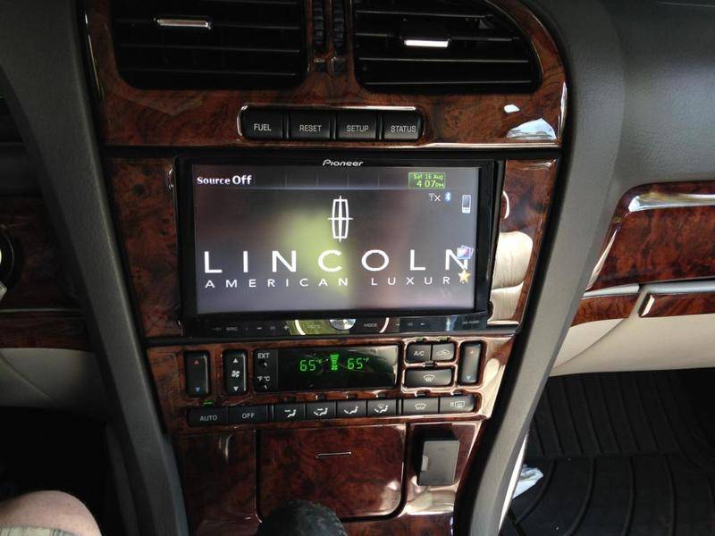

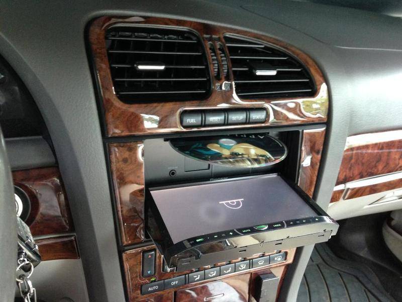

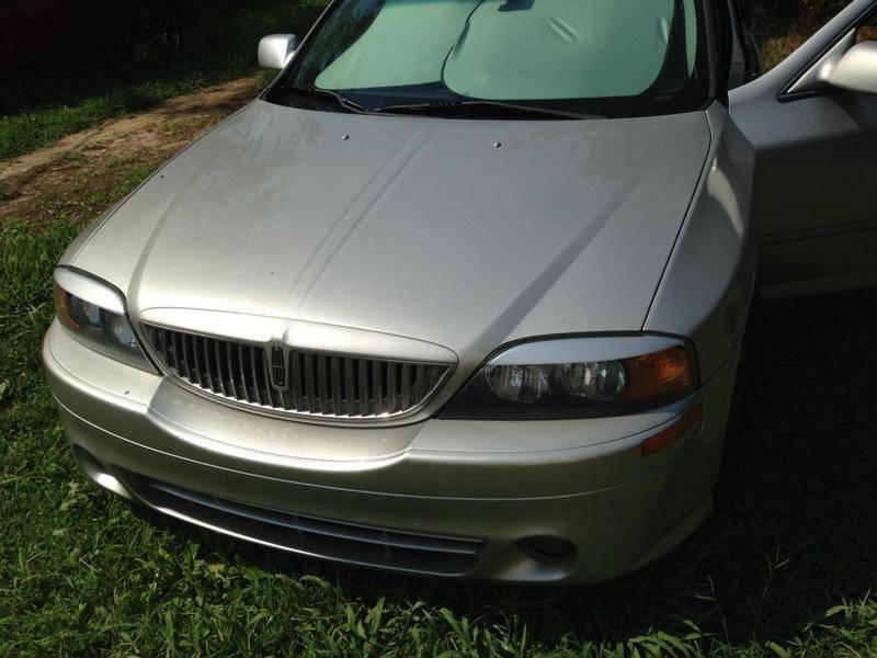

First post, Joined and read all the great info on here before I made my mind up on the right one. 2002 LSE , V8. 145000 miles, one owner. All service records from day one, done at dealer.

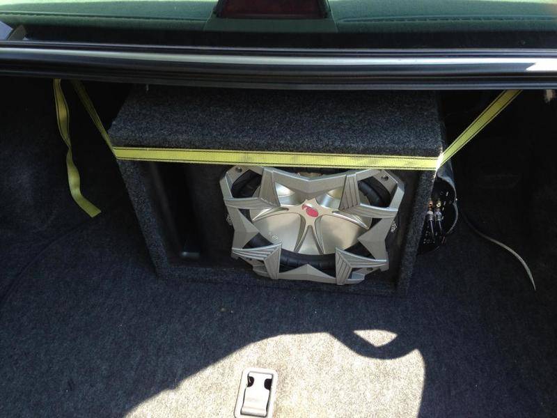

What I have done is so far is polish headlight, Pioneer DVD, removed factory subs and added one I had, straped down , keep sliding. Complete tune up , Coils, Plugs , So on.
