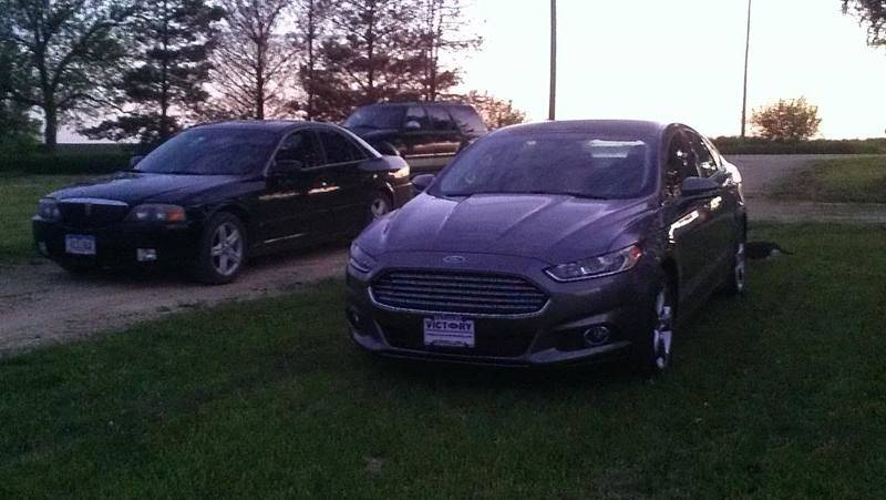

Drove it to the dealer to pick up the wife's new 2013 Fusion SE.....in the mean time I was able to sneak out and take a 2013 5.0 Mustang 6 speed with 15 miles on it for a beat session on the interstate...haha...I heart Coyote! But the LS is just so smooth and quick...I love it too.

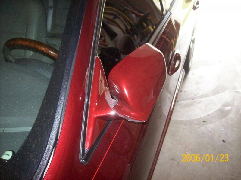

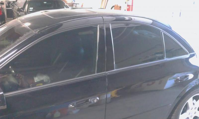

Installed these. Gen 2 '06 folding mirrors on my Gen 1 '00. Need to wire up the puddle lights.
Removed the underbody LED lights. Still have the interior and trunk lights.
Cut off the Mercedes AMG exhaust tips. Welded on some straight pipes for now. Waiting for the new tips to arrive. Don't want the bumper to melt.

And you didn't convert them to power?
They are power mirrors. I have a 2000 with power mirrors. The folding mirrors are off a 2006. The pin for the puddle lights is not in my wiring harness for the mirrors. They will need to be wired for that.

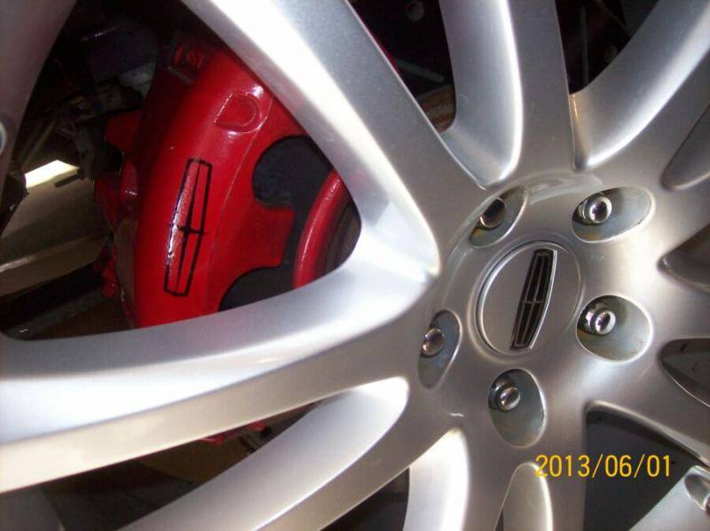

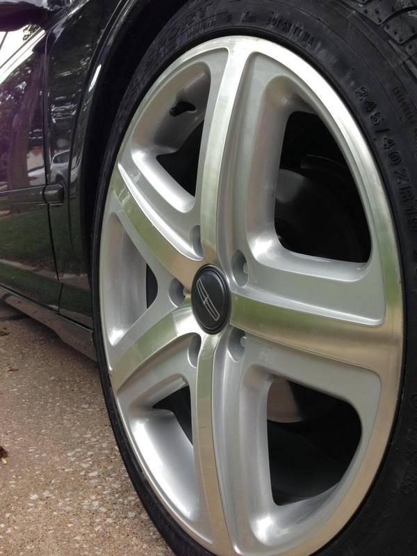

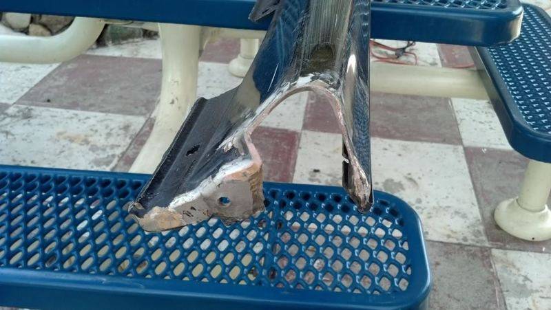

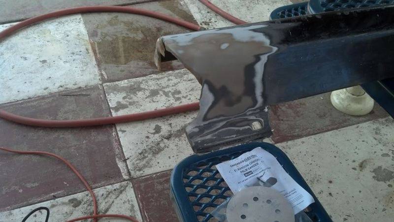

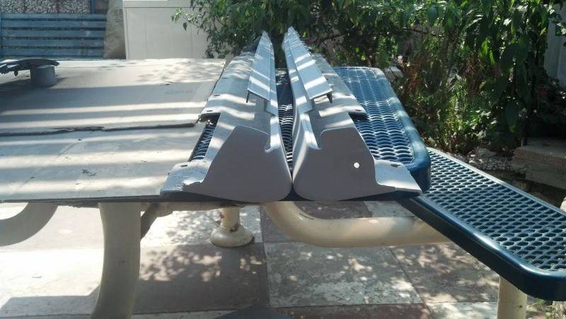

New caliper mod.

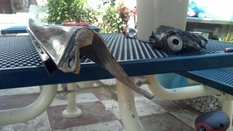

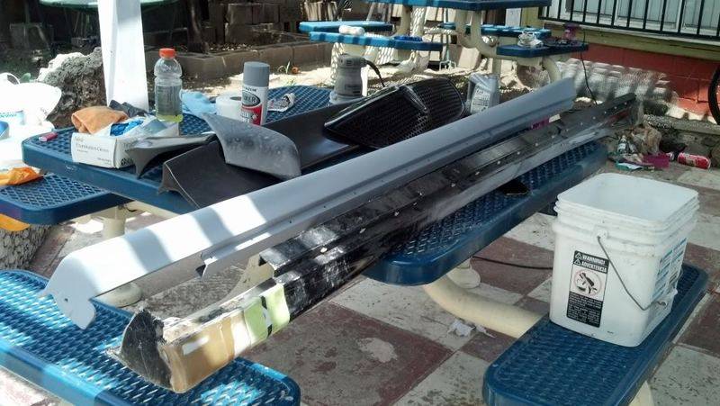

Razzi kit removed.

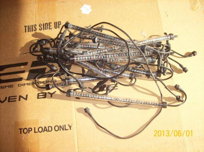

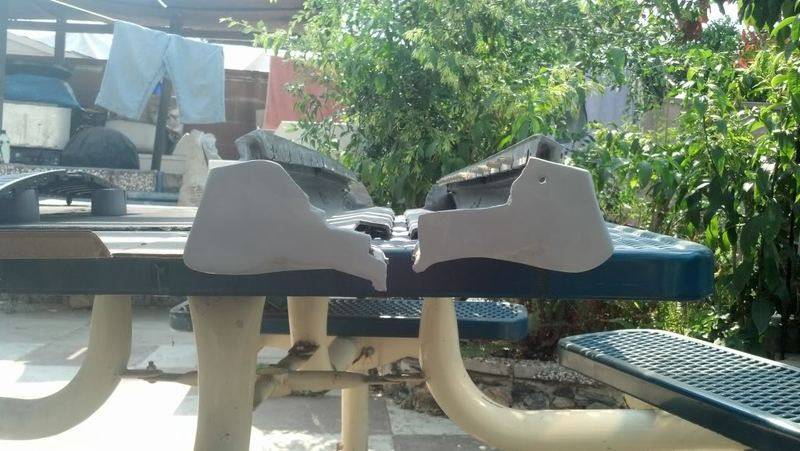

LED lights removed.

I guess I should have been more specific. I meant power folding mirrors. All LSes have power mirrors.
I will have to wire them up for that too. I didn't realize they were "power" folding.
I did the same mod and I wired into the interior light in the door panel.

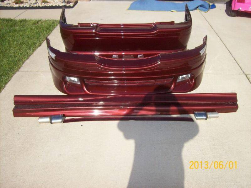

Different features with the two gens. I didn't know. I thought it was something I missed....lol.... I am trying to get a run to or near Anton to deliver the body kit & accessories. I am excited to see his LS finish and mine. Mine will be done end of next week.

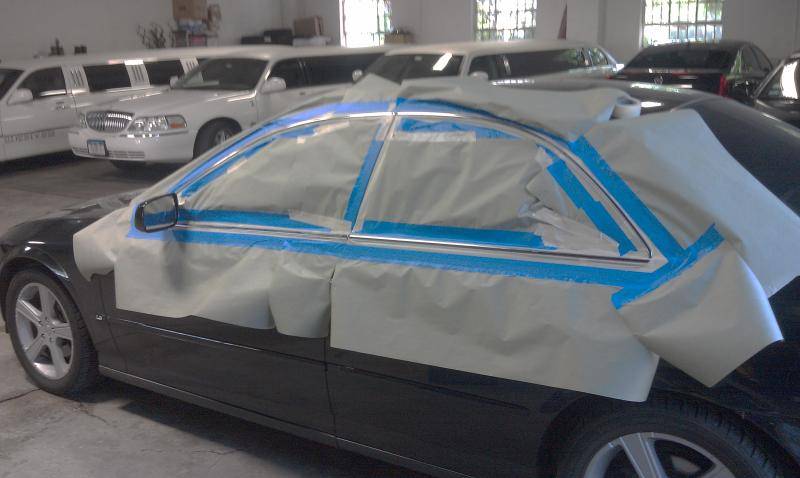

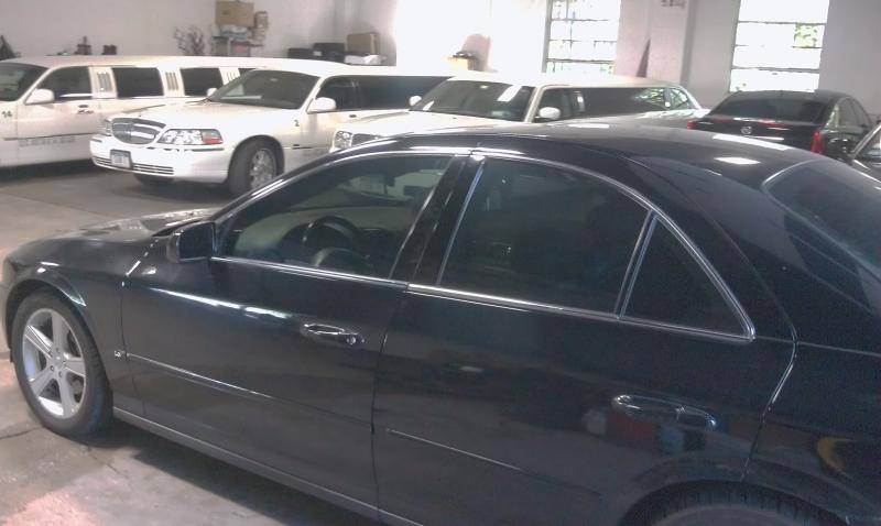

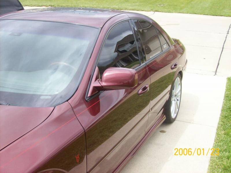

It takes me a while to do things sometimes with my busy schedule, but finally blackened out the chrome trim around the door windows, used Plasti-dip. Overall the look is there but if I was to do it again I will just do it with self etching primer and trim black paint like I did to one of my Mark VII's. If I am going to take the time to mask everything off might as well just paint it. There are a few sections I want to do over as when pulling the masking tape it did not leave a clean line in places, had to go around a lot of it with a razor so it would not keep pulling he plasti-dip.
BTW, don't mind how filthy the car is, did not want to wash first and deal with water screwing up the adhesion, and suppose to rain later today.
