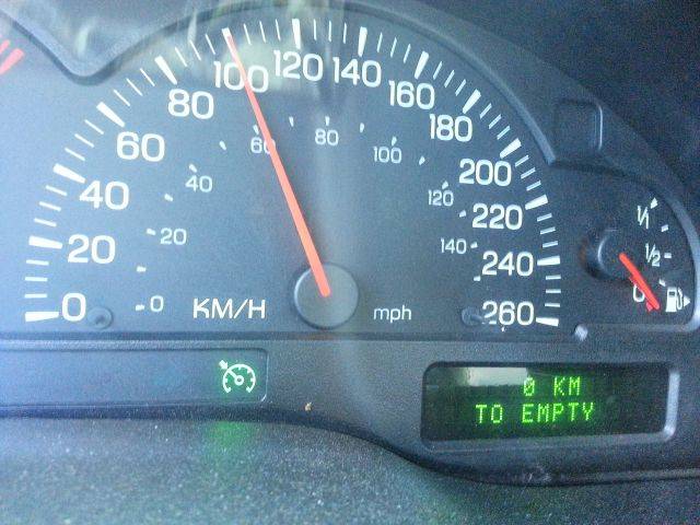

Almost didn't make it to the pumps this morning.
Put on some much needed go-juice.​
I think your speedometer was installed upside down with KM/H on the wrong side of MPH. I thought you were Canadian, not Australian...
You just jelly my speedo reads 260 hehehe ... :rolleyes:

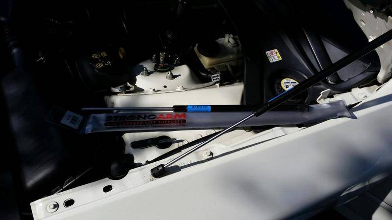

Replaced my hood gas struts since originals were starting to fail. Went with the Strong Arm brand. Made in USA and appear to be good quality and an exact size match. Took just minutes to swap both out.
