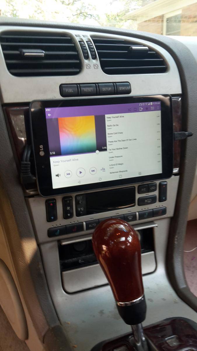

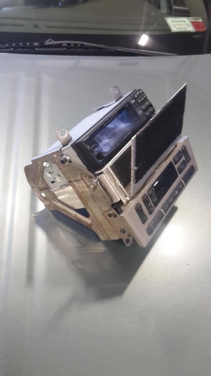

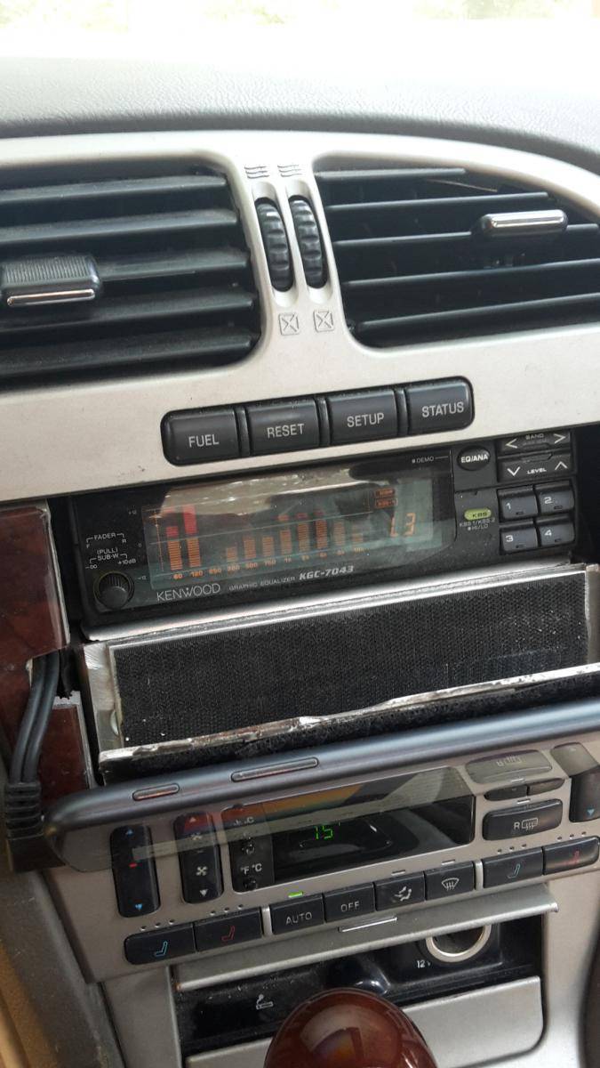

Also my 7" Galaxy tablet from 2011 stopped working so I replaced it with an LG I got free and upgraded my EQ
to a full din kgc 7043
