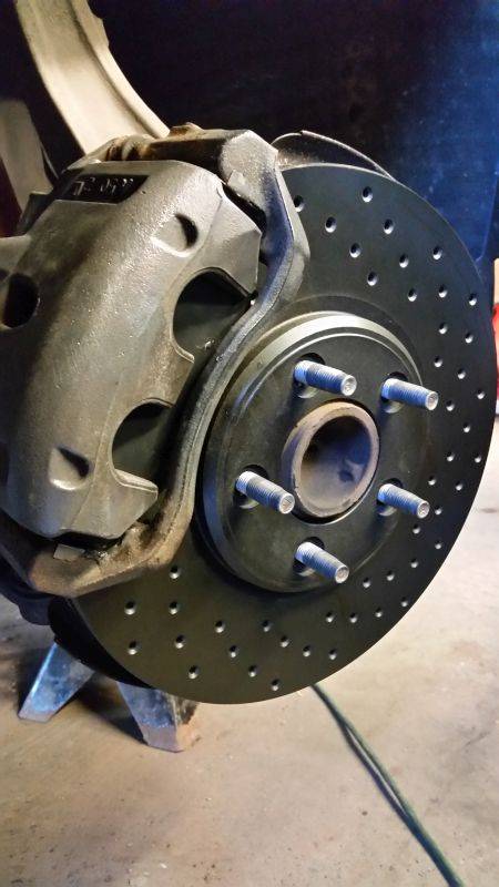

Did the brake refresh last night on the 04 LSE
R1 Concepts and new pads all around.
[COMPLETE KIT] Black Cross-Drilled Brake Rotors & Ceramic Brake Pads CBX.6109002
cleaned up the calipers and brackets, ready for paint.

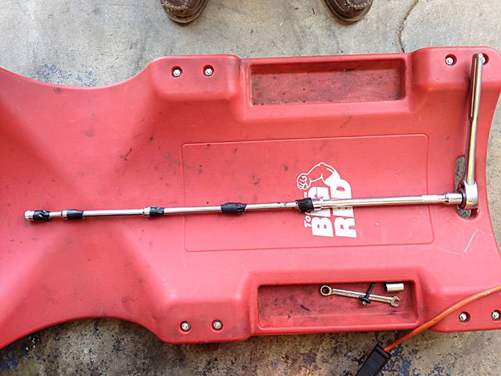

I was finally able to finish the job of replacing the Ford better idea bonded sway bar bushings with ES bushings and collars as per Deaconblue's writeup. Used Mobil 1 Synth lube to grease the new ESes. It took me weeks instead of hours due to an illness and weather and having another car and ... laziness I guess. But it's done and it quieted the car somewhat. Still some noises I'd like to track down. Also I tried to add a 'Thanks' to deaconblue's writeup but for some reason it didn't stick. Here's a pic of the tool stack I had to use to get to the troublesome forward passenger-side sway bar bushing bolt:

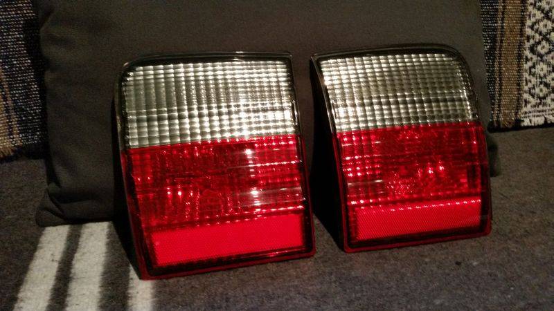

Two tone Euro first GEN inner tails
~ LOOKING TO BUY SOME OUTERS ~
willing to pay large dollars! PM me if interested in selling.
This is another one of those things that I did not realize that are different between the Gen I and Gen II until I was out washing the car this afternoon. I always knew the shape of the inners were different, but didn't realize that the Gen II had the smoked clear turn signals (or at least the Sort models?) while the Gen I were all red.
Dumb question - wouldn't it be easier to swap to the Gen II truck lid and then just use the Gen II tail lights than to try and track down the Gen I Euro tail lights? Or is there a problem with the Gen I bumper cover or something else that will not allow you to use the Gen II truck lid on a Gen I car?
The trunk "lights" aren't lights; they're reflectors.
Yes, trying to transplant 2nd gen trunk lights would require the lights, trunk lid, license plate surround and bumper... At least.

... wouldn't it be easier to swap to the Gen II truck lid and then just use the Gen II tail lights than to try and track down the Gen I Euro tail lights? Or is there a problem with the Gen I bumper cover or something else that will not allow you to use the Gen II truck lid on a Gen I car?
On top of what LS4me just added, the retrofit would then also need a 15yr old paint match. Which is always guaranteed to be slightly off.
Another option as they are being slightly tinted, I could simply use 2nd GEN outers they'd just be missing the ribs in the lens structure.
I could also sit on them for a while ... like others short of a complete set.
