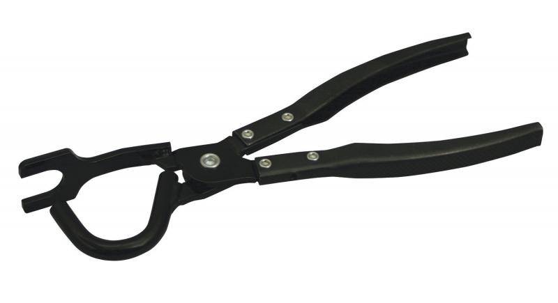

I found that it was difficult to replace the rear window regulator. All went smooth until it was time to put the last 2 parts in - the 3/8 in long plastic pins that must be shoved thru the regulator's window 'cradle' as well as thru the window itself, pinning the two together. So 3 holes (window and one on each side of it in the cradle) must be aligned (not a real problem alignment was good) and then the 2 concentric pins must be pushed into place. This was not so easy. Only way I found to access the holes was thru the rear (outside) of the regulator. Essentially working blind, I was able to push the 2 in a ways but not all the way. My hands, fingers just not strong enuf. After thinking a bit on what tool might help, I remembered a tool I had purchased several months ago for removing exhaust hangars. It was just right for this job. I carefully lined up the pusher cylinder plate on the back and over the pins and the u-shaped surround on the front , closed hard on the grips and heard a little 'pop'. It was a good pop as the window pins were now exactly where they should be.
The tool I used was this one:
Lisle 38350 Exhaust Removal Pliers.

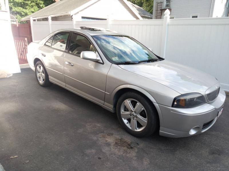

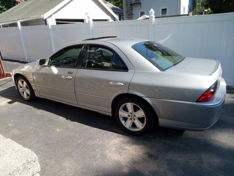

Since I purchased it from the original owner a little over a month ago I've done:
Oil Change
New Pads & Rotors all 4
New RainX Wipers

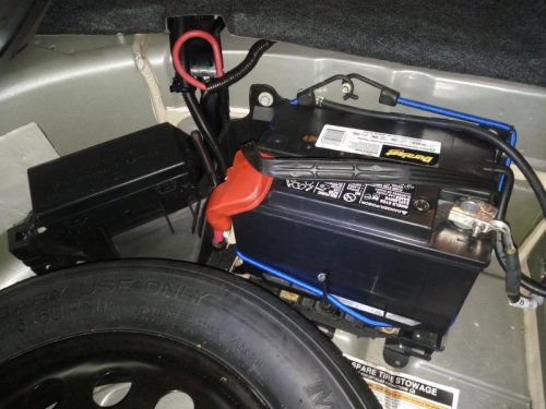

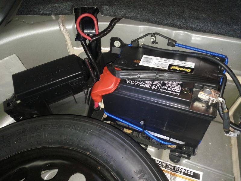

Connected vent tube @ battery (was disconnect for some reason)
New Cabin filter
New seat filters
New Belt (this is the most difficult car to replace a belt on I've owned, had to drain coolant and disconnect piping + air filter just to get to the belt)
Transmission oil exchange (dealer)
New Michelins all the way around
Got the strut covers today
Got missing manifold cover clip from dealer
Installed the cargo net

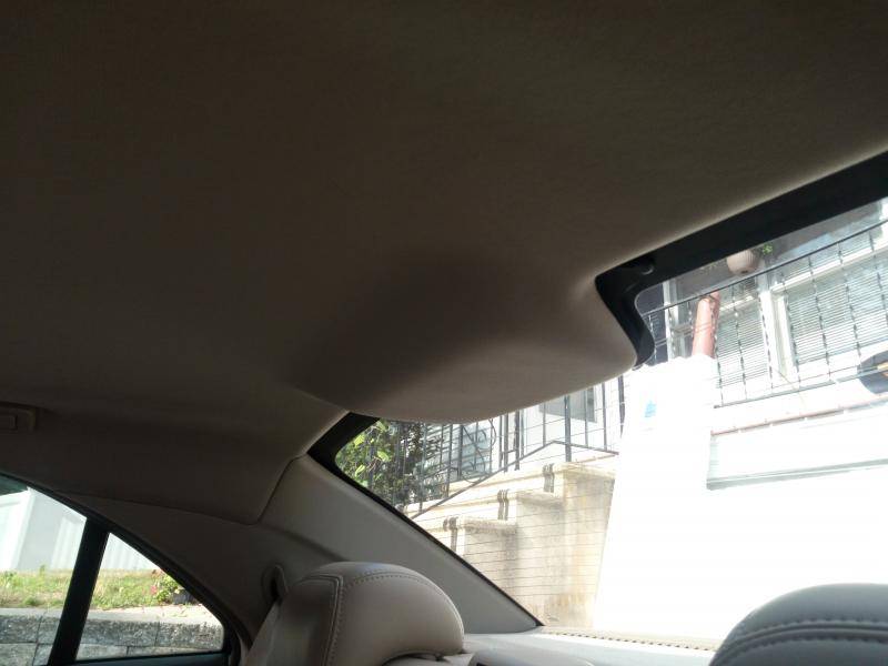

Repaired rear drooping headliner
Repaired drooping headliner around sunroof
Dust/vacuum inside out + leather treatment
2 coats of Meguiars wax
To do's
Ignition coils
Spark plugs
Coolant flush
Maybe aftermarket exhaust
Installing battery hold down bar
Fix drivers side puddle lamp and power mirror (dealer says may have to replace mirror)
A little TLC can go a long way

Bought the motorcraft battery with the vent on it. What a waste the guy that sold the car just threw a new one with no vent tube to get it going. Probably not much difference in cost either. Guess I will craiglist the other to try and get some coin back.
