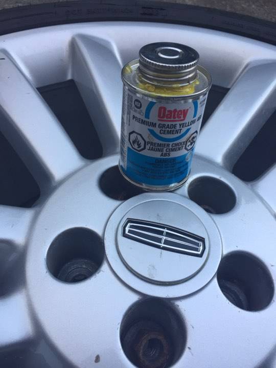

Changed my fuel filter today and fixed my broken tab-less Lincoln emblem cap on my wheel using abs contact cement and rubbing alcohol, we will see how long it holds up.

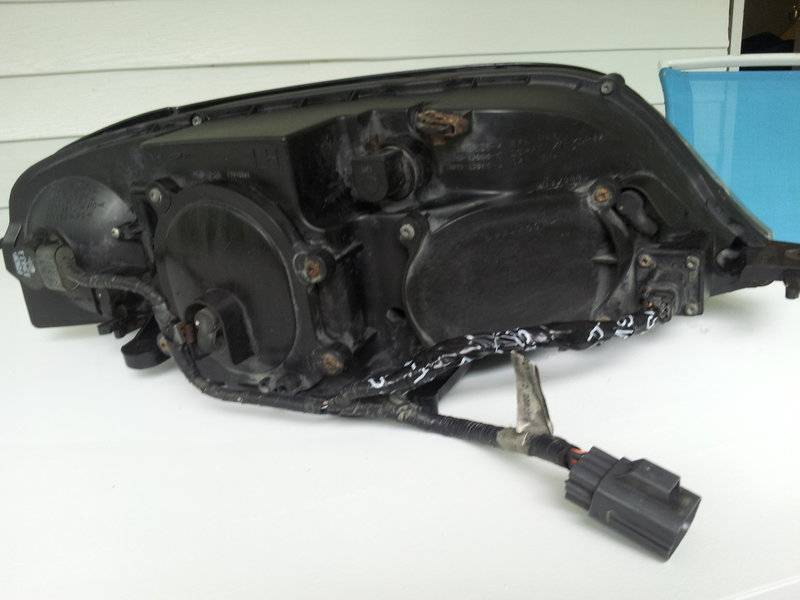

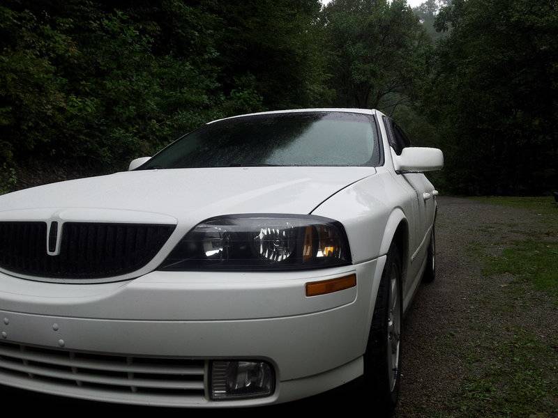

Gen 2 headlight swap without cover removal. Gen 1 harness was used except for the 6 pin connector to the HID's. The high low connections from the Gen 1 harness to the Gen 2 on the drivers side connector are:
High Beam: Gen 1 Orange Black wire to Gen 2 Orange Green -
Gen 1 Grey Green wire to Gen 2 Grey Red
Low Beam: Gen 1 Orange Green wire to Gen 2 Orange White
Gen 1 Grey Red to Gen 2 Grey White
Remove the Gen 2 signal light harness & swap amber bulb over to Gen 1 socket.
Passenger side may be different. Just mate up the orange and grey large wires and test that both match when high and low beam are selected.

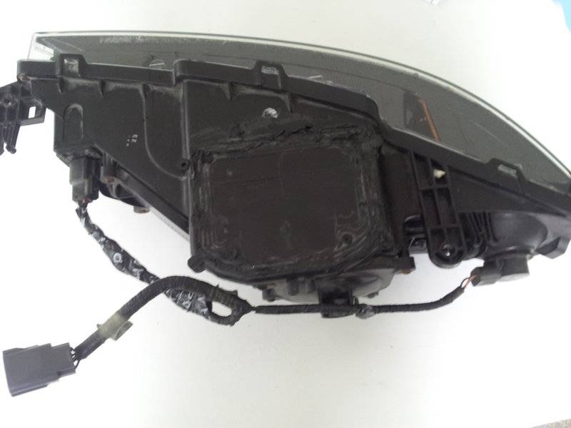

Modify the bottom of the Gen 2 light buckets as shown in the pic. The middle area needs to be cut flush. You can use air tools like a air disc cutter or air body saw.

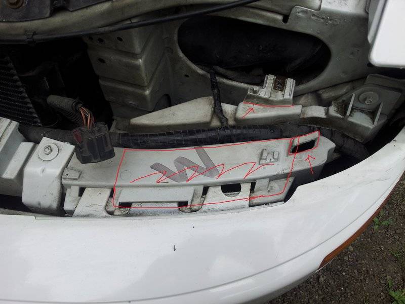

Modifications to the light cavity where the wiring harness is located will need to be made as well. The included pic shows red lines where raised areas will have to be cut out to allow room for the light to sit flush. This will eliminate the rear most mounting screw boss, but one can be fab'ed up if needed. I feel the other two hold the light well enough.

Wait - so you put Gen2 lights on a Gen 1 car? What's the advantage?
