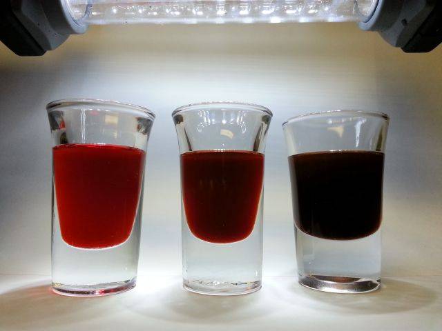

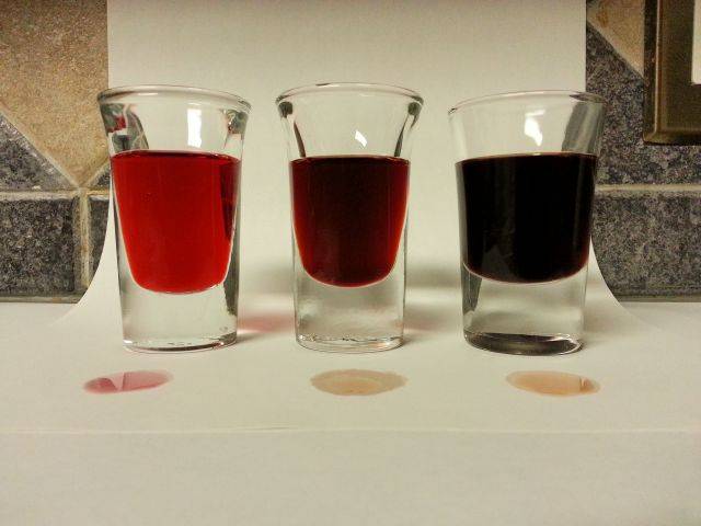

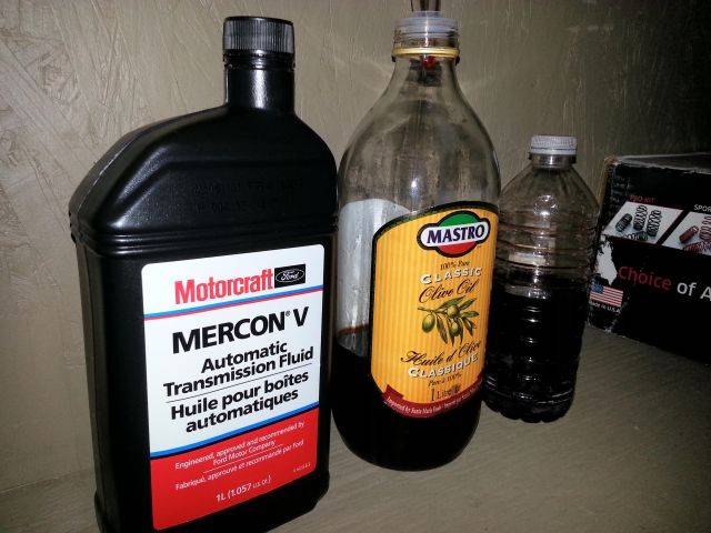

MERCON Shots anyone ?

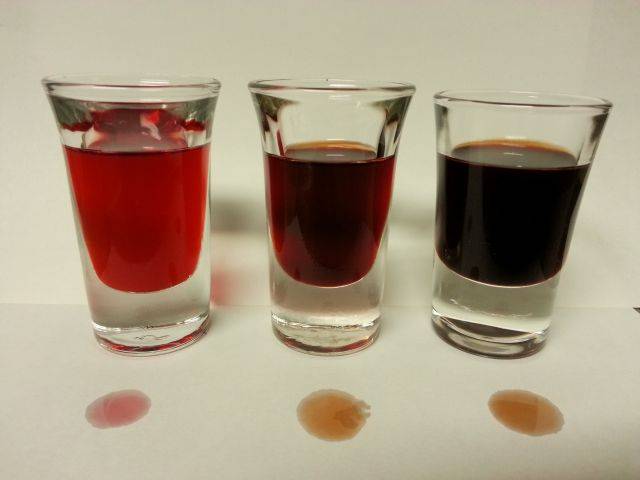

Changed some fluids last night.
Left to Right,
1) Fresh new Motorcraft MERCON V ATF
2) Used Hydraulic Cooling Fan Fluid
3) Used Power Steering Fluid

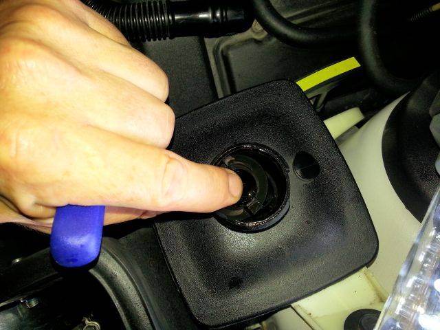

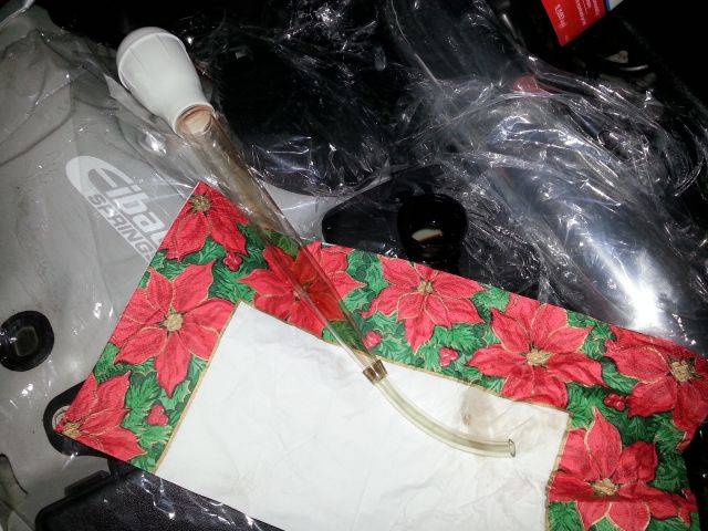

Handy Dandy Homemade Turkey Baster suction extension.
You'll need it to turn the corner around the level floats on both reservoirs.

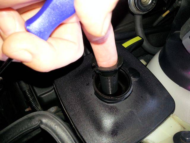

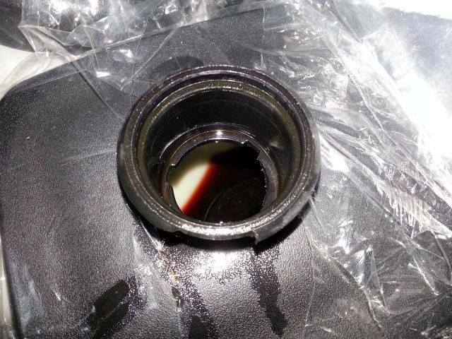

Power Steering has a handy little filtering screen that will have to come out
Loosen two side clips and pull it out so the suction extension can reach the bottom.
There are floats in both reservoirs which will require some navigating around to get all the fluids out.
Refill with fresh MERCON V ATF and recheck levels, run the LS and crank AC to activate the Hydraulic fan motor.
Double checked all other fluids and oils, topped up the washer and Brake fluid some.
All systems GO ~ clear for take off, Fun Fun Fun ...

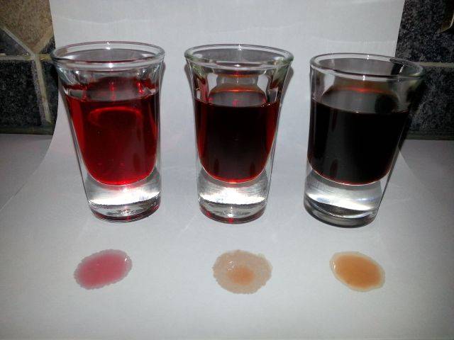

Left to Right,

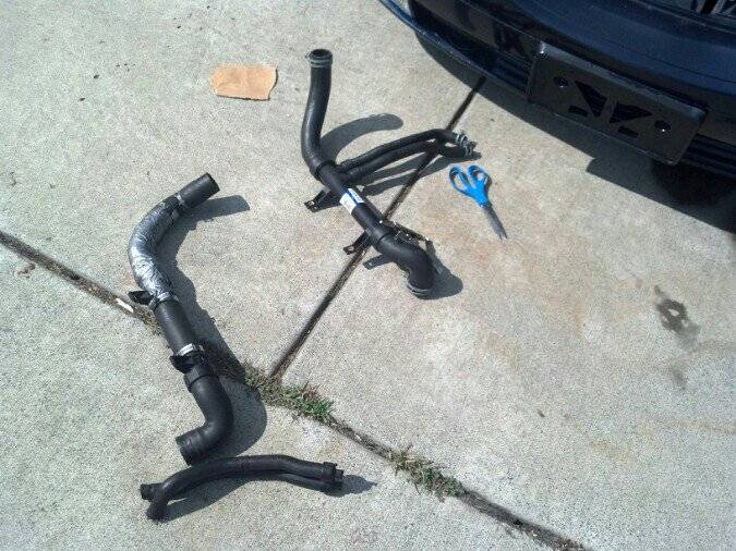

Replaced my lower radiator hose, the culprit of my overheating problems
Then gave the LS a good bleeding
