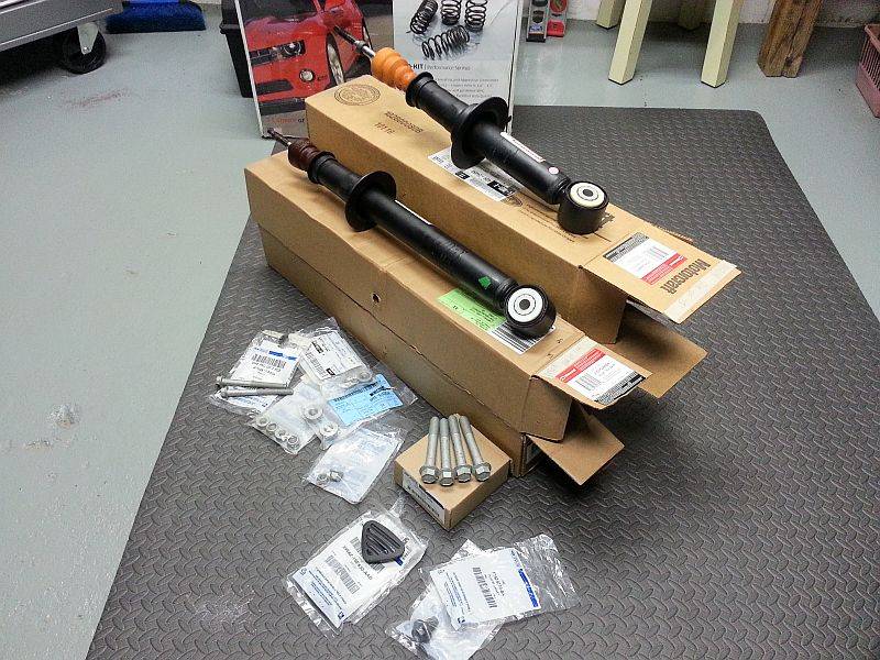

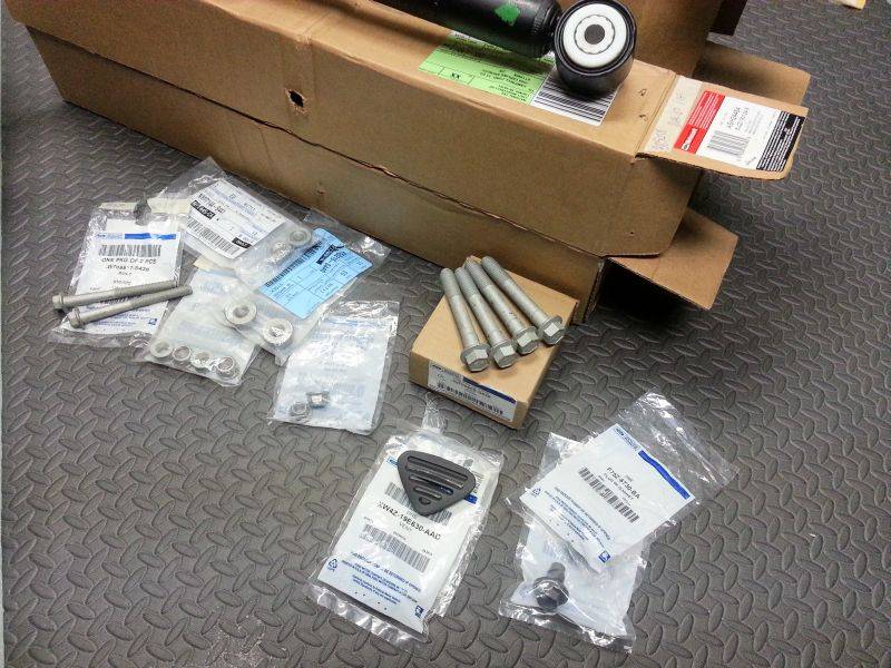

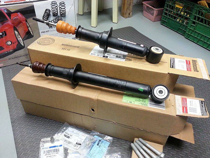

Picked up my new "Special Suspension" Sport Struts from the local Stealers today,
Green for the fronts, Purple for the rears. Actually got good pricing on these.
Nuts, Bolts, Fresh Oil drain plugs and some new side vents.
Eibach springs going in the rear this season, fronts already done last season.
That purple is certainly purple, but that green looks less than accurate.

^ Purchased by VIN of my LS, P/N's have changed, comes up as Special Suspension group fitted. Green is Green,
Base numbers stamped directly into the struts themselves. These are the ones that come up for this 01 Sport LS V8 by VIN.
Why would you say "green looks less than accurate" ?
Because it is orange...

Color of rubber bushings on the ends?
The descriptive color code group designation on the part number is referring to the color tags on the shocks themselves directly below the stamped P/N. Not the rubber bushings.
If you look closely, on the rear shocks, there is a little round purple/lavender color swatch and on the front shocks a green one. (that one is painted on leaving brush marks as opposed to the round)
I thought you knew that ...
2X Front Shock Absorbers // 18124 (AST-25)
'00-'02 V8 Front "Special" (Sport) Shocks: ASH24464 or BU2Z-18V124-R or 1W4Z-18124-DA or AST25
1W43-18045-DA - AST25 - Shock Absorber FRONT COLOR CODE GREEN - w/PERF SUSP
2X Rear Shock Absorbers // 18125 (AT-704-G)
'00-'02 V8 Rear "Special" (Sport) Shocks: ASH24468 or BU2Z-18V125-U or XW4Z-18125-BA or AT704G
1W43-18080-BA - AT704G - Shock Absorber REAR COLOR CODE PURPLE - w/PERF SUSP

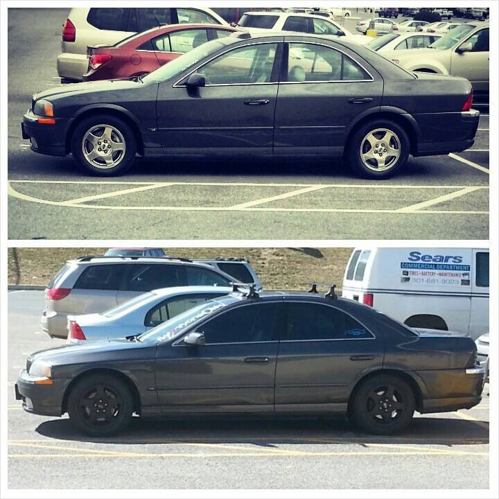

Re- Dipped the wheels, Fuel system cleaning , And all of a sudden the brake/rotor shield broke off the right rear and is bouncing around in there, so I'll be removing that in the morning before school -_-
^ Nice! colormatch the bumper trim chrome, IMO would look finished.
Thanks guys, I'll be covering the chrome trim next week right before this car show on the 30th more pics to come
