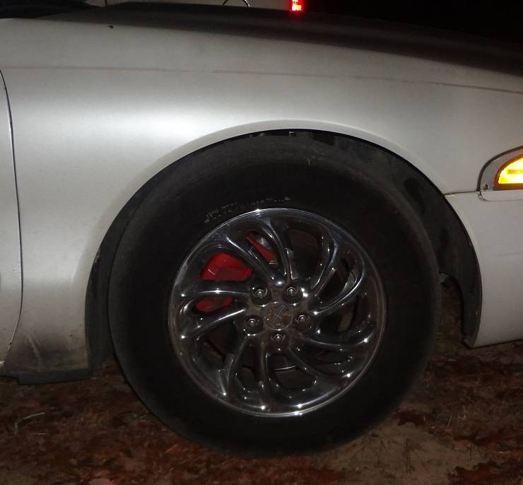

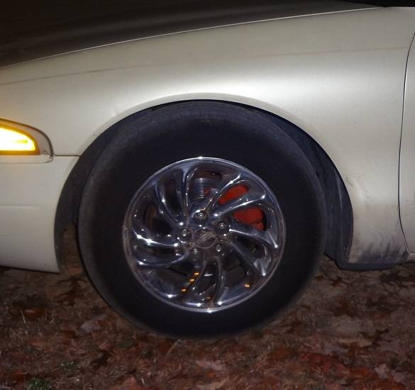

Turns out the knocking sound I was hearing wasn't the suspension. The shop apparently took the front wheels off for some reason and didn't tighten the lug nuts:eek: that's pi$$es me off! Tightened the lugs and she drives perfectly now. Problem is the P/S wheel looks like it's been pushed back in the fender well. I'm going to take it back to the shop tomorrow to tell them about the lug nuts and ask them why the wheel looks weird.

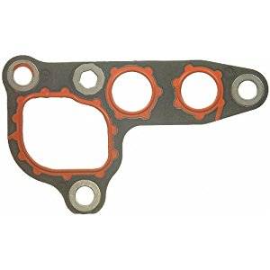

The thing that leaks famously on 4.6L Ford engines is the "oil adapter gasket". Located on the driver's side of the engine, it's a Felpro part number 70415 - I've changed several. They leak as they get older and look like this:
That, and the OPSU
Yeahhh..... that's ALL leaking. Adapter gasket, OPSU, you name it. Plus my oil pan is rusty as hell. I have my late model pan off geting powedercoated right now actually.

Update: Took the car by the shop this morning. They measured the wheelbase on both sides and it is difinitely off about 1/2" on the passenger side. They said to drop it off in the morning and they would try to fix it.

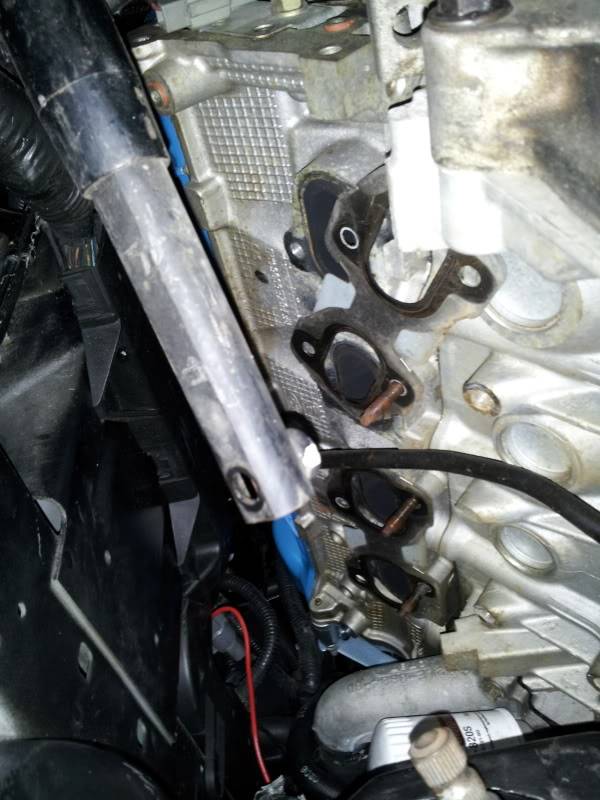

Took my driver side manifold off and welded it, bolted back up-wasn't too bad. Now I want headers

Sorry, Traction Control. It still did it after I tightened all the lug nuts. When I get it back I'll clean the sensors and see what happens. I just dropped it off at the shop again this morning to get them to fix the p/s front wheel. They measured the wheelbase yesterday and it was a perfect 113" on the d/s and 112.5" on the p/s.So it's definitely off quite a bit. It's never done that before so I'm relatively certain it has something to do with the alignment they performed. It has brand new LCA's and SRB's at the control arm but I don't think that would cause that much of a change:confused:
Update: Got it back from the shop a little while ago and the p/s front wheel is nicely centered in the fenderwell now. It looks much better. :)
