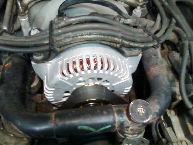

took out a working, noisy, alt w/ 174k; put in a shiny new DB Elec alt w/ no miles on it...easy peasy
I wonder if I should keep the old one and a 1/2'' drive torque in the trunk for a couple of weeks?
I've been running a db for almost 2 years now. My old one has been in the trunk ever since. :cool:
No matter how expensive, no alternator with the exception of a new mc unit can be trusted in these cars. ;)

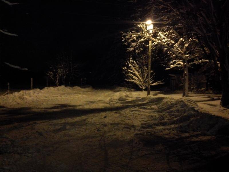

Our firs real snow this year 13-15"
The mark would like some blizzacks now but she drives just fine by all the fwd cars in the ditch
Pic is this morning
...she drives just fine by all the fwd cars in the ditch...
:lol: Love that!!!
One of my favorite stories to tell is how I used my carappy old wore out '94 Exploder 4x4 to pull a brand new AWD Honda Pilot out of a ditch in the snow back in '09 or so:D FWD is for sissies!! I'm :lol:ing at the "superior" traction of wrong-wheel-drive...

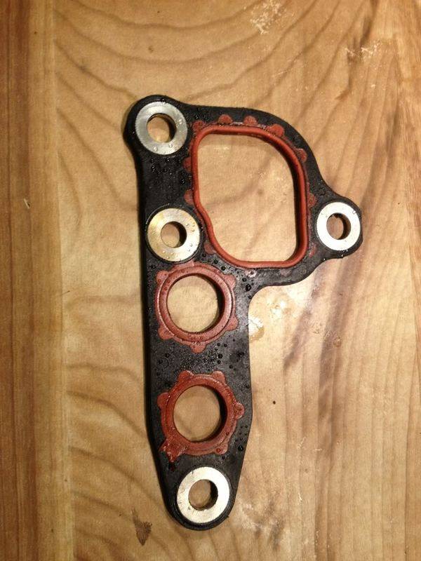

I changed my oil filter adapter gasket today on the LSC; it's not super tough on these cars as I've had it on other 4.6L Fords. I went through the fender well & used a 3/8" ratchet with a long extension and 10mm socket to get the top two bolts out, then a swivel on the end with the socket to get the middle bolt. The last bolt has to be gotten from under the car and I used a 3/8" ratchet, swivel, and 10mm socket to remove it.
I noticed the oil filter was a bit loose when I started and thought that might be where the oil has been coming from, but since I had already started this project, I finished it. The old gasket didn't look too bad, here is a pic of it:
