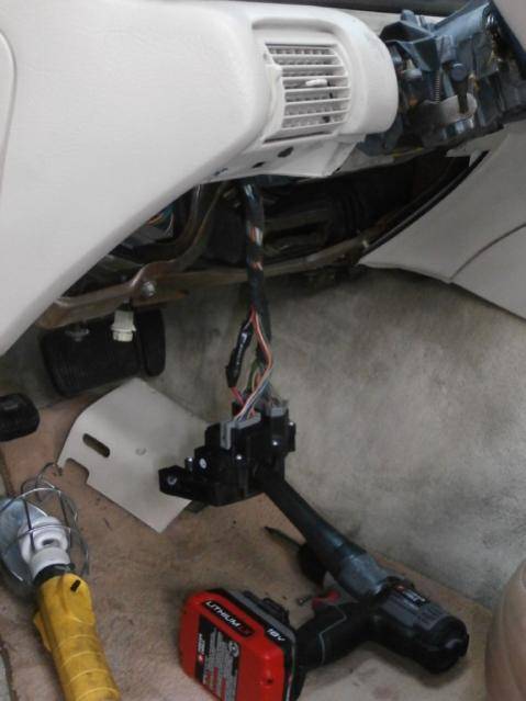

took off the steering column cover
spliced some wires
"Hello red/yellow, meet red/white. May you become one and never part ways."
I need to do that one of these days!
this is the second time I've done it. Easy peasy, pull the covers under the dash, pull the underside column cover, push in button to pull key cylinder, pull off upper cover, 2 torx for the mf sw, snip the r/w and r/y...put em all in a big butt (10-12) connector, done

It looks like you should be able to do that without dropping the column as long as you can find the wires....or am I wrong?
no dropping the column, just remove covers and mf switch, splice wires..key cyl must be removed to remove upper cover, that link is for the complete write up with photos
