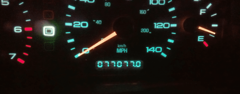

Just pulled over as I looked down and saw this on the dash at 5am this morning
Putting to many miles on it to fast.. :shifty:

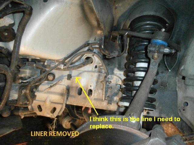

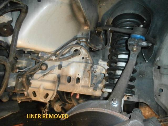

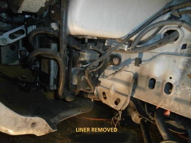

Getting to the lines isn't that bad. Remove the battery and tray, remove coolant bottle. Remove wheel and fender liner.
I'll get a pic of my 97 tomorrow since there's no engine , should give ya a good idea of what ya gotta do. I was actually glad to hear it was slammed, that leaky whatever in your air ride may be saving your life

I was checking that line out on my Brown car, the car from Mich...those metal ends of the short rubber seg are rusted severely....made my stomach hurt and ruined my whole day. I still have the liner peeled back and can get better close up pix tomorrow
