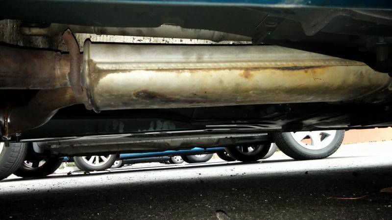

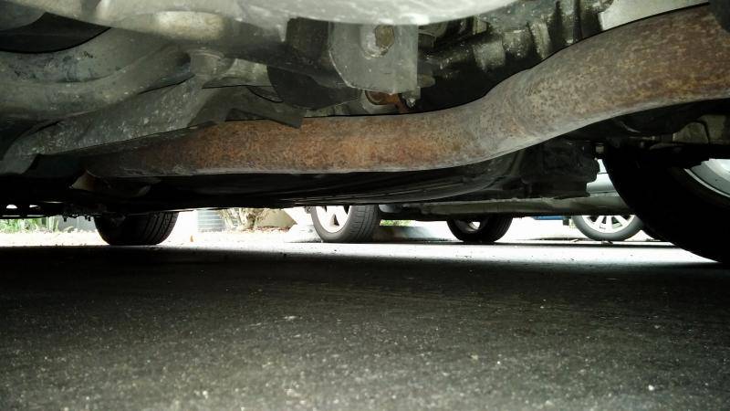

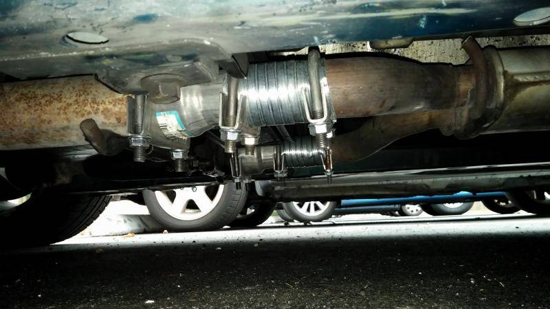

I'll try and go out in a few minutes and take some pictures but basically what I have is stock headers with both stock 1st and 2nd cat, goes down to where the 3rd cat was and I cut it out and unbolted and dropped from the flange. Took C clamps and attached a 2 1/2" to 2" reducer on both stock pipes where I made the cut. Then, I took and cut two ~3" piece of 2 1/4" flex pipe and attached those to the reducers with C clamps. Finally, I measured and cut the pipes from the section I found at the JY off an (I think) '88 Thunderbird. Attached the flange, pulled really hard toward the back of the car to get those piece of pipe into the flex pipe sections and C clamped those on.
The stock mufflers were cut off by the previous owner (not sure why, but they were cut off) so there are no mufflers on the back. HOWEVER, the piece of pipe we got at the JY from the Thunderbird was a Y into a pretty big muffler which ended at a flange which fit mine perfectly. I think that muffler that was on that section is producing a pretty nice sound, but I don't know very much about exhaust. I honestly thought I wasn't going to be able to complete the job as I went into it pretty much winging it and ended up with quite a bit more satisfaction then I expected.

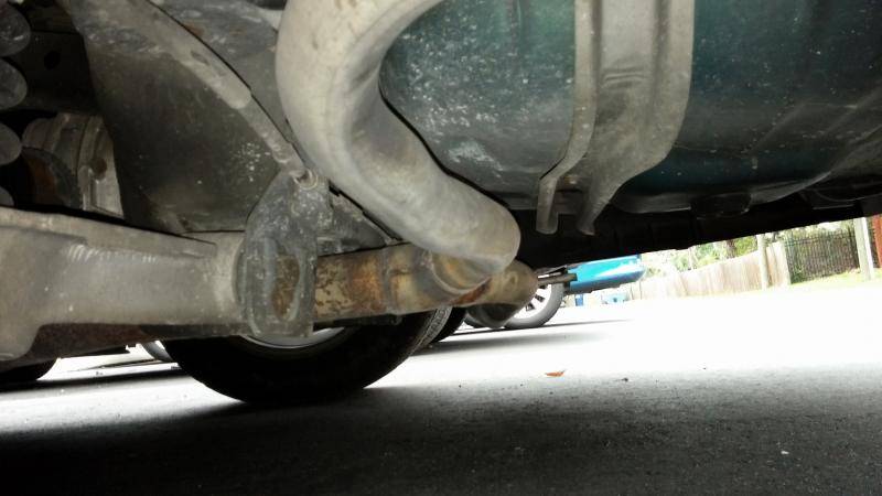

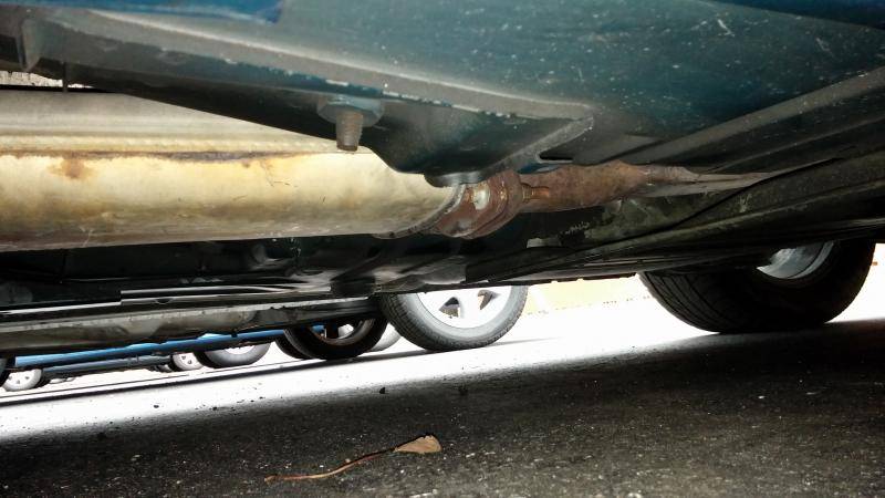

Here is the exhaust setup. As you can see from the last picture, it's just abruptly cut. I need to get something done there, I don't like how it just flows right under the trunk area. Either going to clamp some extensions to the end and put cheap tips or something like that until I can afford to get the whole exhaust done properly.

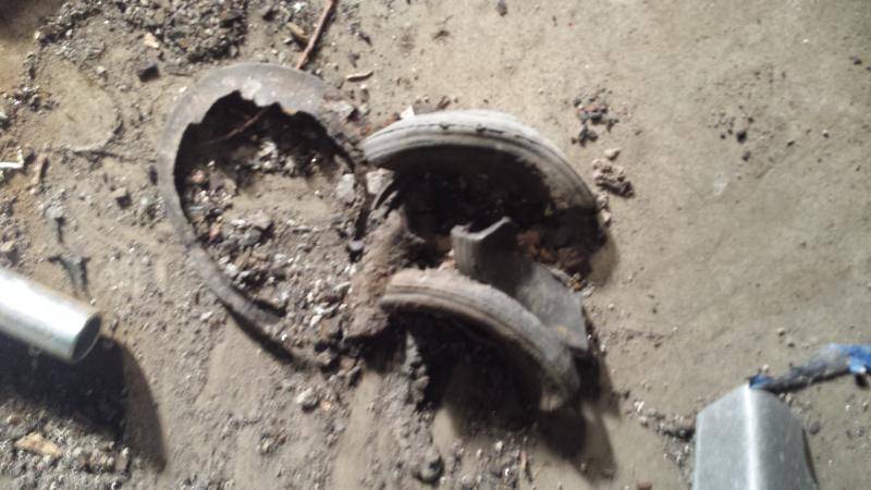

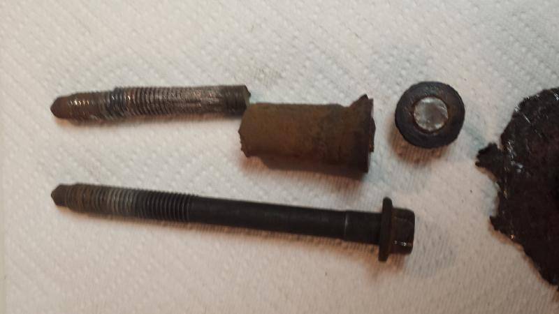

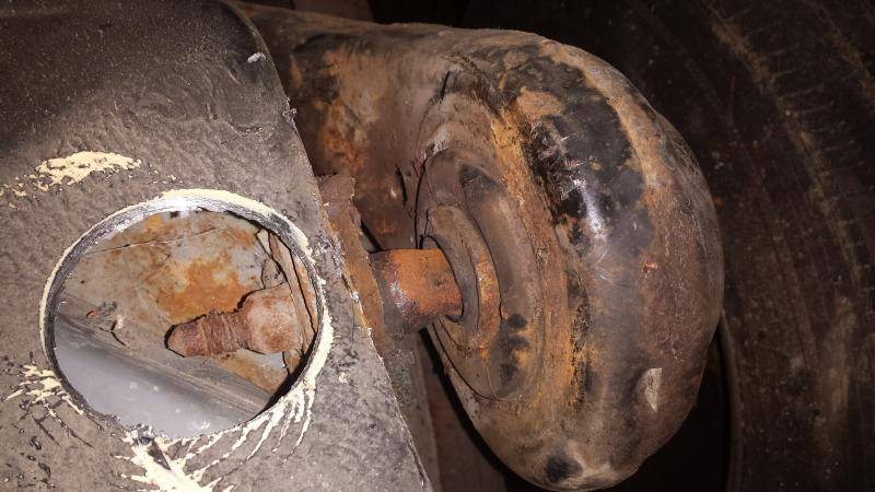

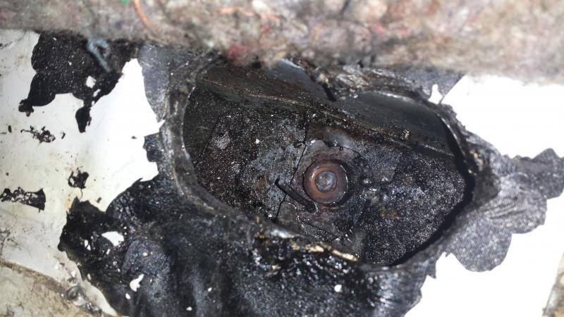

lots of sub-frame action. been an interesting couple of days...
^Needs a progress thread with lots of pictures^
Please! :D
Ouch and so glad even tho I live in a extreme Rust area none of my Marks have ever had that problem :(
I had to use a plasma cutter on a rust free gen II and cut those bolts out. Yours are probably stuck as well.
