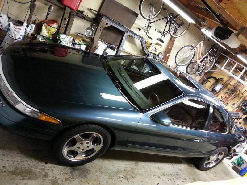

Oh, almost forgot, while going 70mph on the freeway in Tux, who is just HATING the cold, my boy decides he hates his air ride too....oh yeah.... I'm 10miles from my Drs appointment, do you know how long it takes to go 10 miles on the freeway with your hazards on 4" from the pavement...well it feels like an hour! I get to Dr's office get out look at him and the drivers side bags are EMPTY! Passenger side, trying to hold on, but wheels are in the wells too...
Go into apt., come back out...no, it wasn't a bad dream..still sucking pavement. I cycle him, nothing. Called AAA, they arrive in an hour, my boy played h e l l gettin on that flat bed...tow truck driver had to work hard to even find a way to get him hooked up he was so low. Then more fun gettin him down and backed into the garage. So now he is sitting half slumped over...in the garage....
how...how does this happen? How does one side go down? How do you have two Marks that run perfect, but ya cant drive em anywhere...HOW DOES THIS HAPPEN!
Last week, Thing 2 (Chris, I forget his LVC name) and i replaced the front drivers side solenoid cause Tux kept going down...but he would always recover... Tux's air ran solid for a week, not one check air, spyder valve would let perfectly, he'd let again right on time...until today.
I did order 4 new selenoids...they were sitting on the porch when me and the tow driver pulled up...but I dont think its the sel.
