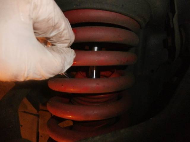

found the source of my creaking and squeaking front pass side...only 26k miles on this
