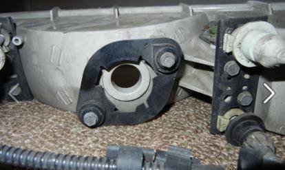

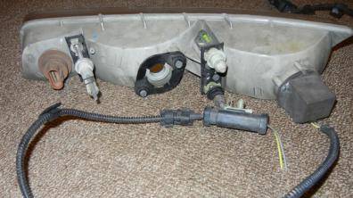

here's what I'm looking at, both sides the same, seller is not a Mark VIII owner, has never used these
those aren't adapter rings. Ford put those on there from the factory.
those look just like they did when Ford put them into the LSC in 1996.
only thing missing is the halogen high beam bulb.
you will need adapter rings for the low beams like with all HID Mark VIII lenses.

can those 96 factory ballasts wiring be spliced right into the base model low beam lines with no additional transformers or electrical converters needed?

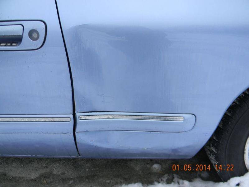

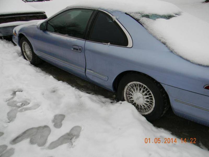

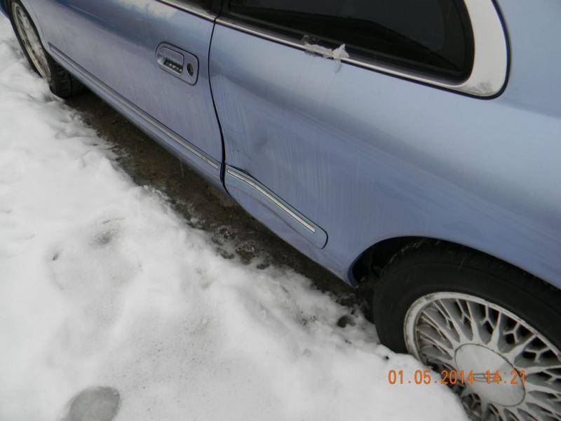

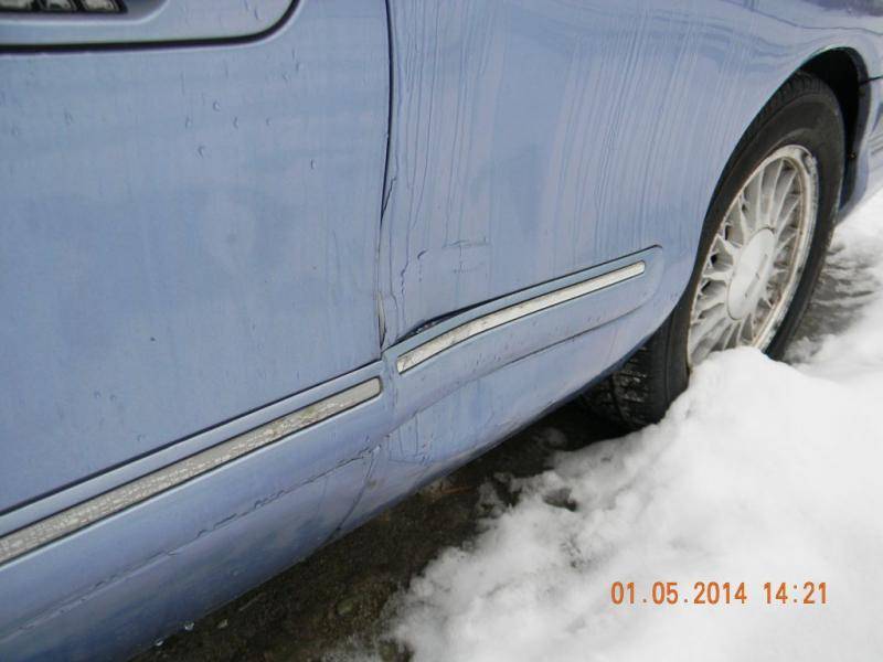

lol :) I have a 357 and he does have an xbox. No wait...that would just be wrong. Today were expecting another foot of snow but I'm going to still try to get some pics of it up so I can get everyone's opinion (good or bad) on the damage.
I've been fixing car's all my life but never attempted or even played with body work before. Some of you Mark VIII owners are artist when it comes to stuff like that.
What do you think, worth fixing???

Man, the way you described it I thought it was way worse. It looks like a good suction cup or heat gun and upside down can of compressed air could pull most of that dent out. Its definitely a keeper!
I'll assume It looks worse in person than in pics, I know my car did.

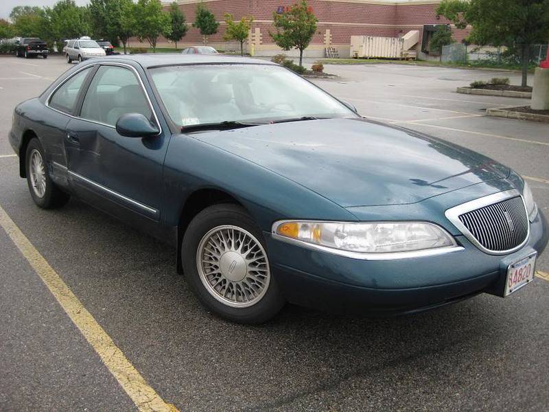

Hell when I bought my Lincoln it looked like this. My wife is friends with the body shop owner, and does custom airbrushing for them so I can't give you any estimate on what it might cost in the real world:cool: But it didn't take very long to do once he got around to it.
it can driven like that, right? my guess is 1k to repair to LN cond
I haven't drove it yet but the door still opens/closes good.
It looks worse then that in person. Below the trim looks like bondo from previous accident fix. Nicked the door too right at trim level. You can't see that in the pics. I hope your right about the keeper, not ready to let this car go yet! What is the compressed air method you speak of?

Spree, I'd take the interior panel off and try to pop it out as much as you can. Since you were going to do paint this summer anyhow it wouldn't hurt to try.
Spree: Try a pneumatic dent puller. They are near magical for a nice fat pock like that. At the very least, pull out as much as you can and let a body shop get the rest perfect. It would shave off a lot of cash, and you get to keep the fun toy. You can get them cheap at Harbor Freight tools. I love mine. It's too much fun. I got it for my birthday a few years ago. First thing I did to test it out was found a friend with a beat up work truck.... but she told me to stop after a while so it didn't get so nice she would feel like she'd have to be careful out in the bush. I only wish I could find smaller suction cups for it.
http://www.harborfreight.com/pneumatic-dent-puller-69718.html

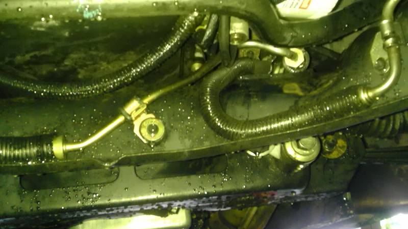

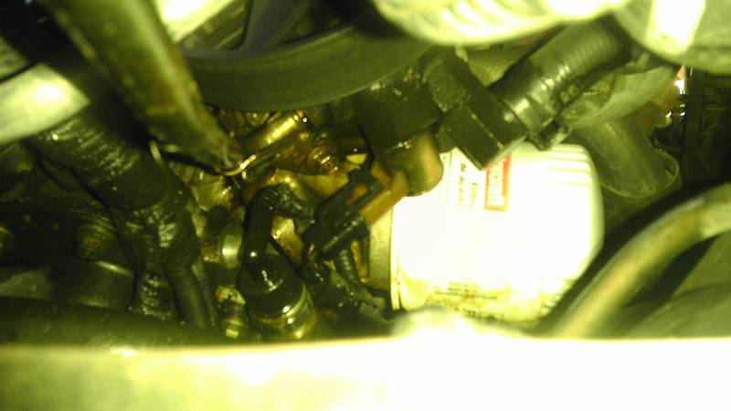

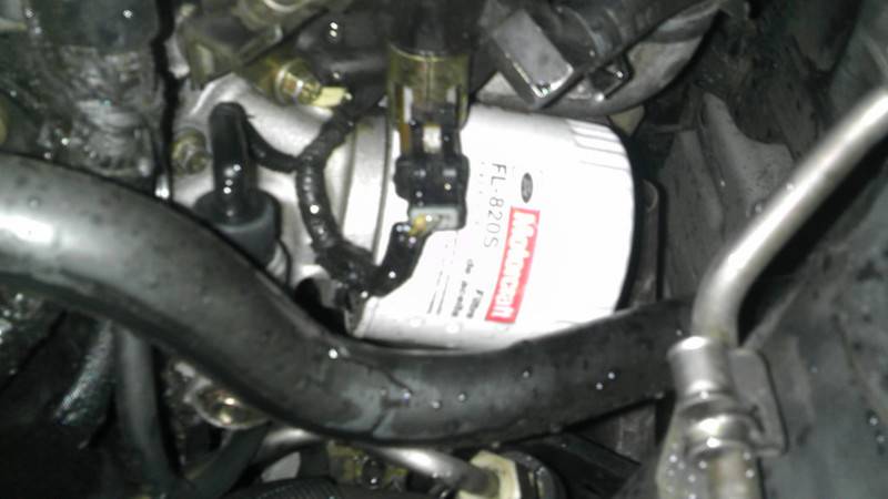

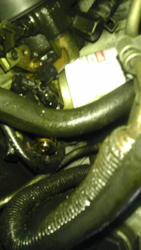

Since owning the car, it has leaking a quarter sized drop of oil overnight, but in the last month it was dumping so much oil that it was burning on the exhaust and I named her the Exxon Valdez.
What a miserable job, but luckily others posted some tips and tricks (I wouldn't have thought of removing the inner fender) and it was a 3 hour job including cleaning up and changing filter and oil and dealing with the coolant. Burping the cooling system was also more of an ordeal that I am used to on the 4.6.
I did first check the oil sender, it was fine. I have 250,000 miles on my 2000 Grand Marquis and it doesn't/hasn't leaked like this, nor did my 97 Cougar, so not sure what is special about the Mark VIII/DOHC that make it flatten out that spacer with gaskets on both sides. The Coolant part still had a bump, but the oil passages were completely flat.

Spee, fix it there is no other option. As said before, you were doing paint anyway so it is a no brainer. I had one of those dents in my 1972 Capri when I was 17. I took the rear interior panel out and took my time and got the dent out gently. Take your time and you will fine it will move for you. use something to spread the dented area like a block of wood that you can hit and stay away from the metal until you get it as far as you can and then just some more time with a BODY hammer. Do not use anything too heavy hammer wise when you are in direct contact with the metal.
Watch You Tube videos, anything to get familiar with what you are going to do. You do a lot with this car and you have learned over the years how to do it this is just something new to learn. This is a fairly easy fix to get it back into shape even if you leave the bondo skim to a pro you can get it there for them and save yourself a great deal of money.

Thank's everyone for the comments on the dent. It makes me feel better there are no negative ones and no one sees this as a major fix.
I will do as suggested and remove interior panel/speakers and see how much I can take out myself. I know there isn't much room in between the two walls. I like the tool Dreamie posted and will have to add this to my tool collection.
Unfortunately this will have to wait till warmer weather. Thanks again for the comments!
