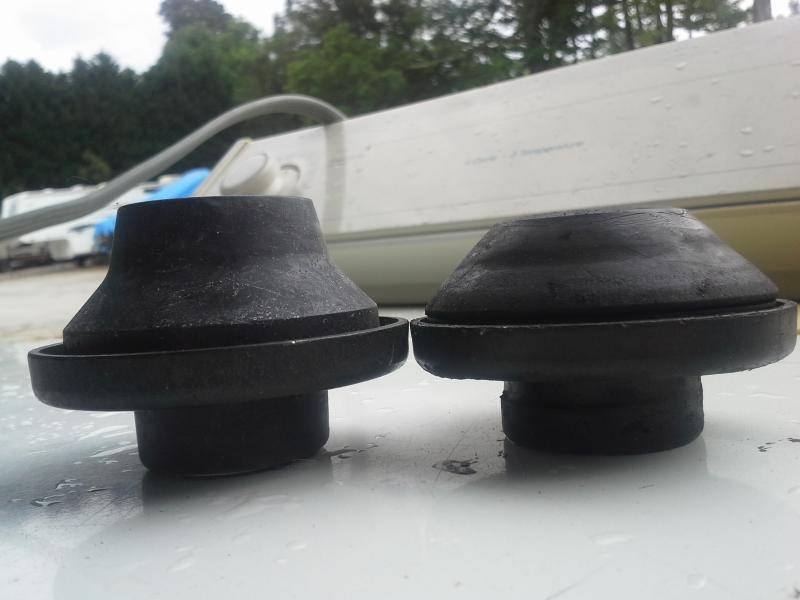

spent most of Sat reinstalling Fwd SRB's and chasing down/eliminating squeaks; the red sway bar bushings were the prime culprit. Greased em like crazy, quiet now. There's still something squeaking up around the RH shock tower. possibly uca, but even with the 2 body nuts removed it still squeaks there.WTF???

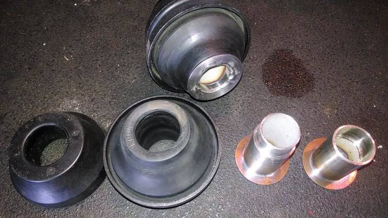

and, the Moog "Problem Maker" exposed, 9 months and 10k miles of use
through process of elimination, it turns out the UCA wasn't making noise. I replaced it with one from O'reilly's. The noise maker is that *^%#ing used tokico shock. It makes a plastic sort of scrape noise when the suspension is rebounded. Maybe it will disappear when it's on the ground, or maybe I'll buy new shocks. Buying used suspension? Biggest mistake EVAH
I wonder what causes that noise? I put pressure on that outer plastic sleeve, but couldn't eliminate the scrape/grind. It's just on one side. The good news is I got rid of the squeaking sway bar bushings
All reassembled, aligned and 99% noise free front end

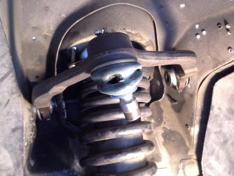

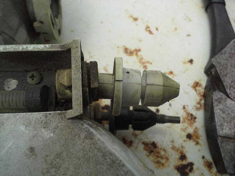

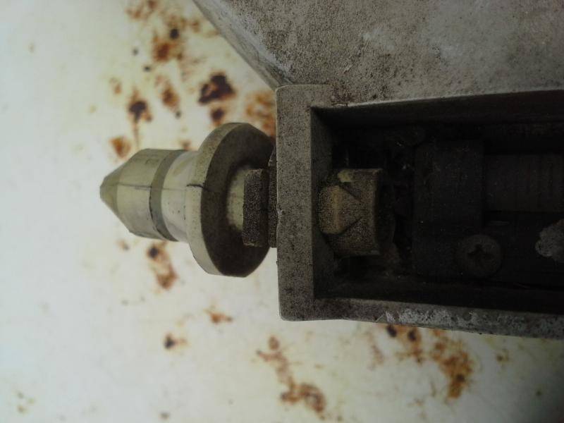

anybody know if the white plastic (upper/fixed) retaining stud on the headlight bucket can be removed and reused on a different housing?
looks like this
btw, here's my new v. old fwd SRB's
any special secret? I turned on it a wee bit, then backed off before snapping it
Spray lube it first. The bottom 'bow tie" can be wedged up so to clear ramps. I use two little screwdrivers, then turn it I think clockwise. When it's in the proper place, wiggle it to remove. To install, lube it , then it'll pop right in. If you put it in the car, and over-adjust the headlights, it will break off and go for a flight. Put that clip on after you get the lights adjusted. I'm in need of 3 of those fragile things. Without them the light will vibrate. Good luck TONYyyy
