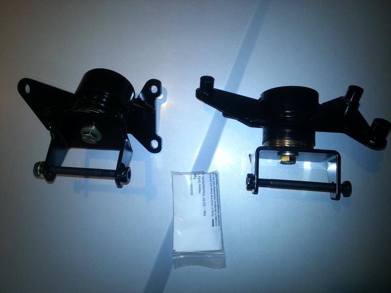

Damn Motor mounts. So the ground wire on my Gen II was "stuck" onto the bolt that holds the motor, had to splice that wire cause I couldn't turn the bolt. It's a PITA because of that. On the Gen I, it was easy. Hope yours goes smoothly like my Gen I.
Mine was stuck on my Gen 1 as well. We ended up breaking it and using another ground strap to the front of the engine area instead.
I'd never done motor mounts on one of these and my 30+ year mechanic had never done them either. We didn't know the mounts were universal to both sides so you're suppose to cut off that guide pin for the passenger side. Spent hours, going into 8pm, couldn't get it to drop into place. We were both so pissed off, already had the K-Member back up and ready to go but the mount didn't fall into place like we expected it to. Went home, jumped on Facebook, found out about the guide pin from one of the guys. Went back to help him the next day, cut the guide pin, what do you know? Falls right into place lol.
These are turbo Chuck mounts so I dont think there are any tabs to cut off. The bolts have been soaking in penetrating fluid every night.
i broke that strap too.
car has other grounding straps to the engine that i had added so i wasn't really worried about it.

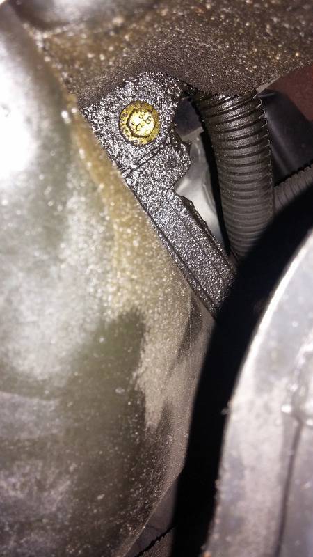

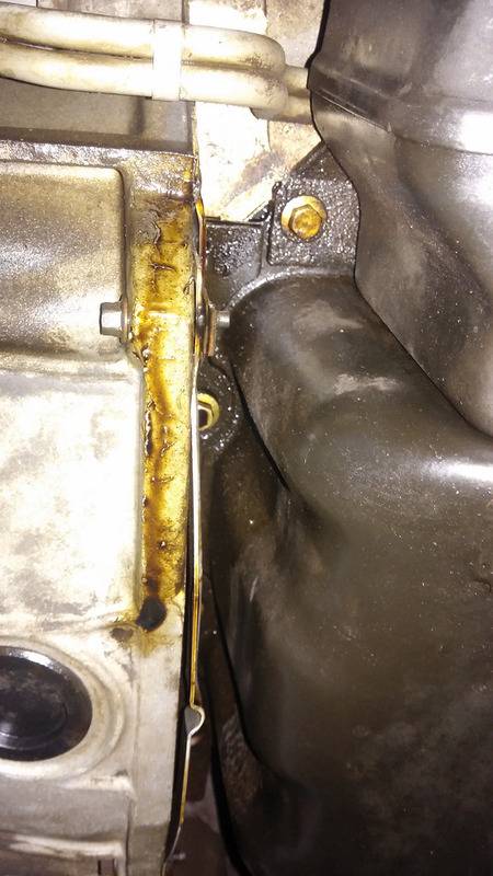

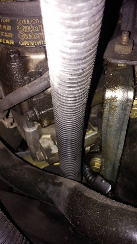

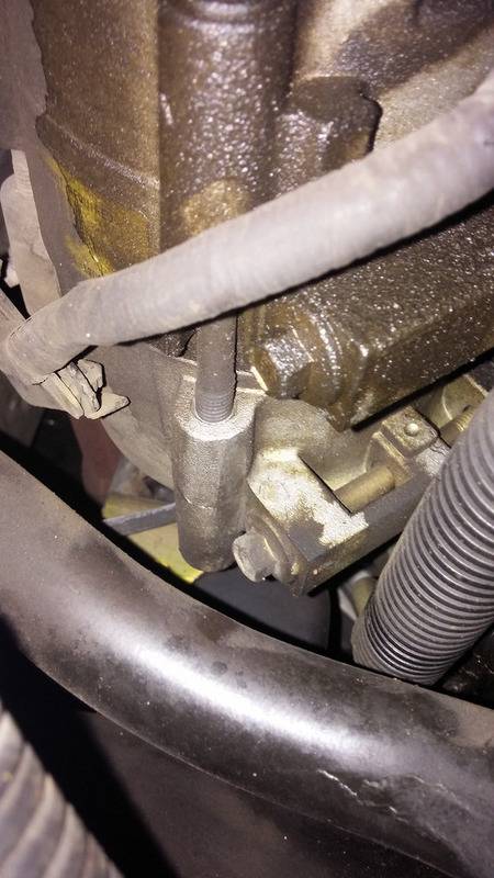

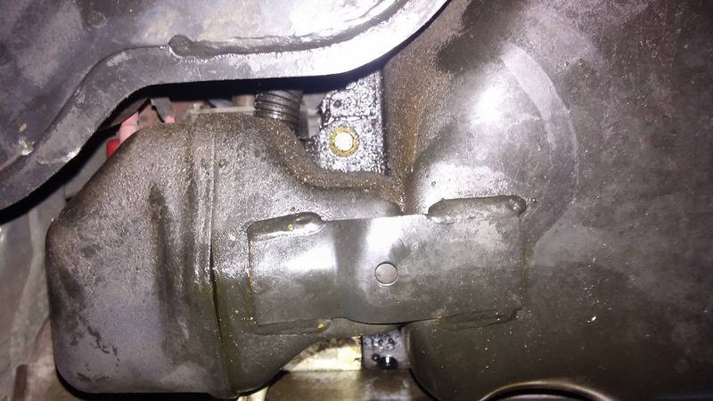

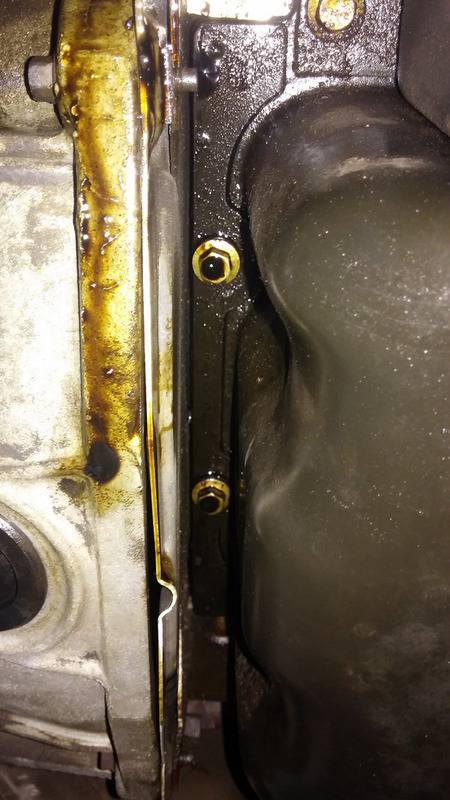

Crawled under to do an overdue oil change. I have been getting a spot under the car inconsistently for awhile.

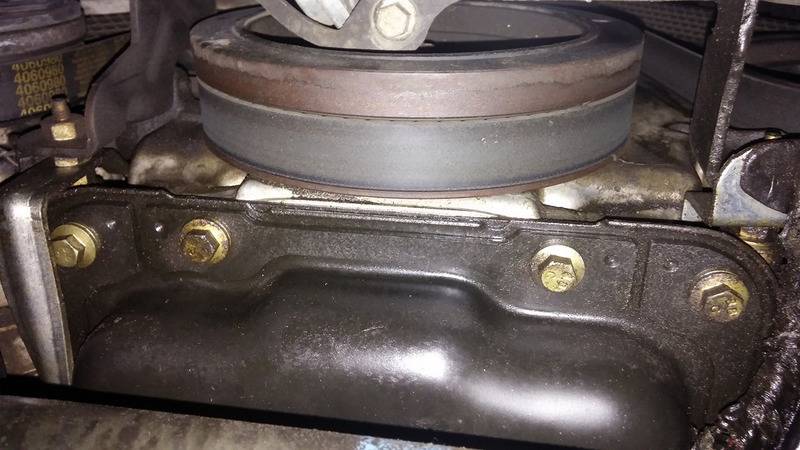

I figured it was something on the drivers side (I have replaced the oil filter adapter gasket, oil pressure sender, and a couple of oil filters). But that side is pretty clean (a little weeping from power steering). Looks like it is the passenger side oil pan or higher.

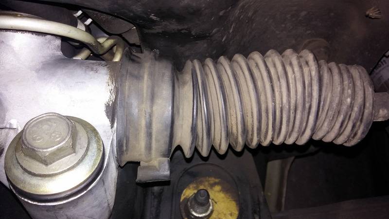

Supposed to be clamps holding these on to the rack?
I figured this would be a giant mess like last time:
Warning, ghettoness ahead...
Bangster- I fabbed up a drip pan that attaches to the bottom of my pan via magnets to catch the little drops coming from the rear part of it. It doesn't really accumulate between oil changes but it does keep most of the spots off my driveway. I'll be damned if I spend money to r&r something like that @ this mileage over a little leak. My old caprice was a leak master, I wasted far to much money chasing oil leaks on that car. From here on out, If it's just an annoying drip here and there it won't get fixed.
Fwiw, the pan has stayed put on a lowered m8 that's plows snow 4 months out of the year. ;)

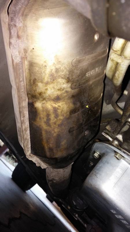

It is a bit messy, and the passenger cat gets enough oil to burn it off if I drive for an extended period of time. I have a drip pan in my carport (my 2000 Grand Marquis leaks transmission fluid from the front pump), I will snug bolts on the oil pan as the block is not oily at all so not coming from above, and it is wicking up the AC compressor (it might be leaking a little as well), but yeah, to replace the oil pan gasket (or the front pump gasket on a 26x,xxx Grand Marquis) is not something I am going to do.

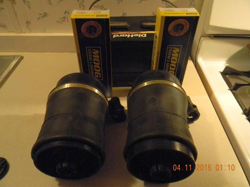

Rear air springs are here, rear stabilizer bar links are here, battery is charged...nice!. It looks like it's going to be a FUN Sunday, if the weather holds out.

I have a question? Once you get the old springs out. The new springs are going to be shorter (until they get there first breath of air). You twist the top in but how do you get the bottom to clip in?
Make sure the bottom is lined up, and when it airs up, it'll pop into place.

Ha, those pics could have been take of my MK VIII! Same leak, & so far same fix - NONE. Mine is not enough to justify changing the pan gasket yet. Just enough to make an annoying mess. Hardly any oil qty drop between changes.

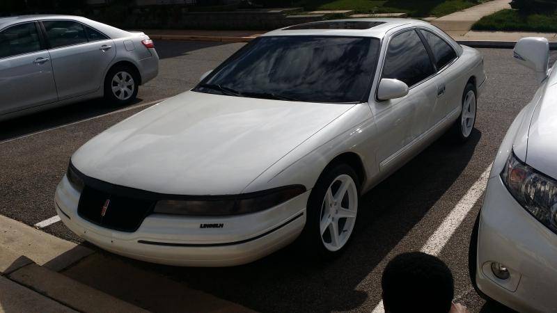

20150419_085552-1.jpg20150418_070052.jpg20150418_070152.jpgWent plastidip crazy, 20150416_163910.jpgPlasti dip perlized wheels and plastidip smoke headlights plastidip grill and tail light. Pearl saleens
