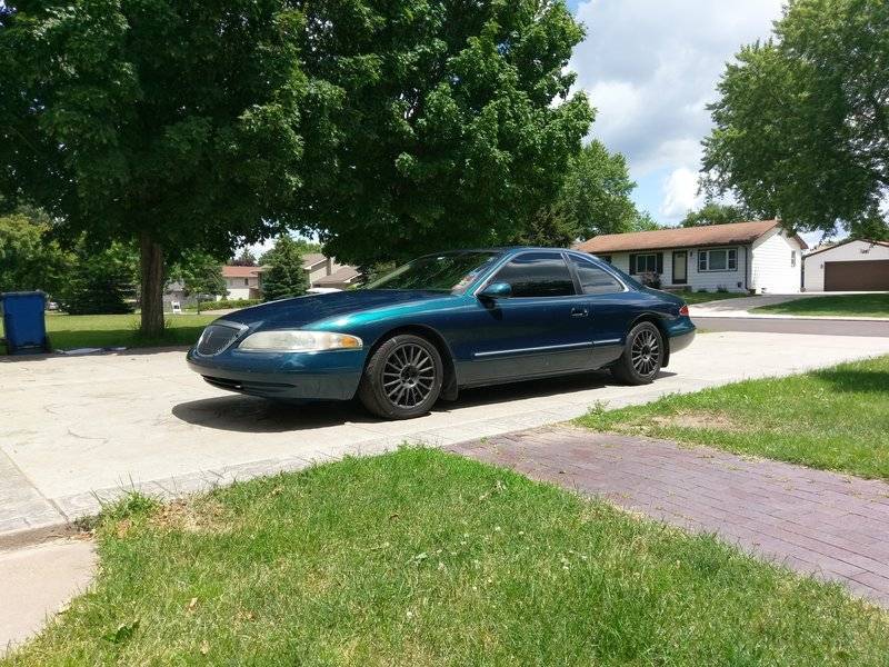

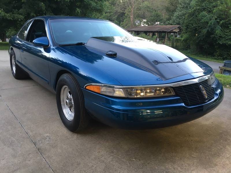

What size are those germanshepard? I have a pretty nice parts car the same color as yours man, kinda of a shame to part this thing out. I think it had transmission trouble and the owner sold it to the junkyard. I now work for the guy and will try to buy the whole car
They are 255/50-16s.
How much for that car? Maybe we could both rob it of parts? Let me know I'd be interested in doing something with it. I could use a spare ballast if that one works.

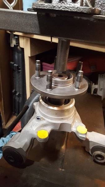

I have two Mark VIII's now. Going to do some fun things with Dad's Mark VIII. Bought a set set of cougar wheels, 17 in, on the cheap from a kid in Mooresvile, NC. So have been researching how to redrill the rear hubs/rotors. Sounds like I can replace the front hubs with mustang hubs. I would be broke if it were not for RockAuto!

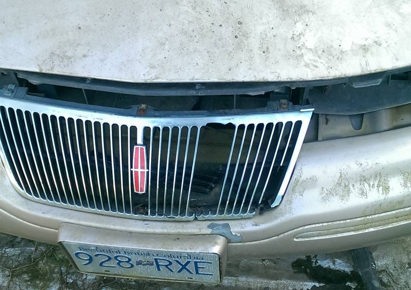

Smashed my grill with my quad. My 6" Alien is a beast and I'm old and slow;

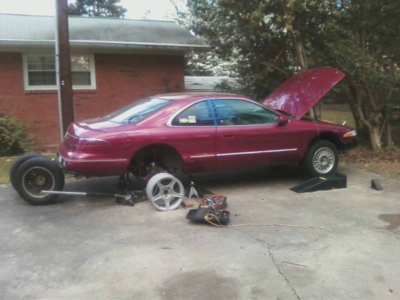

Had rear rotors from my 93 cut and installed with new pads onto my 1994. Installed new front Mevotech sway bar links from my fav company, Rock Auto wednesday and yesterday. Threw the old links in the fire and will use them as door handles...ha ha! The 94 is running sweet...road trip to Columbia MO and KC next tuesday! Any body out there in TN, KY, MO have a drill press to help me with a redrill of rear rotors/hubs to a 4.5 bolt pattern? :D Thanks!

Today I just recieved the last of my brake parts and got some cinder blocks to prop up the 97 LSC for parts removal. Tomorrow though.... man tomorrow and the two days after will be non-stop work on two Marks. :(
For your safety I hope its a joke about using cinder blocks. Jack stands and raised floor jack as a back up tight against some part of the strong member of the mark in case it slips the stands
