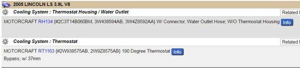

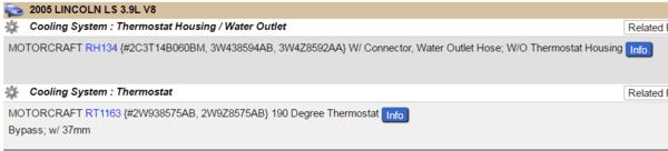

If you want to replace the aftermarket housing and thermostat with OEM these are the parts pulled from Rockauto.
1. Thermostat Housing = MOTORCRAFT RH134 {#2C3T14B060BM, 3W438594AB, 3W4Z8592AA} W/ Connector, Water Outlet Hose; W/O Thermostat Housing
2. Thermostat = MOTORCRAFT RT1163 {#2W938575AB, 2W9Z8575AB} 190 Degree Thermostat Info Bypass; w/ 37mm
3. Seal installed on outlet pipe = MOTORCRAFT RTS1079 {#2W9Z8590AB}
