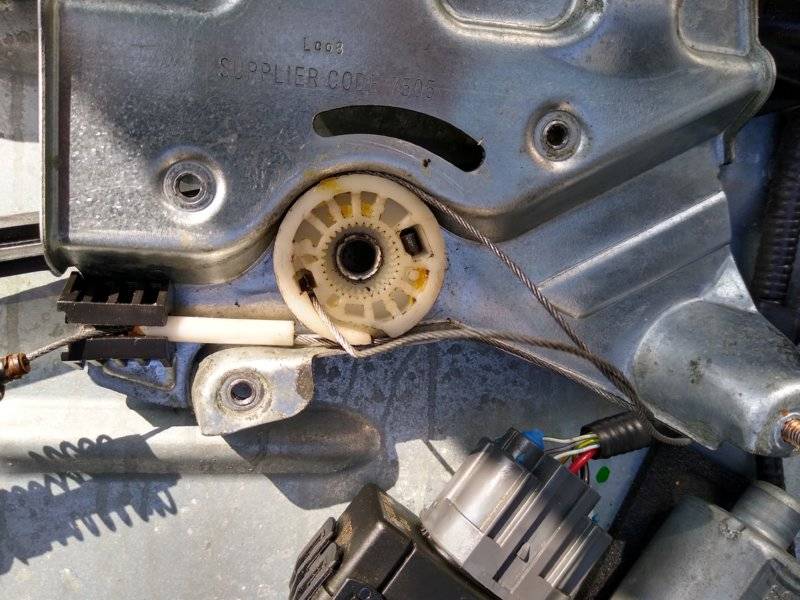

So last night I'm rolling my window up and down and admiring my handywork. How smooth and quiet it is and then cracking noises followed by a window that is stuck half opened. Today I find that the cable has come off the track. This is the mess I found.
The motor has been removed and you can see the cable is kinked and it is also frayed in another spot as well. First piece of advice I am going to give is if your window stops functioning correctly do not keep trying to roll it up and down. All you do is make a mess of the cable and unwind it. I got it rewound and back together but it didn't have enough tension to keep it from winding wrong and coming apart again so I added another spring where you see the cable coming in on the left. All put together again. If it fails I am just going to order up a whole new regulator assembly.
It will, and you will be. After the first time it comes off the reel, too much damage is done.

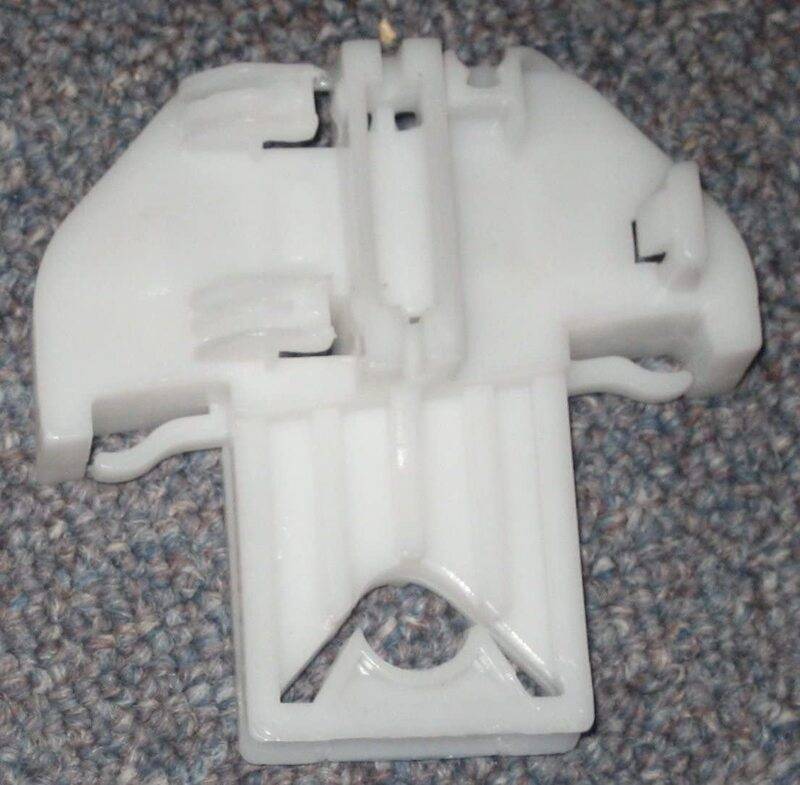

What could cause the window to go up fine 100% of the time but only get pulled down correctly 5%? I'm thinking it's because the glass rests on the clip when it's all the way down but it isn't connected to the clip so it can't get pulled down - sorta like I can push up a shade with my open hand but can't pull it down if I can't grab onto it. That makes sense. But why would it sometimes get pulled down? Maybe since it was 100+ degrees yesterday the heat caused the clip to slightly swell enough to grab the glass. I dunno.

The plastic clip shown, has two slots that the cable passes through. Between those two slots in a metal slug on the cable. This slug is what keeps the plastic clip moving with the cable. If the lower slot is broken off, then the cable (and slug) can move down without dragging the window with it. If the upper slot is still good, then it will still catch the slug every time the cable moves back up. Of coarse, there could be other failure modes with similar results.
Yes, the front glass is bigger, so there are two slides and two cables and two clips. The rear regulators are single slide and single clip. I can't remember for certain, but I think that the glass just clamps in, so it could be that the clamp just needs to be reapplied and tightened. (I have worked on regulators that clamp on to the glass, and on some that rivet to the glass. Between Ford, Jaguar, and BMW, I can't remember clearly which is which...)
