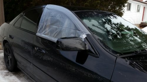

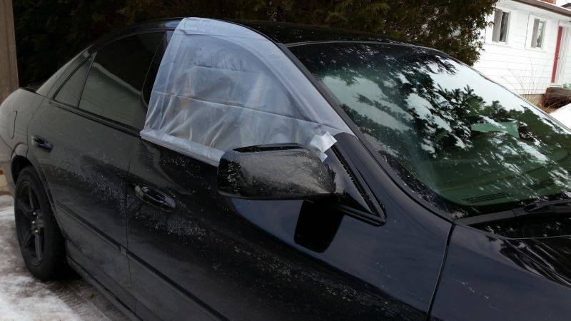

Looks like it's my turn for this. Used the auto up function for my passenger front window and heard a cracking sound and it sounded like a small piece of plastic broke and fell down inside the door. I can hear it move around inside the bottom of the door if I repeatedly swing it back and forth. The window still rolls up and down fine but I hear a slight clunk noise when doing so.
