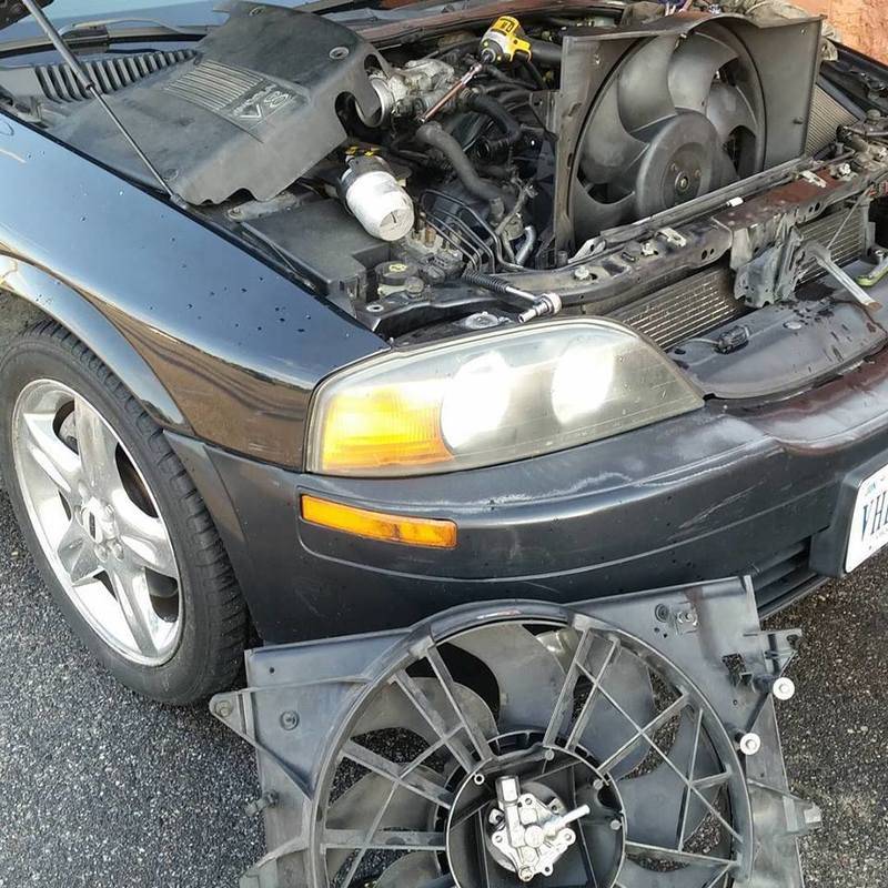

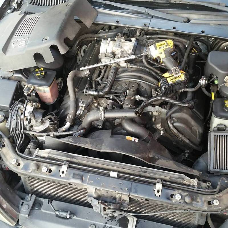

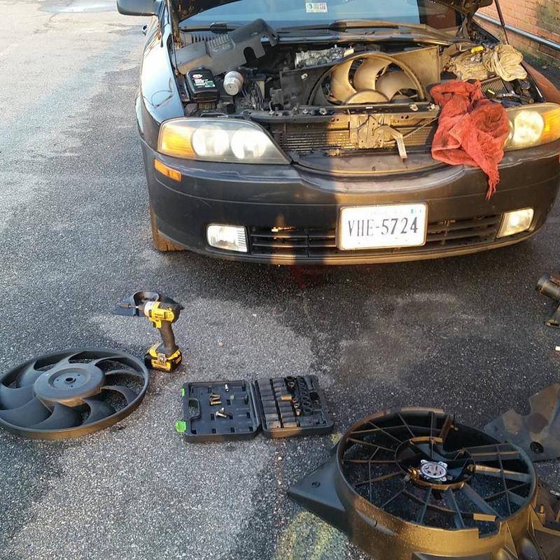

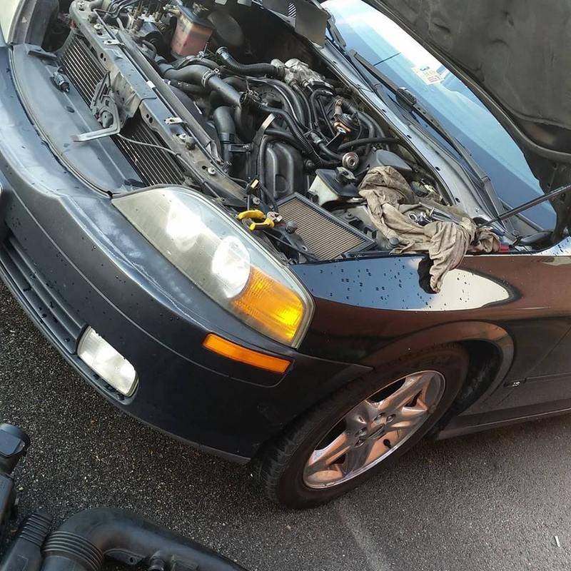

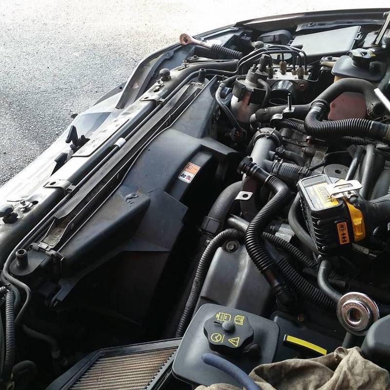

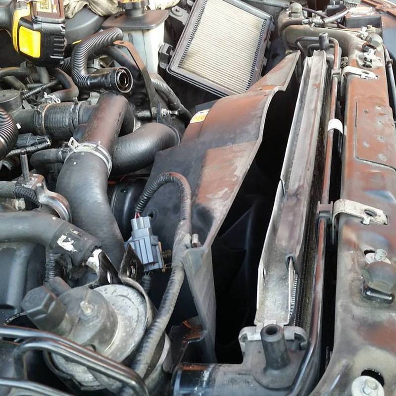

Alright, So I tackled the job of removing and installing the new fan. All went well.
However... the new fan doesn't turn, at all. Did I miss something? How do I prime the pump? All of the fluid didn't come out of the RES. Most of the fluid came out because I intentionally let the "PINK" gooey fluid out to make room for the new fluid. I did leave JUST ENOUGH for the fan and hose to have enough not to need a prime.
HOWEVER, how do I prime the pump? Did I miss a step? Do I need to do something else?
I started the car, turned on the ac, held the gas pedal and it didnt move one inch. I even tried the "push-to-start" method and got nothing.
Help?
