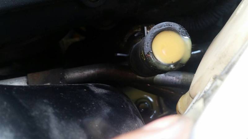

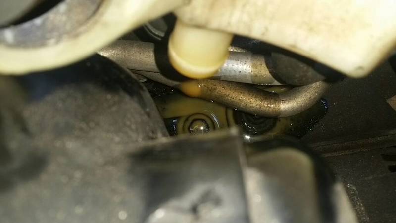

So... I ran into these issues today ... removing the actuator on my car...
1. This liquid. I was told it's a mix of oil and coolant. I don't have smoke or milky oil.
2. It smells and has a bit of hydraulic fluid in it.
3. Upon spinning the fan, the fluid came back out of the pump itself.

The raplacement actuator Head connector is from a v6. So now I know that the actuators are the same. I now have 3 of them, 2 from v8s and 1 v6. They all had the correct fluid coming out of the pump, reservoir, and actuator. So I assume those worked fine.
5. I removed a fan from another car. I left the motor on the fan. I'll be back tomorrow to get it.
6. Sigh. I know it wasn't an electrical problem because I swapped out the removed part with the others and had the same issue.
7. My needle actually dropped below the operating temperature of the car a few times. What could that mean? I read it somewhere but now I can't find that post anywhere! !
A little help please?
Looks like someone (before you, I assume) topped off the fan reservoir with water or coolant. Maybe one of those quick change places...
That's exactly what I was thinking. I figured someone did something completely wrong.

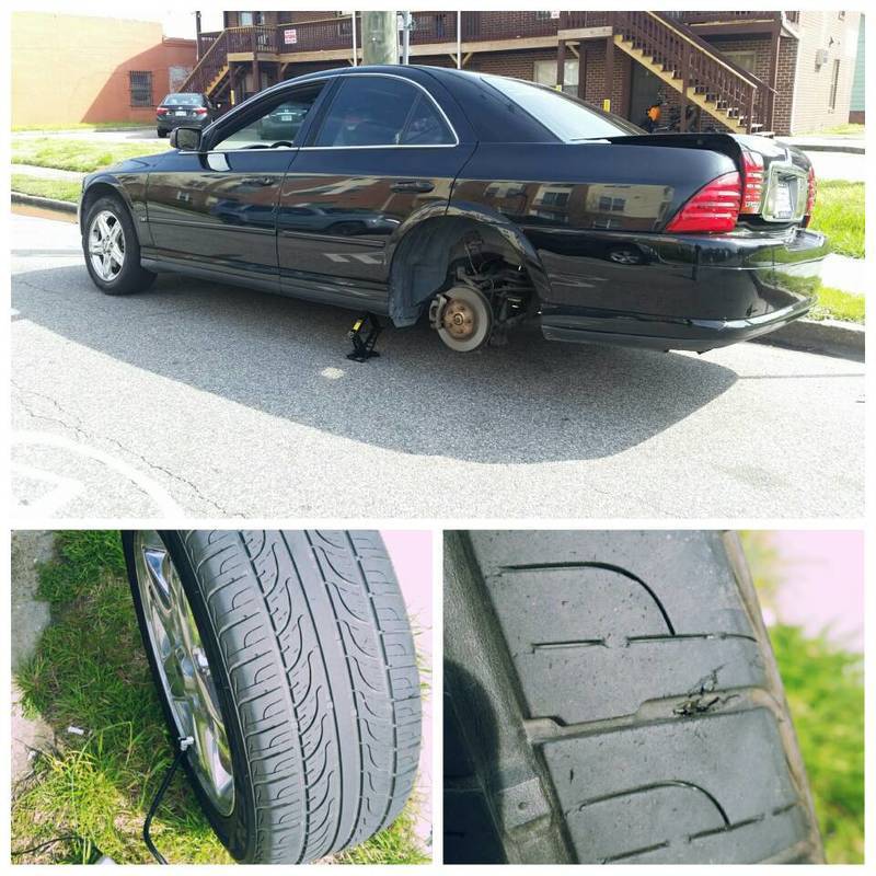

Went to the yard, forgot a tool... drove back home caught a flat, now I'm assed out
Has to be fixed with a plug,KidL. Take it to a reputable tire dealer and get it plugged until you can afford to replace it. don-ohio :)^)
They shouldn't charge much for a plug,KidL.............you already have it removed. Get someone to run you to the tire store. don-ohio :)^)
Empty.... pockets lol...
If I could I would tho. Guess ill just sit here and miss the half off yard sale
Well,you can plug it yourself with a SLIME or other brand plug kit from Wally world. Not as dependable as a tire shop, but follow directions and get the air back in it and it might hold. You might have to put in 2 or more plugs if hole is too big. don-ohio :)^)
Sam's Club does free tire patching, if you are a member.
