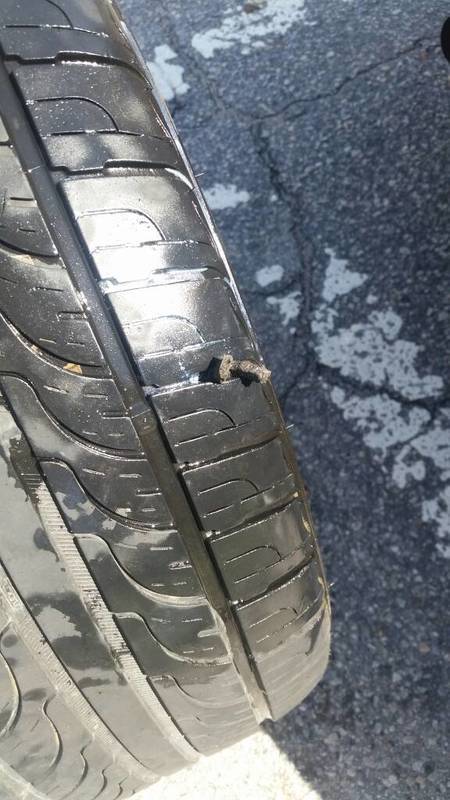

That hole is within an inch of the sidewall. A reputable tire shop won't plug that, they're going to say they are only allowed to replace. The reason is there's too much flex that close to the edge of the tire.
However, the car should have a donut. Not pretty, not advisable on the Atlanta bypass loops, but should keep you going until payday.

Probably true in most cases,yet some would apply a plug if you designate you're gonna plug it anyway. The 2 main tire shops in my town would do it.

Got it plugged. If it comes out I can just take it back and have another tire put on.

It should be fine. Good plugs have mushroom heads and use vulcanizing glue to prevent the old tales of plugs falling out. At least, that's what I gathered when my dad started flipping out when I casually mentioned I got a plug for my LS not too long ago. To be honest, I forgot it was even there until seeing your post. I don't even know which wheel it is.

Lol. Well I hope it stays in. I only question it given its proximity to the sidewall. Other than that, plugs aren't a new sight.

Cuz it won't last ... mark my words! It'll be flat by next week again. Most likely on your way to work on the highway as Murphy would have it. Plugs are for nail/screw holes not tears like that metal you ran over. Potentially the structural belt by the edge got punctured making this attempt of a repair a highly dangerous one.
It's also the wrong (older fashioned) plug and it should have been backed with a patch from the inside if you wanted this to last.
You need a new tire, similar to how you really need to replace all your plastic cooling system parts with brand new OEM stuff.
This plugging tires and loosening degas bottle caps ... aren't real fixes! Like putting 3M duct tape around a radiator hose, it won't last.

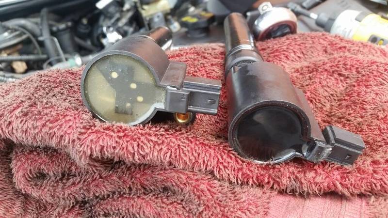

The tops of the OEM coils are epoxy. There is no "black plastic cap" to come off. The same is true for aftermarket. Then non-black coil has a non-black epoxy potting compound. The other coil is missing the Ford part number stamped on the top of the epoxy.
Neither are OEM.
They are not coil packs. They are COPs.
COP = Coil On PLug - a single coil that connects more or less directly to the spark plug (no plug wire)
Coil Pack = package of two or three coils, each coil fires two plugs. Plug wires are used to connect to the plugs.
Neither are OEM.

On that tire, no spirited driving. Just A to B it as little as possible until you can get it replaced.

And, they're VERY picky around here about calling the coils COPs. I don't know why this is so important to the folks here, but it is even though we all know they're just coils.
call me crazy, but I just like to refer to things as what they really are not as something that is similar but also very different...
no body minds the COPs being called coils, most of us just dont like the coils being called coil packs.
most of the time, when somebody calls a coil a coil pack, the correction is there not to be mean, but there to educate the person so that they know the difference going forward. the last thing you want is somebody having to go and talk to a mechanic and then they get got because the mechanic knew they had no ideal what they were talking about and took advantage of the situation.
