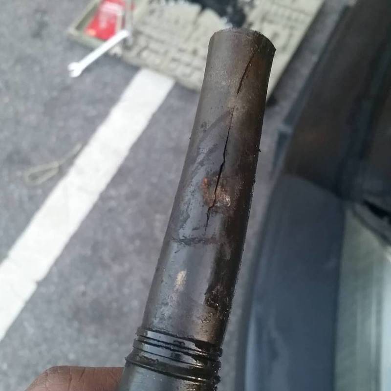

Realized My Aluminum coolant line has a hairline crack in it.<br />
Had it explode twice : ).. yay right?<br />

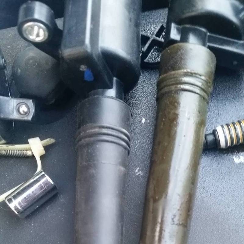

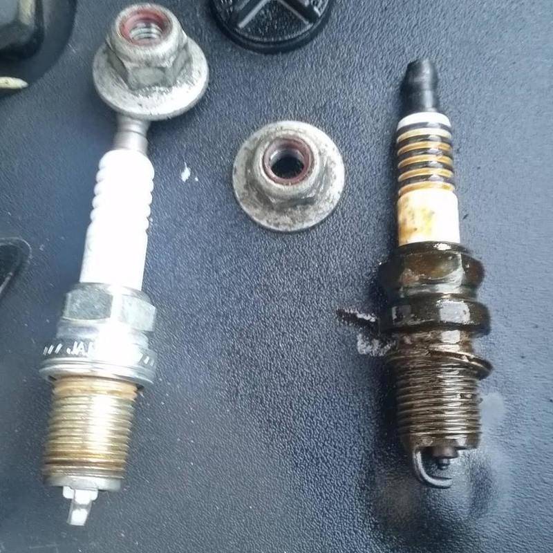

A few weeks ago I replaced my Toasted Spark plugs.
After getting the Cylinder 6 and Cylinder 8 misfire codes, I decided to change the coils and Plugs.
Cylinder 6
Cylinder 8
Which leads me to believe that my Cat is toast and could be bad. I have a weird sound when I accelerate. It's like a pegging or sputtering sound.
