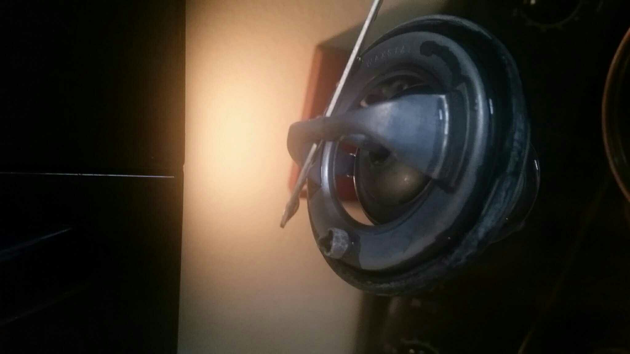

You could just remove the thermostat (till you find your problem) and be 100% certain that it is not your problem.
Isnt the therm there to help with regulating water? Or am I mistaken? Is that the water pump?
Like Joe says,you CAN remove it..............but I'd just do the same test with it.I helped a guy once that had put one in BACKWARDS on a 62 Galaxie.......LOL! Talk about overheating! That thing was hotter than a nuclear explosion! LOL! don-ohio (:^)
In a correctly working cooling system, the thermostat allows the engine to reach full operating temperature. If your system were working, removing the thermostat would result in your engine never warming all the way up. As it is, I predict that removing the thermostat will not change your problem at all. You will just know (as several of us already do) that your thermostat is not your problem.
Holy crap. I think I'm just gonna go snatched it off the car in a few. I hate removing these effing hoses. Ugh
Yep,it's likely not the thermostat Joe...but he has to eliminate it as a cause, just like eliminating the fan, which he says works fine.
I'm a little gun shy of thermostats since 2 of the last 3 I bought were bad. Maybe a `bee in my bonnet' so to speak.
So you think he's pulling that much air in.....that he can't even bleed it once and get it to run for a while? That's a really bad inleakage there. don-ohio (:^)
What actually would that do by removing the therm and running the car? Would i destroy something? Would it worsen? Would it be better?

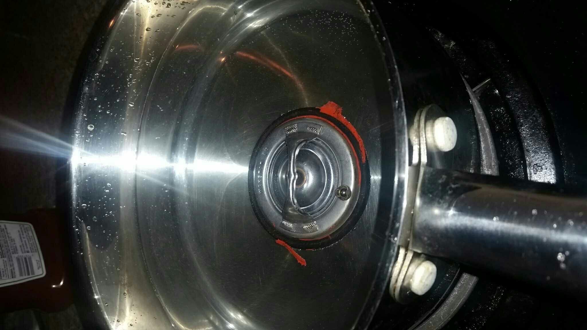

You apparently had some big air pockets it drained into. Well,you gonna pull that thermostat and check it? don-ohio (:^)
Well,well.......another working thermostat. If it's mine, and I see NO leaks, I am gonna go with,when engine is cool, draining out any weak antifreeze solution and putting in FULL STRENGTH solution to mix with the weak (this is KEY) and doing the bleed procedure by the book.

That's what I'm hoping too... How do I check the water pump? I head to the dealer tomorrow morning to get it flushed and refilled by the dealer
