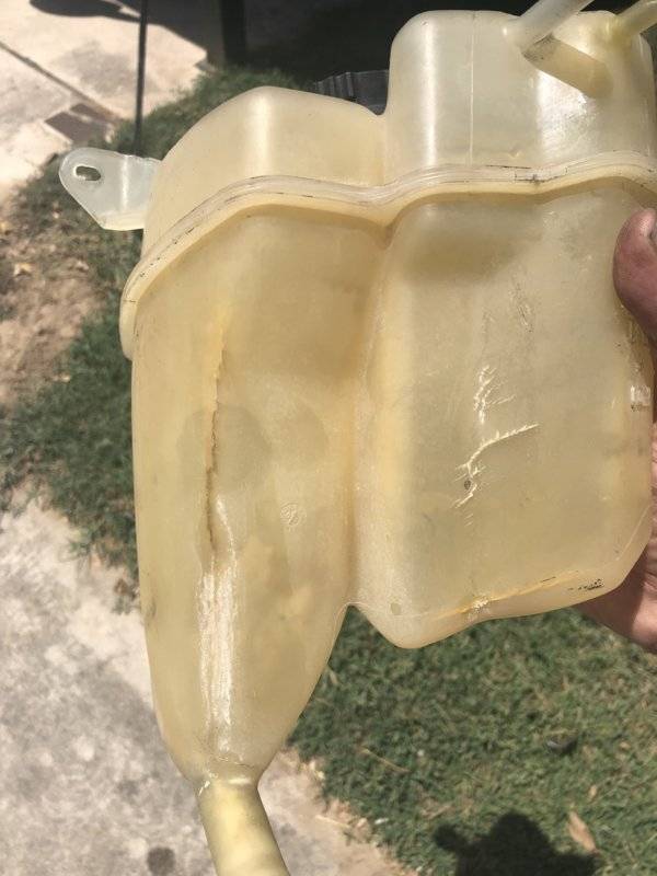

Don't know about a phantom being gone but let's hope the air finally worked its way outOkay all. Here is today's update. Went to check if fan was working properly per Joegr's suggestion. Topped off Degas and started. Ran AC the entire time. Took about to 5 minutes to get to normal (bottom side of middle line).
No leaks and fan running normally. Let idle for 5 minutes with no change. Ran at 2000 rpms for about 2 minutes. Temperature remained normal. Slight increase in pressure on top hose but no overheating. Let idle for another 10 minutes... everything normal. The phantom is gone again!!!
