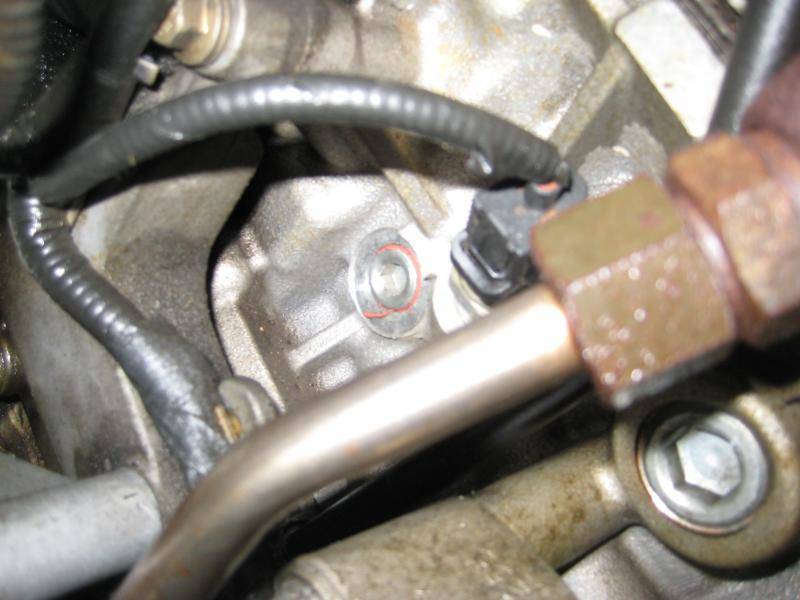

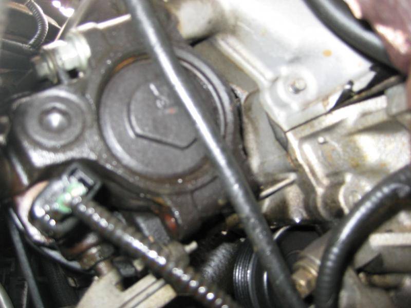

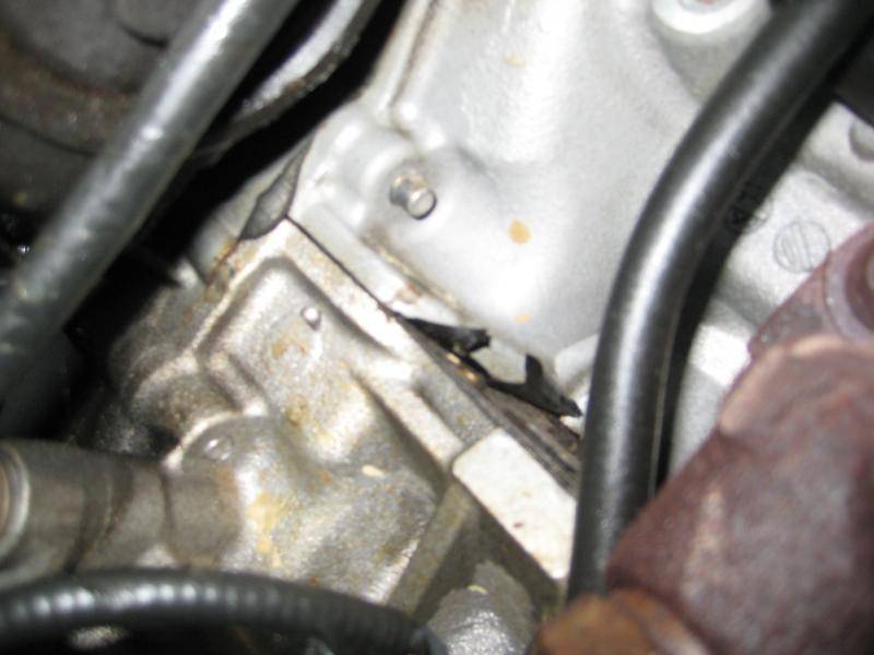

Some people have said it could be a pressure sensor. I will try and clean it up and get some better pics when this rain stops. I have had a hard time even getting a look at it in this weather.
IMG_3175.jpgIMG_3176.jpgIMG_3177.jpgIMG_3178.jpgIMG_3179.jpgIMG_3180.jpgIMG_3181.jpgIMG_3182.jpgIMG_3183.jpgIMG_3184.jpgIMG_3185.jpgIMG_3186.jpgIMG_3187.jpgIMG_3188.jpgIMG_3189.jpgIMG_3190.jpgI am sorry if some of these pictures are disorienting and blurry I got one sunny moment so I went out and tried to get the camera down in the area maybe something obvious might stick out to you. I will have to get a ride to town before I can get any cleaner to spray it down though which will be tonight. If you see a specific area that I need to check or anything that stands out just let me know sorry for the repetitive pics I just didn't want to miss anything. Also any other angle just let me know and I will take it.

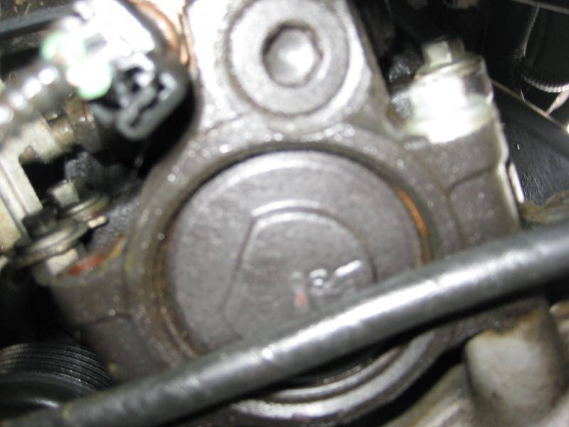

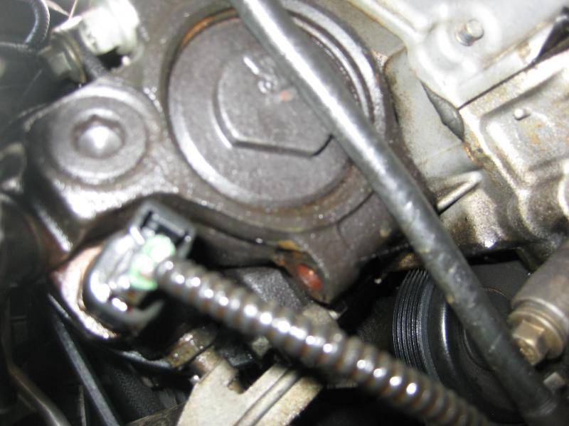

That one copper colored line looks kind of suspect to me it seems really saturated like it may be coming out around it but I am not sure.

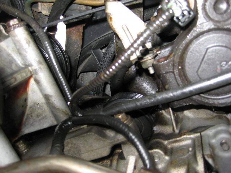

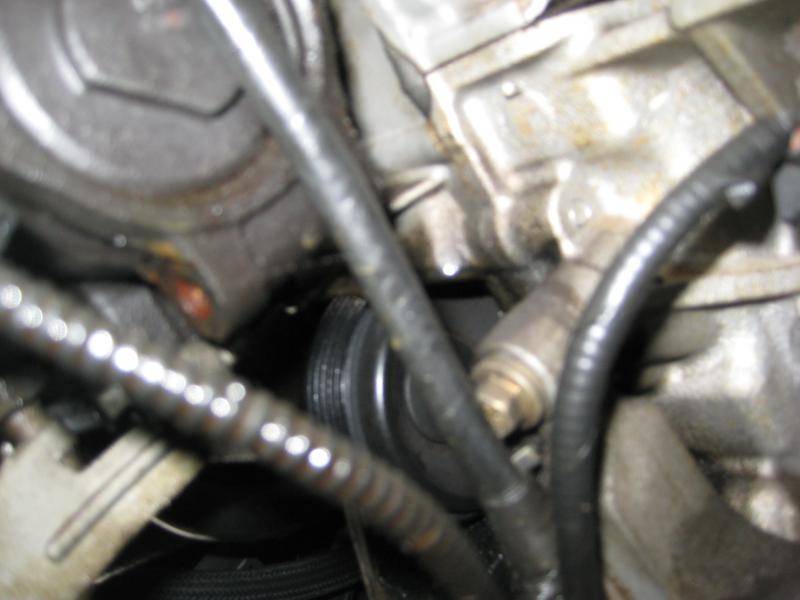

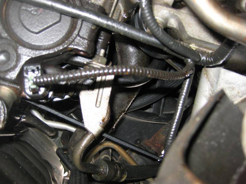

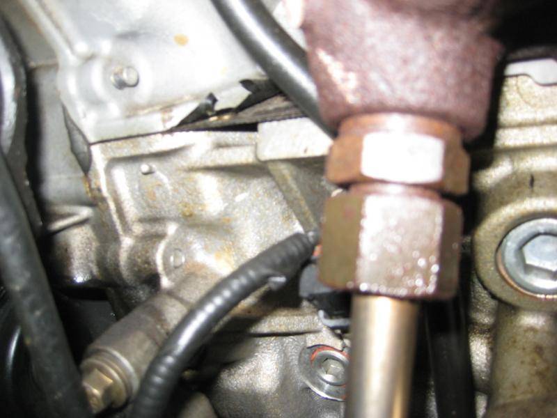

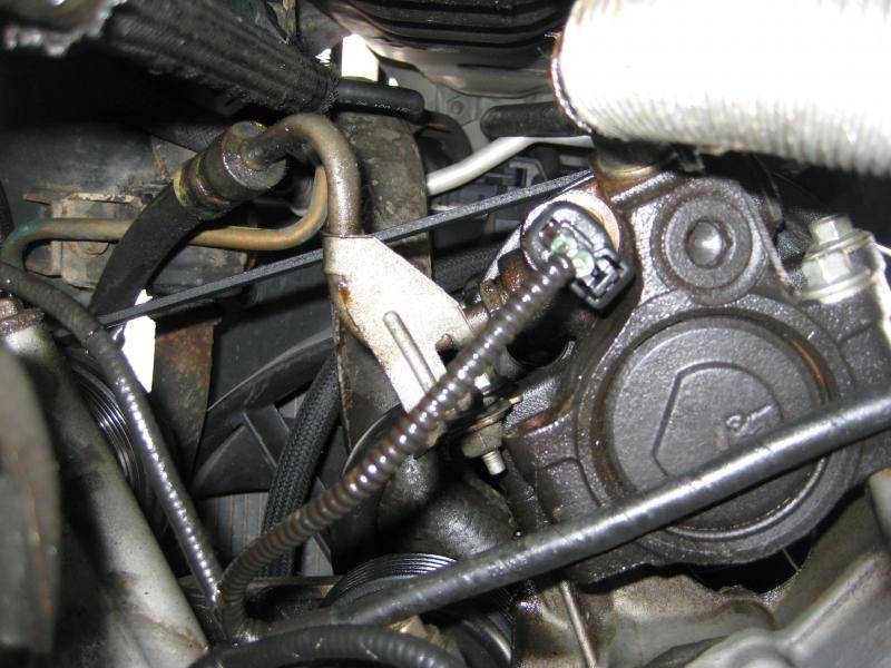

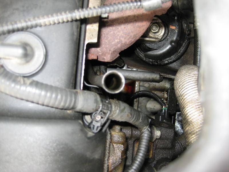

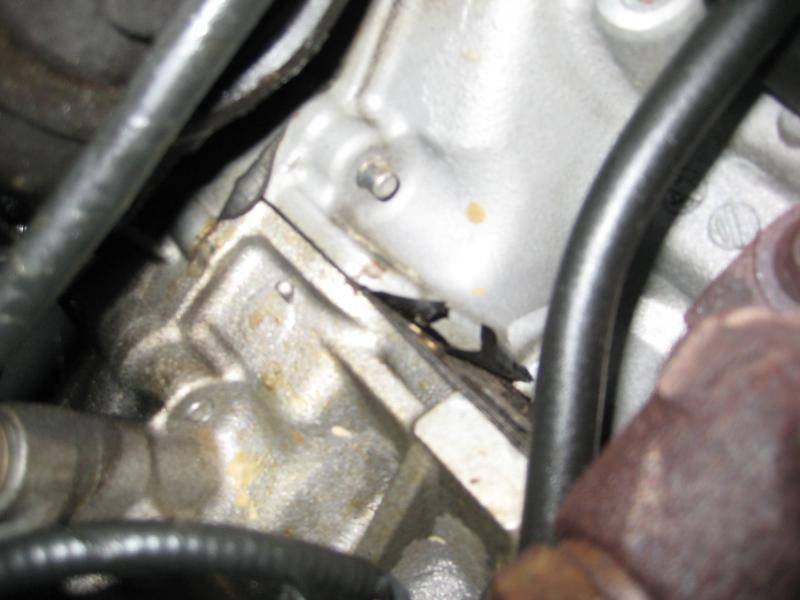

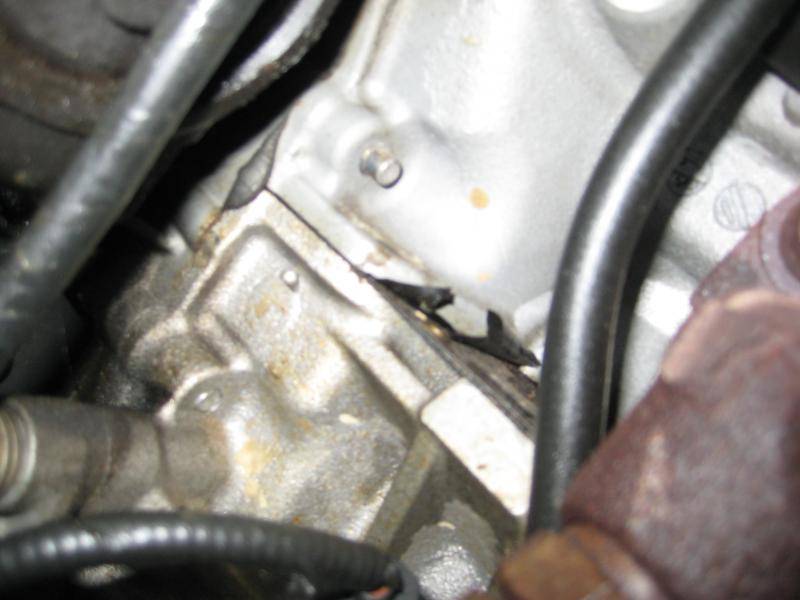

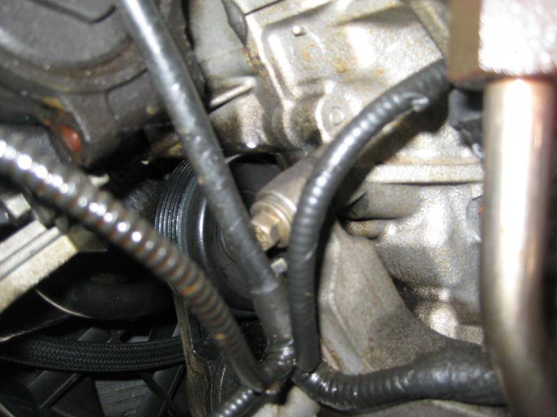

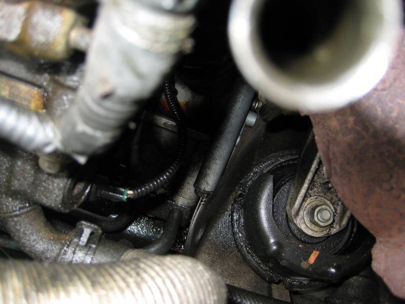

I posted some pics from down below where the problem has to be sorry about the quality it was hard to get the camera in there if anything sticks out to you or you want a better angle on something please let me know. That copper colored line looks like it may be it but I am not sure, I am no pro. I will have to wait until I can get a ride to town later tonight to get any cleaner however. I am out of brake cleaner at the moment my dad must have borrowed mine.

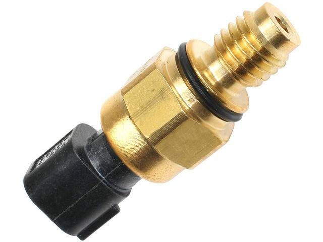

Looks like it is the pressure sensor at the back of the pump to me. However, it could be that the leak is nearby and is dripping or spraying on to it.

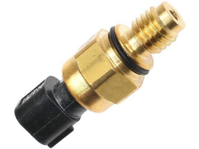

If it is, then you need 1W4Z-3N824-DA (described as "switch") Note that some LSes have the pressure switch in the high pressure hose. Don't get that one by mistake. It won't fit.
1W4Z-3N824-DA should be about $40.

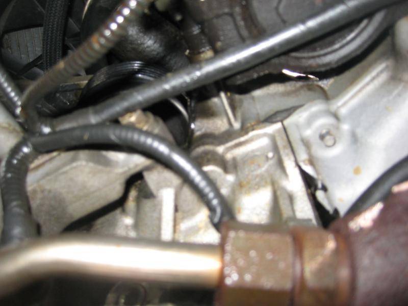

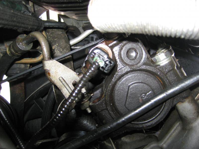

Post 28, picture #1 - the sensor is at the top left, but is out of focus. Picture #2 shows it clearly. It has the two-pin connector with the wiring.
...In the manual it looks like it is in the line so...
AFAIK, any LS could have the pressure sensor in the middle of the high pressure hose, or on the back of the pump. Yours has it on the back of the pump.
Thank you very much for pointing that out now I have a place to start looking. I got me some cleaner and my inspection mirror so hopefully it will be a sunny day tomorrow and I can verify it. A good thing happened also I found a crack in the hose that makes a T across the top of the engine I believe that is my vacuum line. It had previously been fixed with silicone sealant by some mechanic. I have had this problem where the car would want to die at idle sometimes so I have fixed that. It was still held together so that it would run but still had a little vac leak I read on another post about this causing the idle to wanna die. So another problem is fixed that is if I am correct. I know that should be another post but just wanted to mention it as it had been bothering us for a while. It looked intact but wasn't when I picked it up. Anyway I will be checking that switch tomorrow to see if that is indeed the culprit. Thank you for the help.
image.jpgThe pressure switch is on the back of the pump you need a 19 mm deep well socket to get it out.
