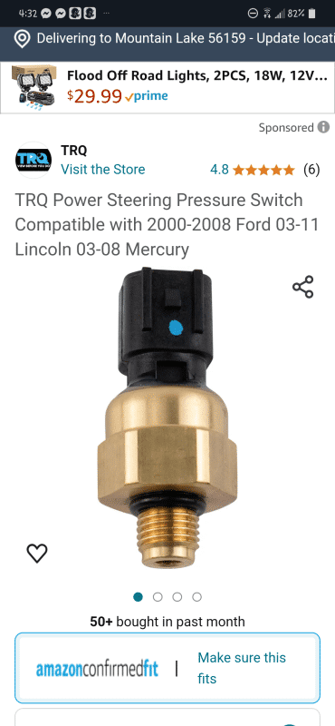

We have a 2002 LS V6 and I looked up this part >>> 1W4Z-3N824-DA and it says it doesn't fit my LS Does the V6 have a different switch?
This site shows it fitting.
Is your switch on the power steering pump, or in the middle of the high pressure power steering hose?
[/URL]
Wow! How strange the other sites I checked said it didn't fit. I am not sure about the location of the switch yet, but will be looking for the leak location tomorrow. I hoped this is where our leak is because if this is not it, I will probably have to go to the mechanic.
