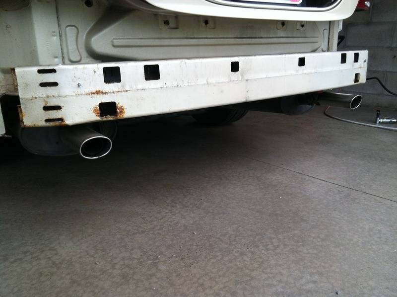

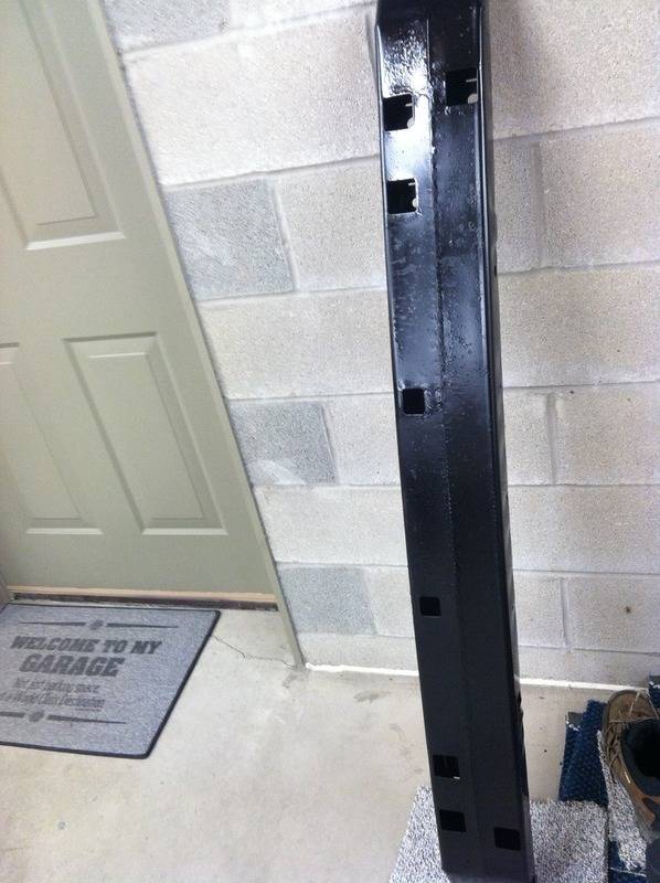

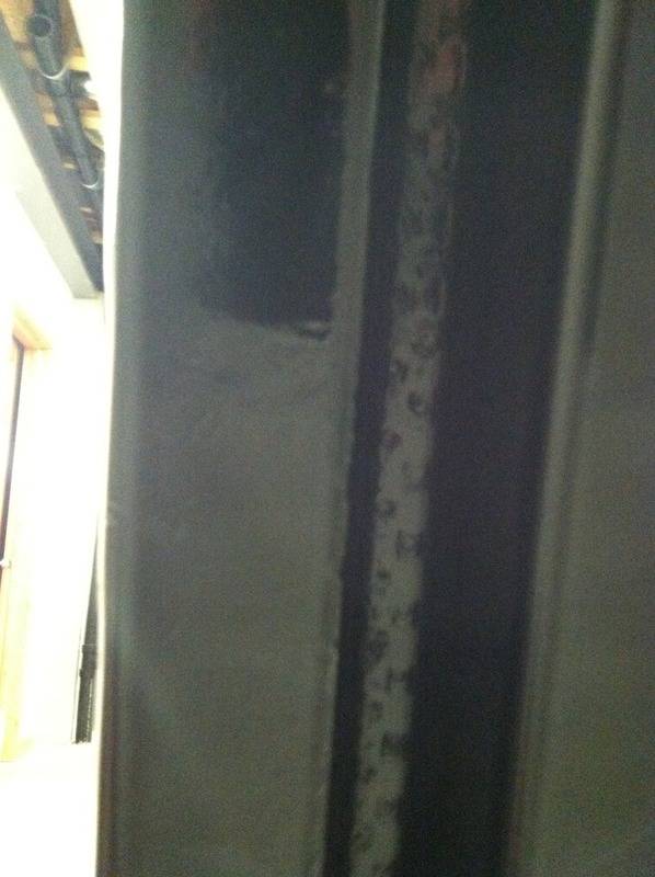

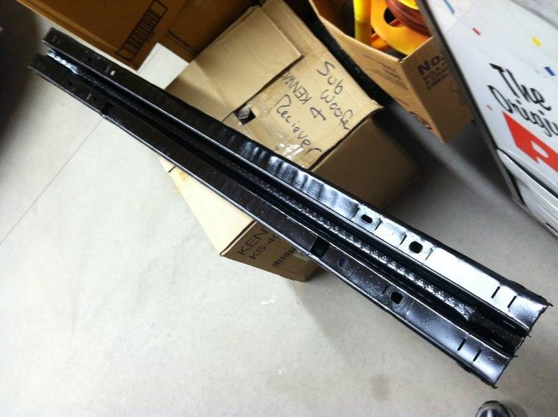

The other day was around 60 degrees, so I started to clean and paint the rear bumper support. I had used Rustoleum High Performance Enamel for extra added protection.
I'll show pictures from the front, back, and the inside where both pieces of rebar are joined together. I gave it 2 coats, 15 min. dry time between coats.
Results:
Once the weather turns for the better, it will get installed. I plan on grinding down the energy absorbers and coating them with POR-15. Along with getting new bolts/nuts to install this new piece.

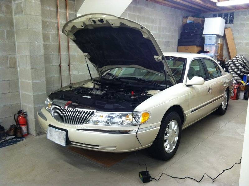

Well I finally got the car out of storage. Hooked it up to the Deltran Battery Tender for a day. Fired right up!

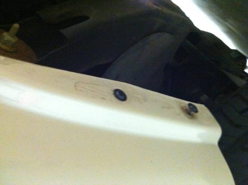

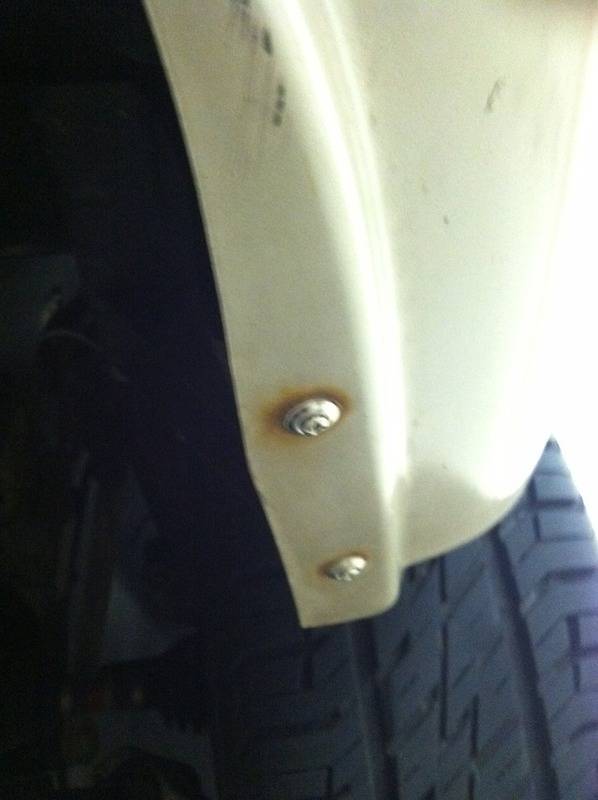

Bought new body fastener screws. These are stainless steel. Along with new screws for my air deflector, they were just to corroded for my tastes. I had used license plate bolts for the screws on the deflector worked perfectly.
Old bumper fasteners:
New bumper fasteners:
New deflector bolts:

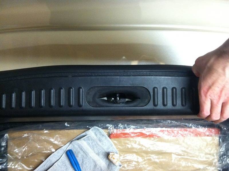

Here are the steps I took:

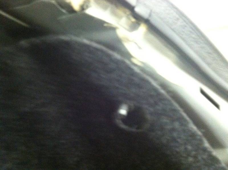

Pop black trim piece off, there are 2 push pins that you need to take off. I used a trim tool for this.

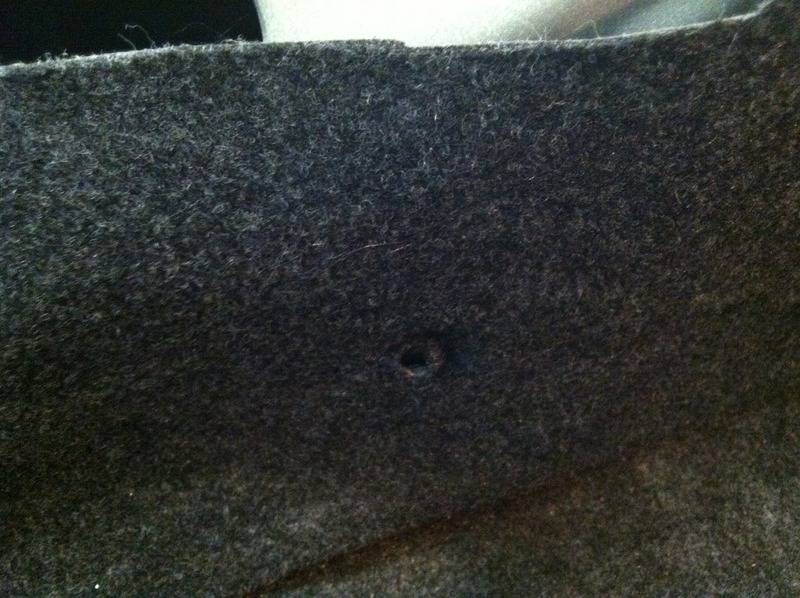

Take off 2 push pins at the lower part of trunk lining, and unscrew black tabs 1 on each side of trunk lining:
2 screw type tabs on each side take off:
There will be 2 tabs 1 on each side of the trunk near the hinge pull them out:

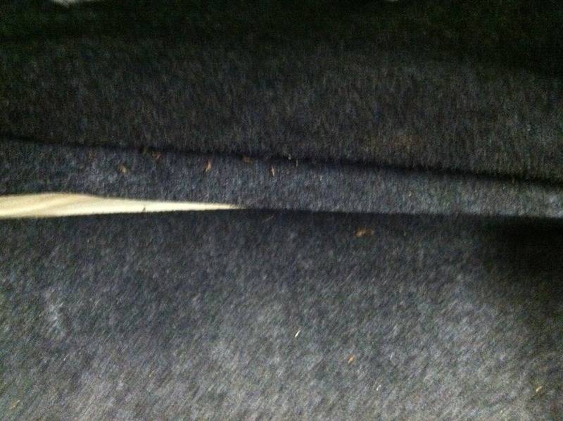

Top piece of trunk lining overlaps just pull up and out, this will give you access to the inner 4 nuts to take bumper off. There will also be 4 nuts 2 on each side of passenger and drivers taillight that needs to be taken out:

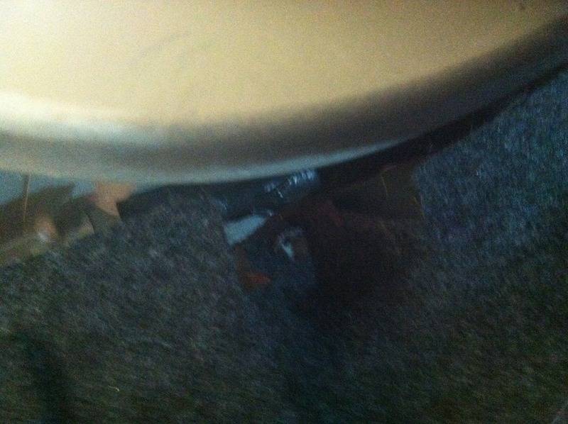

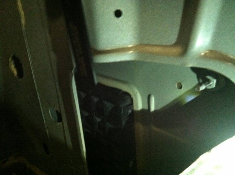

There are 2 nuts on each drivers side and passenger side that need to be taken out. They are located by pulling back trunk lining on the side where the gas cap pull cord is and the air suspension shut-off switch are, in the pic it is the screw sticking out and the 2nd one is where the larger hole is to the left: Drivers side is the same thing:

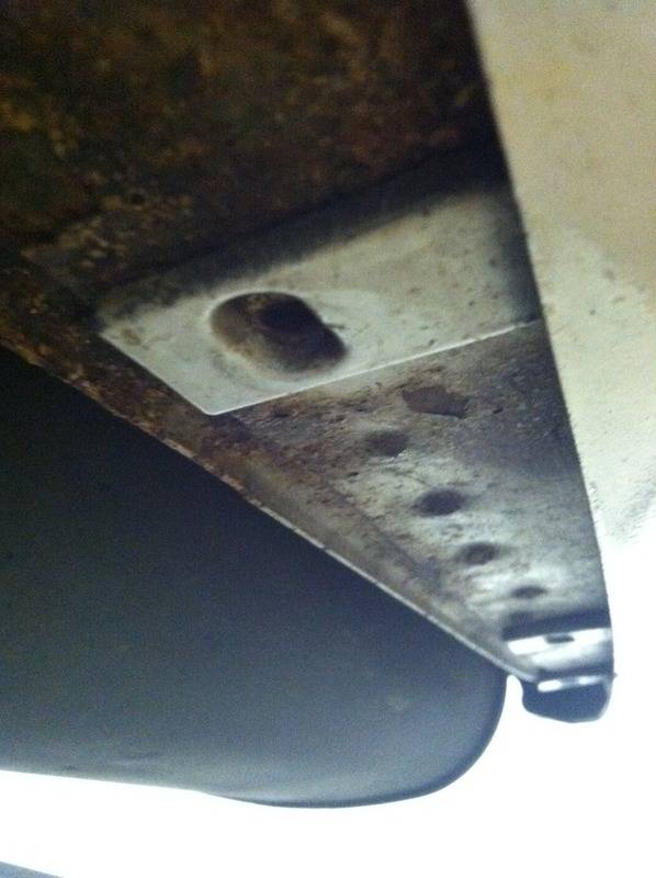

There are a total of 6 black push in fasteners 3 on each side, drivers side and passenger side. Take these out using a trim tool and a rag so no scuffs appear on the bumper and metal piece. As you can see there is some minor rust issues I'll be sanding this down and POR-15 these spots:

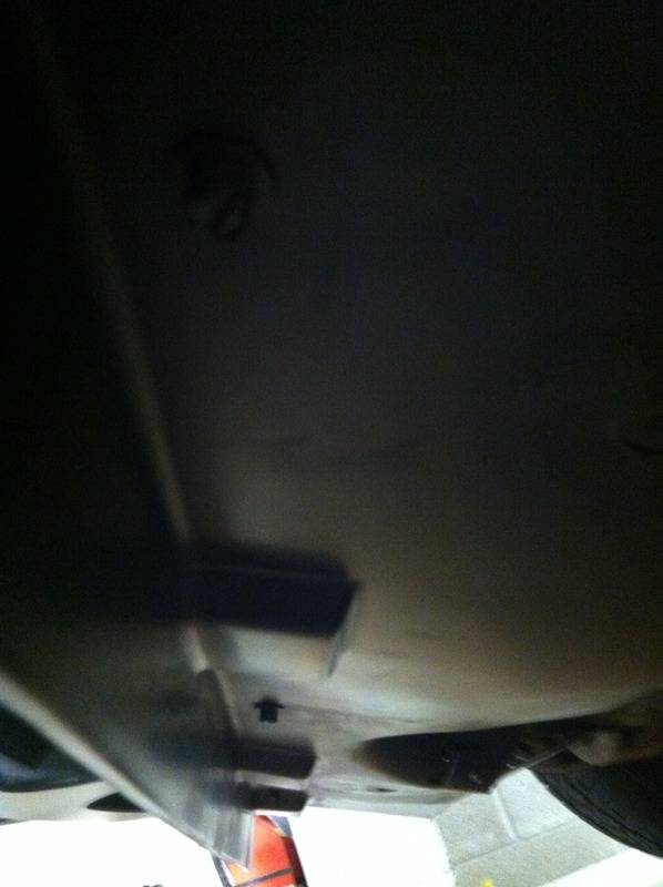

There is one last black push pin fastener it is in the center of the bumper. Take this out, take out 2 screws 1 on each side of bumper behind rear tire, bumper should come off:

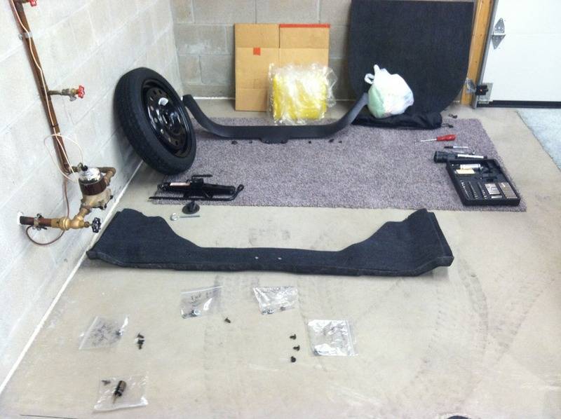

Here is a pic of everything that came off the car. I placed it in order of disassembly to reinstall easier:

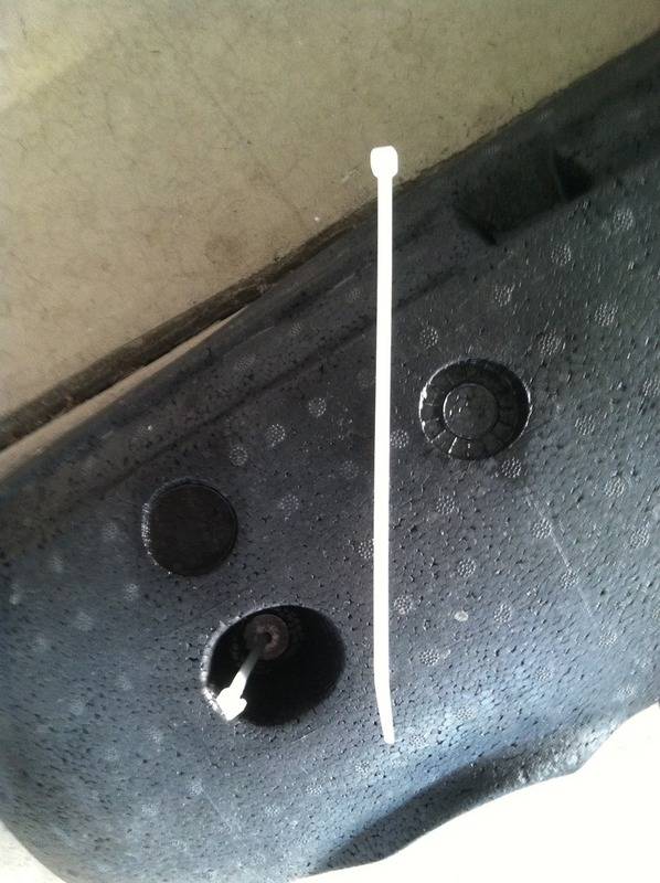

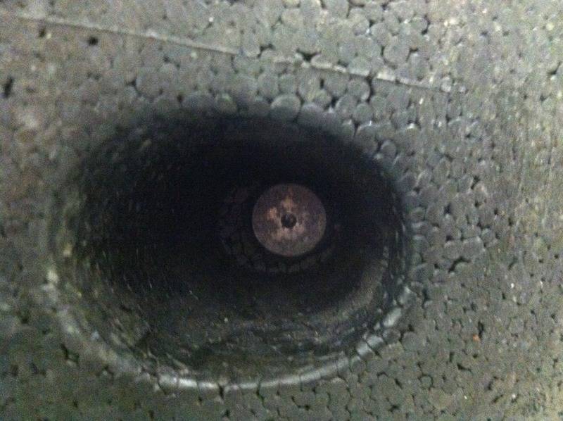

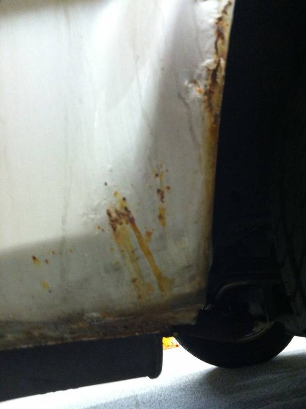

Yesterday I started to do rust removal body work. Here is a picture of the absorber foam on the car along with the rivets that hold it in place. **Note that you have to drill out the rivets to take off foam absorber** :
Foam Rivets:
Original Factory Impact Bar very corroded:

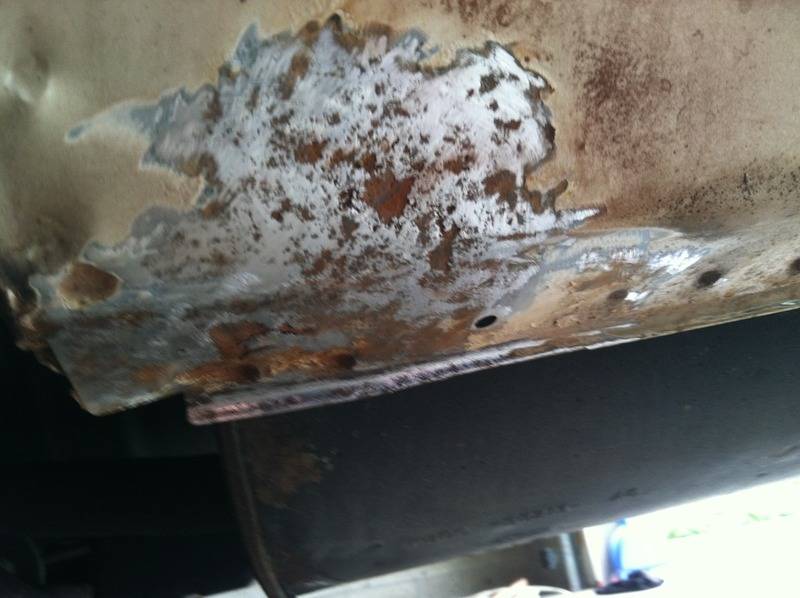

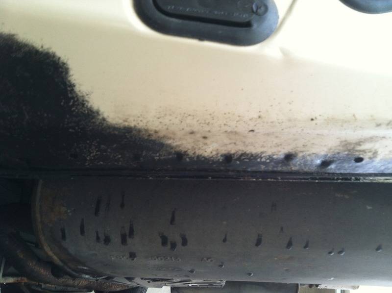

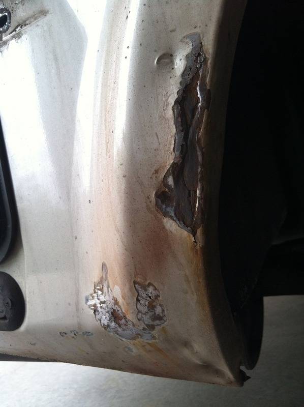

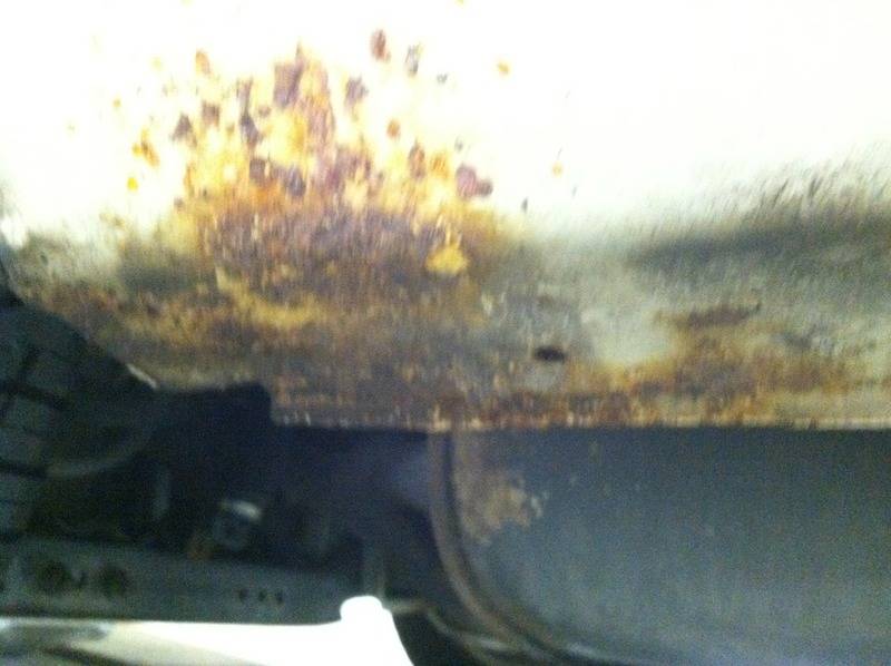

Some minor rust on the rear passenger side bottom quarter:
Minor rust on the drivers side bottom quarter:

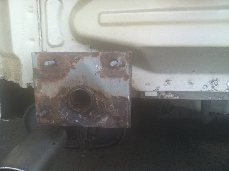

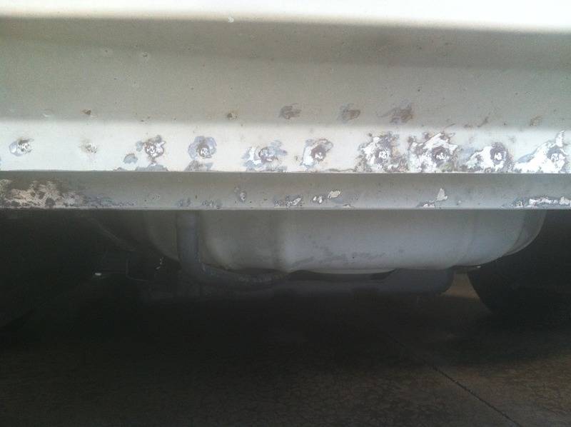

I have a Porter Cable 135 PSI compressor with my new air grinder with multi disks. I started to grind down the rust to this consistency, photo is of passenger side:
Passenger side lower rear quarter, got more rust off than what the picture shows:
Drivers side rear bottom quarter, got more rust off than what picture shows:

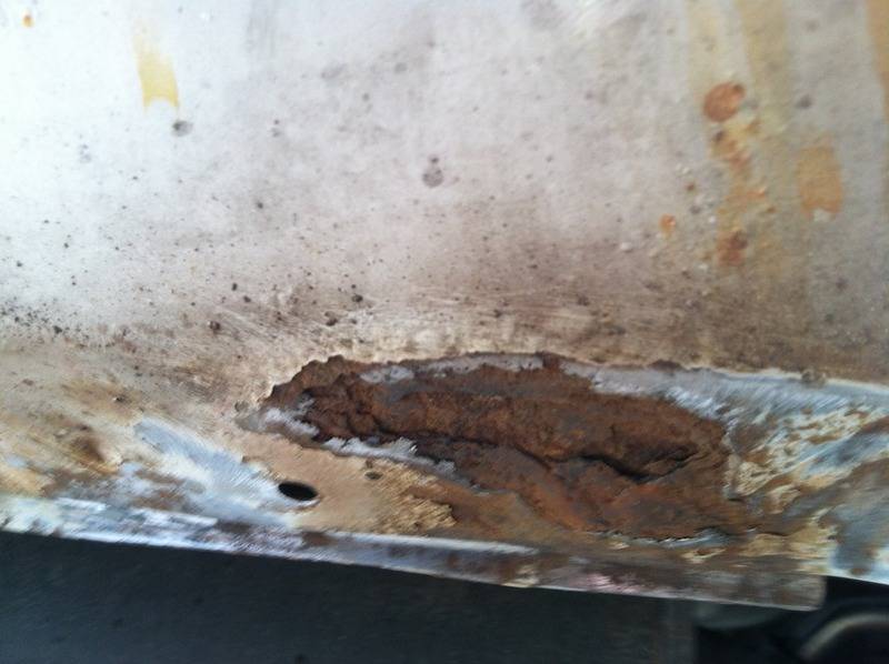

Energy Absorber got a lot more rust off of this than what picture shows:

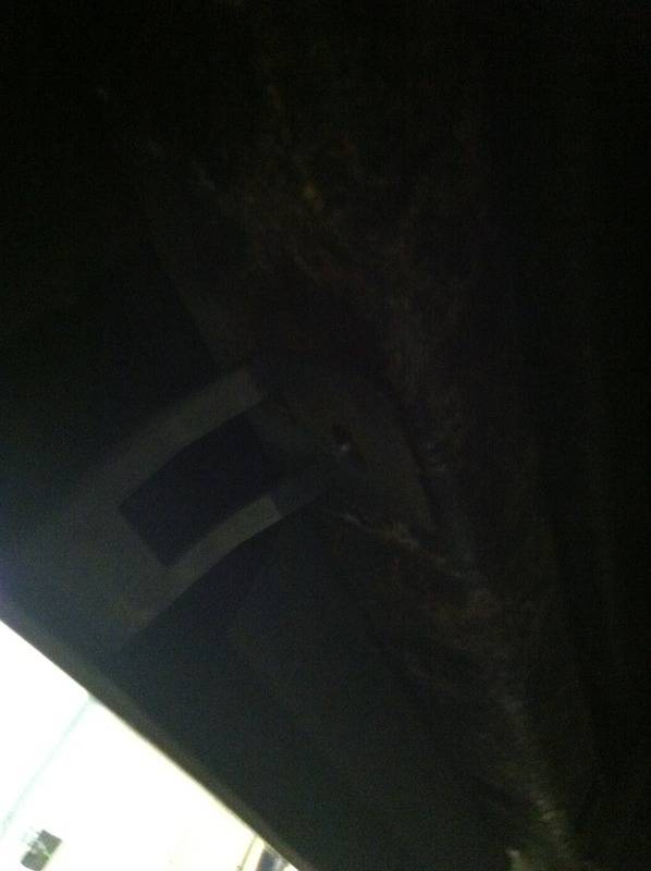

Bottom of trunk reinforcement:

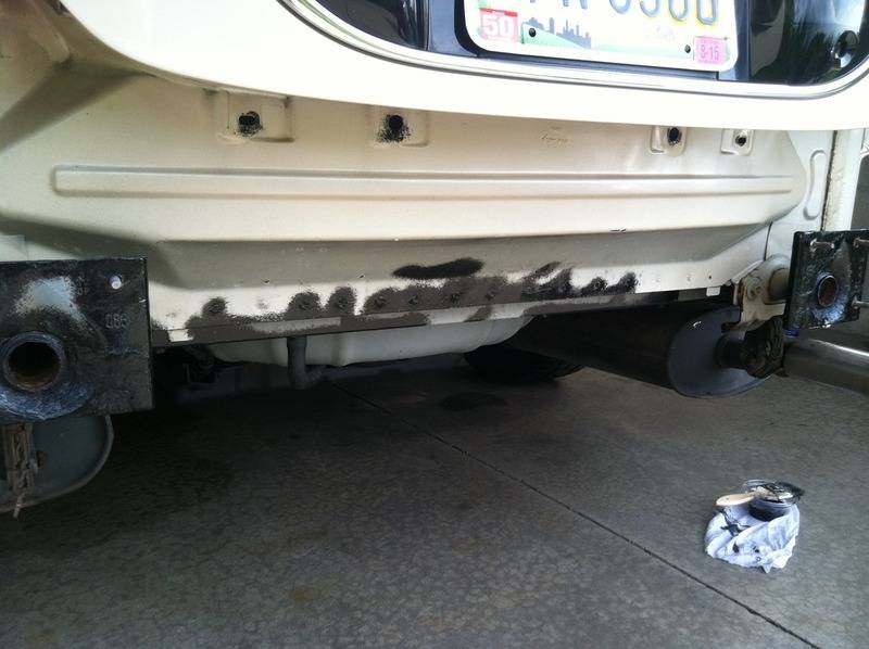

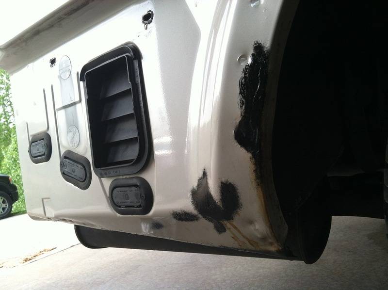

Next I washed and dried the area, let it dry for about 5 minutes or so. Started to POR-15 all the areas I had grinded. Took my time to get in all the areas.
Drivers side rear bottom quarter, Note * I had rust proof paint that I sprayed from where the two pieces of metal overlap all the way to the end. I did this on both sides. Sorry I didn't take a picture..
Bottom trunk brace, energy absorbers painted both front and back, including the extensions, and some screw holes on top where bumper mounts to. Had a tiny bit of rust nothing big or major:
Passenger side rear quarter POR-15, also sprayed rust proof paint on bottom of overlap metal. Didn't have a pic of this. Also wiped away the rust water residue in this photo:
Next I had to figure out how to place the foam absorber onto the new metal impact bar. What I did was I had saved the heads from the rivets, placed zip ties through them so that it sits flush and against the metal bar. Then got another zip tie and zipped the part onto the metal bar. I wish I had black zips instead of white, I was considering painting these but oh well. I trimmed the excess from the zip ties so they are flush:

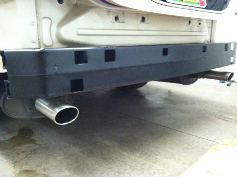

New Impact Bar installed: Looks so much better, I am glad I did this. Even though you wont see it.

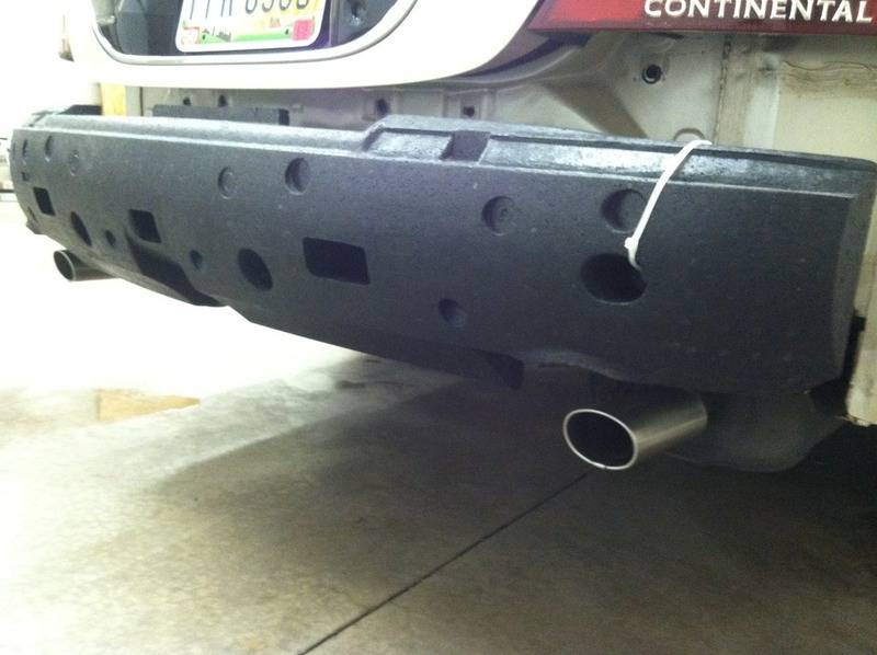

I had washed and cleaned the absorber foam and installed it with zips I tried my best to make it look "good" :
I then waxed the bottom rear quarters, and trunk areas where its painted Ivory White. Cleaned behind the rear bumper, polished my exhaust tips. I didn't take a picture of the bumper reinstalled I will at a later time. Total time it took me was around 6 hours or so. Was not in a hurry and I enjoyed doing this task.
