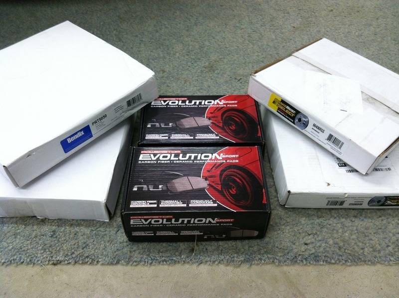

Ok so the rear rotors from Bendix are on back order again until Sept. 29, so I cancelled them. I had picked up the rears at O'reilly's they are from Brake Best Select part # BBR66406RGS Here are the front, rear rotors, and front, rear pads:
I have an appointment for Tuesday at 10am to get these installed. I'll have pictures of the new hardware installed. I also think that I will have this shop do my custom exhaust too. They will quote me on it.

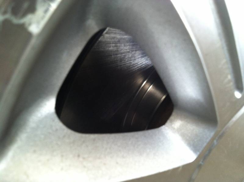

I got everything installed today. They had to grind down the rear caliper pins because of rust. Nothing major the brake pedal feels softer. The car feels great with new brake hardware. I couldn't get good enough pics of the car in the shop, so I took one at home with the new hardware sorry for the bad angle.

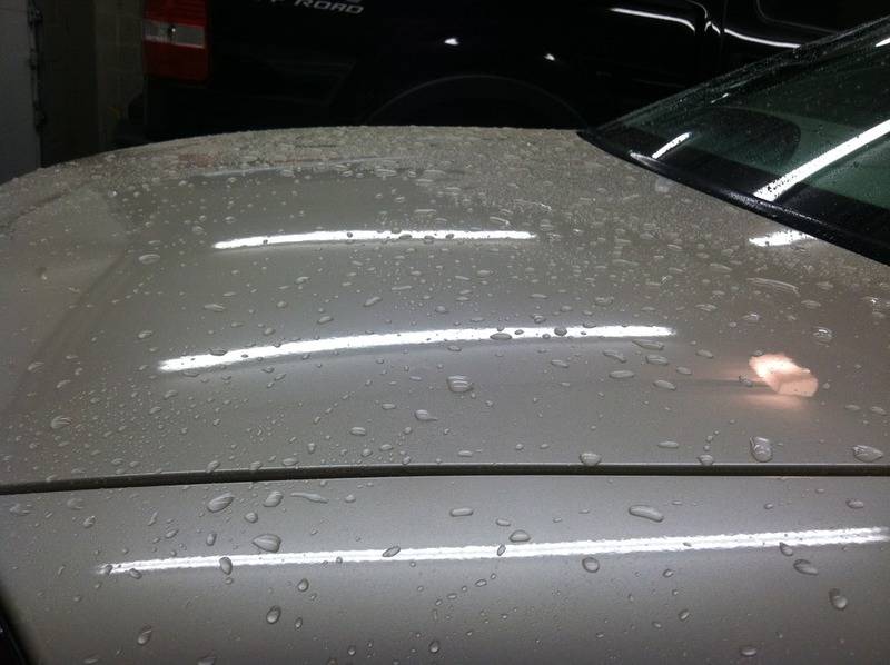

I had washed the car, and touched it up with some Megs QD.
Look at the water bead :) :

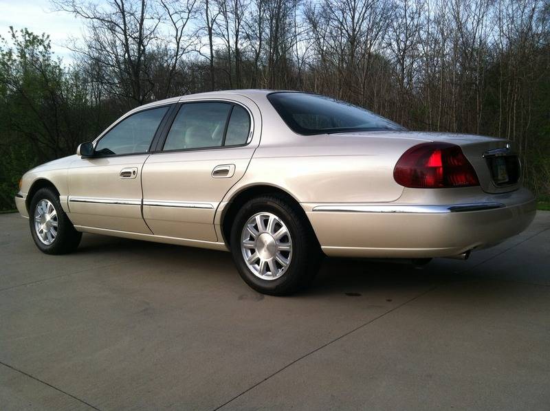

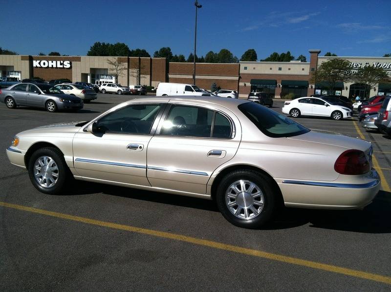

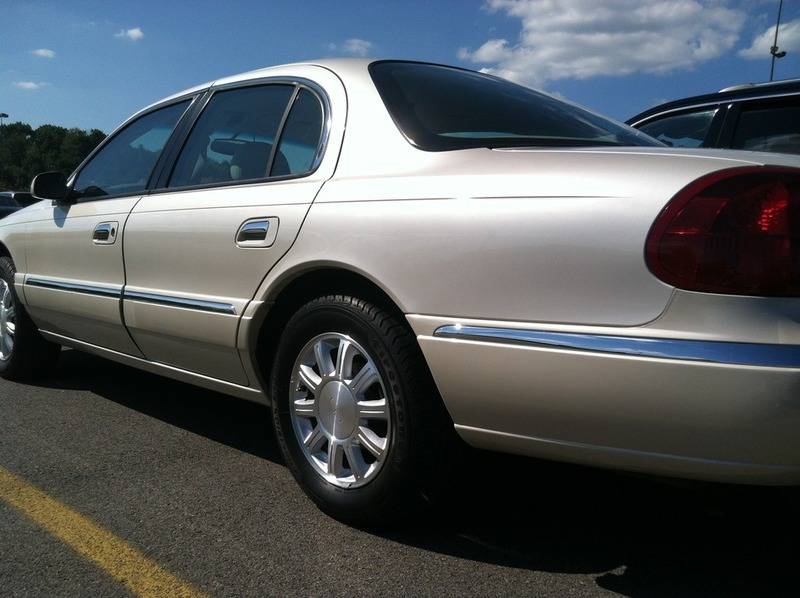

Took some pics in a parking lot, couldn't find any better place to snap them. Pearl white is some what hard to capture the shine in pictures for some reason. Maybe its me...

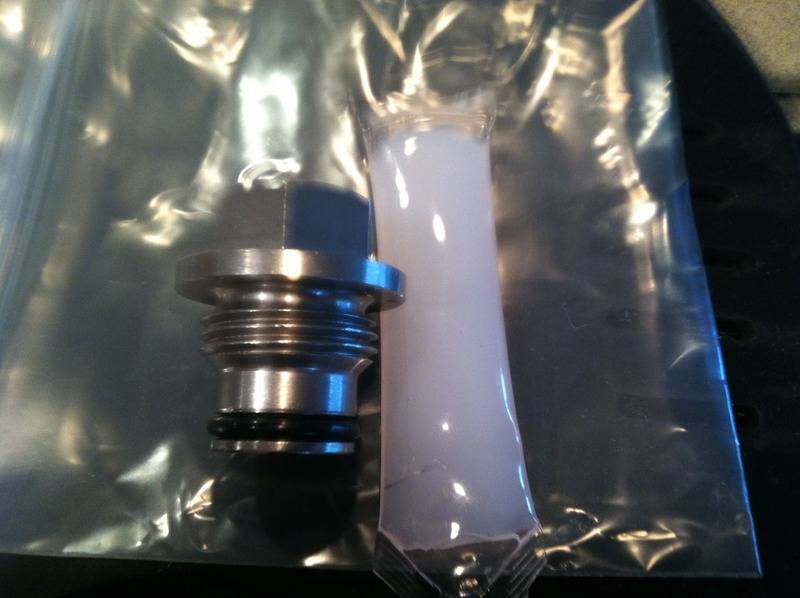

Ok dudes well tonight I changed my coolant. I had used Napa's green antifreeze/coolant for Ford vehicles built 2000 and earlier. They had said it will work just like the Zerex Ford coolant. So I had followed the workshop manual for Continental.

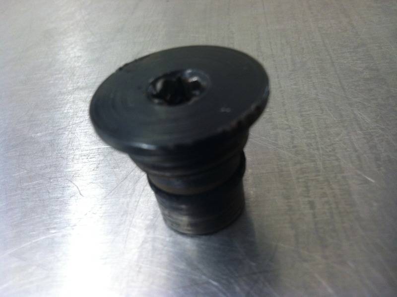

I had bought a coolant cap from a member on this site,very well engineered piece:
Here is the old bypass cap:

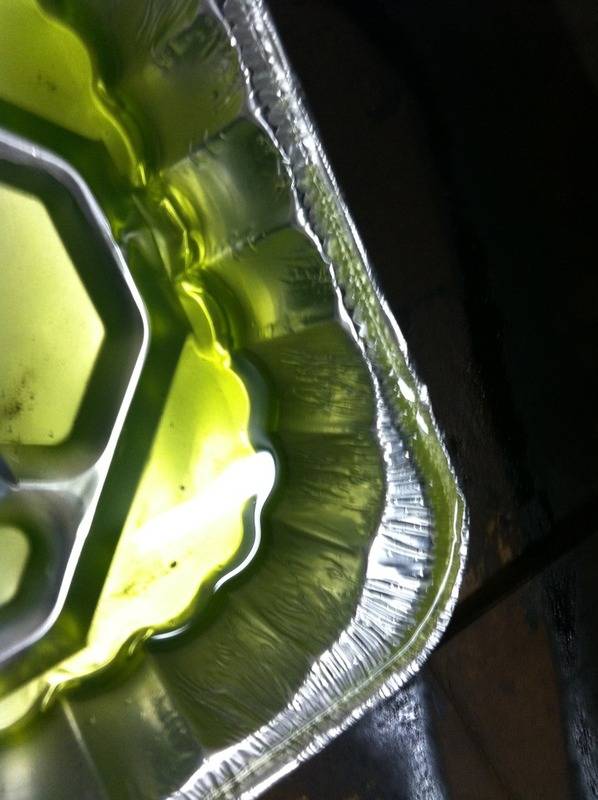

Here is the old coolant, I used tin pans to catch the coolant worked pretty well.
Let car idle up to NORM gauge was at the o no lights or warning messages came up. So evidently I did the procedure ok. Although I am working on getting the hot air to blow hot not cool to touch like it is right now.

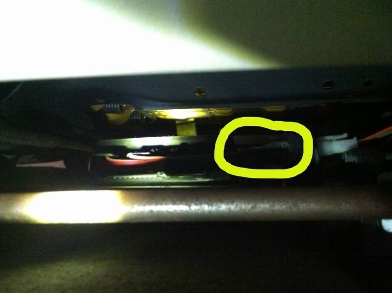

So my power driver's seat quit working on me. It made a loud grinding sound. Here is what had happened I'll post a pic as to show you what you need to do if this happens. Brought the car home inspected under the seat where the electronics are in the DSM module. There was some minor dust on the wires and module itself, once I had cleaned it up I noticed there was a wire that was not seated properly the power seat switch clicked and it started to move seat. It is highlighted inside the yellow circle. Keep in mind this photo was taken upside down so my wire would be on the left if you looked at it in the car, also to point out any of these wires can come unhooked. I would result in you to check this first then fuses, before you were to spend any money.
DSM modules are being sold on Ebay.

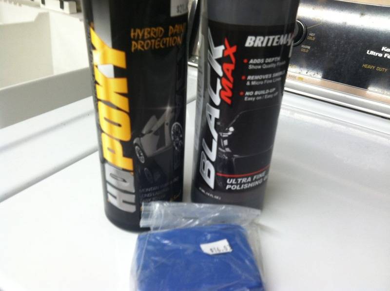

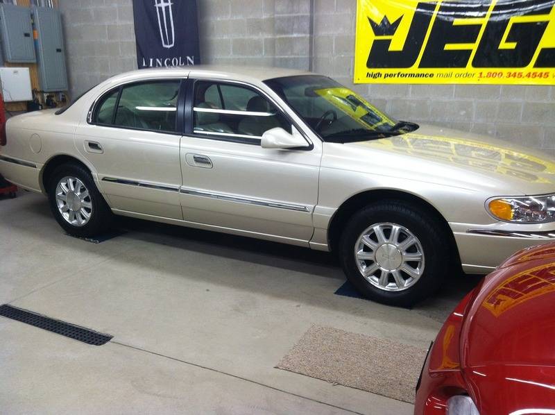

So I put the car in storage for the winter season on November 23rd would have still drove it but because it could snow at anytime and along with Holiday season idiot drivers all around I'm not chancing it. I had washed it with Dawn dish soap to strip all the old wax off. I planned to use a new kind of polish/sealant/wax I seriously was considering purchasing the Zaino kit. But walked away from it when I talked with a professional detailer who told me it was not worth it. There are far more superior products out there than Zaino which are also more cost effective in which I was told. So I ended up purchasing Britemax Polish and HD Poxy sealant and wax. Bought new clay bar and used Mothers QD as lubricant.
Yes I parked the car on carpet squares:

BriteMax polish and HD Poxy, The HD has Montan wax in it its a Hybrid formula which is very durable:

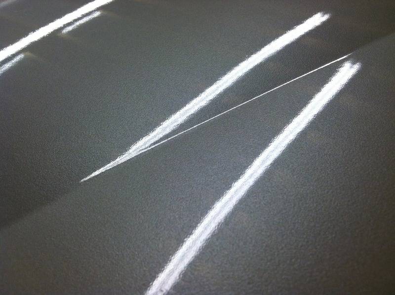

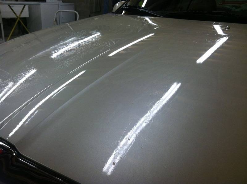

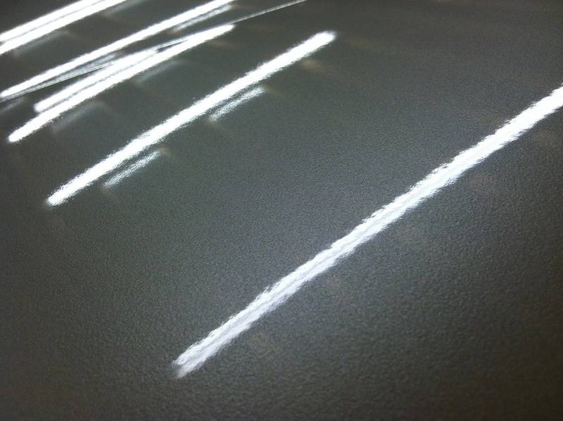

Here is a picture of the hood, after I gave the car 2 coats of Britemax fine polish took polish off using an orbital polisher:

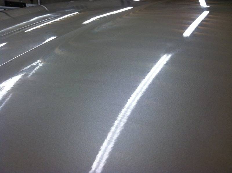

Here are pics of the hood of the car after I had taken off the HD Poxy. One key procedure in using the HD is letting it sit on the paint the longer the better. I let it set for about close to 2 hours.
Hood with HD Poxy setting up:
Hood after HD was taken off with orbital:
