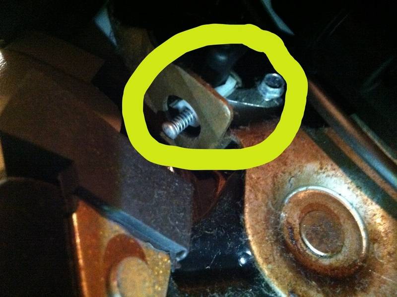

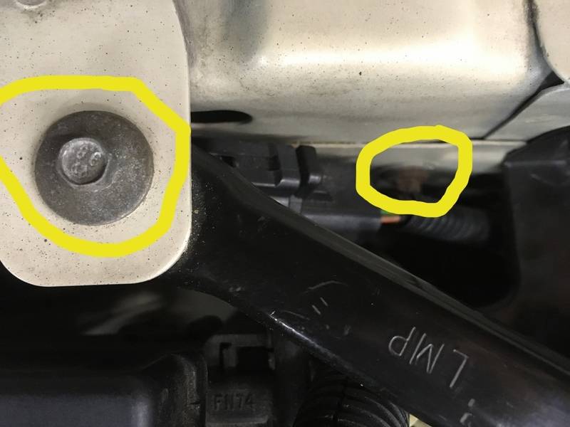

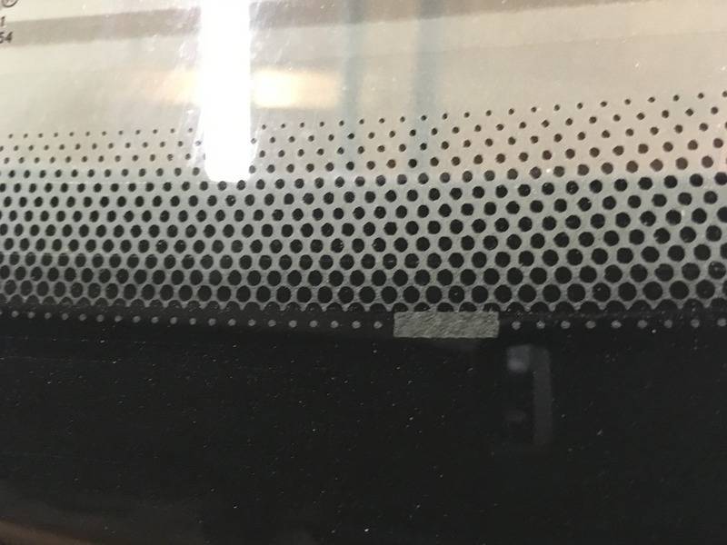

Here is the picture of the switch it is white:
Here is a better angle, I've circled the switch in yellow. Now it may look like there is a screw to take out and replace it, but that is not the case when you are looking at it underneath the dash. Especially when blood is rushing to your head! :

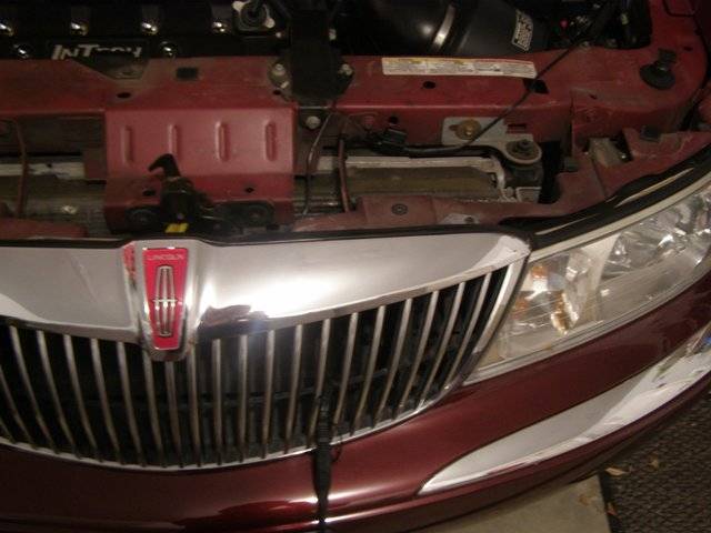

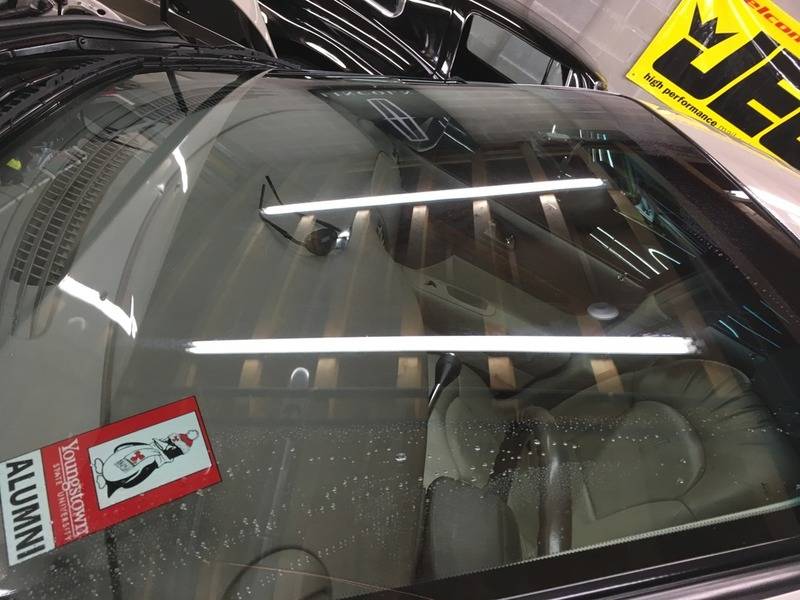

I had thought about getting the headlight film kit from this company: http://www.xpel.com/
Weathertech also has a kit for around $55.00 which is $20 cheaper then xpel kit.
Some people had used the xpel with great results.
Has anyone here done this? Can you post results??

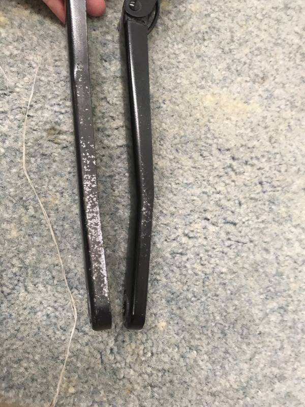

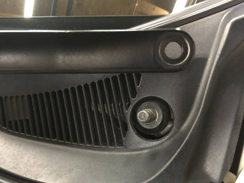

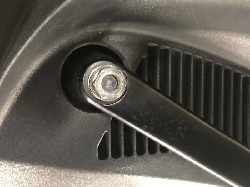

I had refurbished my wiper arms both drivers and passenger sides. They looked kind of weathered, the black paint was slowly flaking off, showing the bare aluminum. In order to remove them you need a 3/8s drive 15 mm 6 point socket.

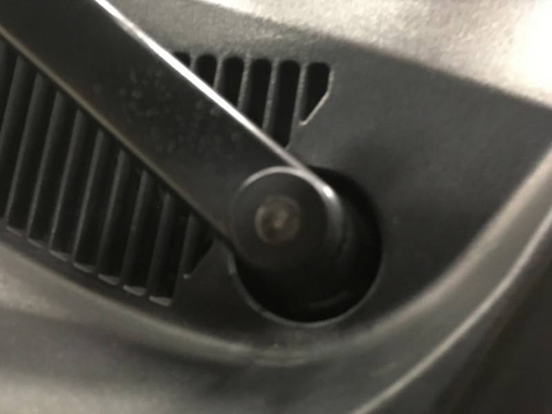

First take off the dust cover, it simply snaps off and on:
It exposes the 15 mm nuts:
Take arm off, you might have to move arm down to remove, same goes for the passenger side:

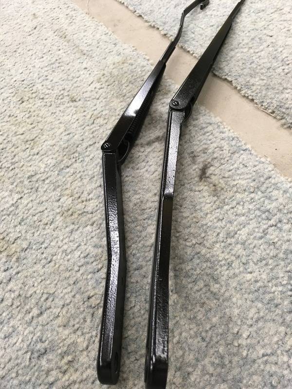

First I had to lightly sand down rough edges of old coating. Here are mine all re-painted with 2 coats of Rustoleum high performance enamel:
To install line up the wiper blade with these small rectangular etchings as you can see in this photo: Same goes for passenger side, these photos are of the drivers side:
**Once you tighten the nuts, pull up on the arms to make them bend, there should not be any play near the bolts, if so tighten them more.**
Lastly clean your windshield with Windex, then spray some water on windshield, turn on wipers to make sure they function properly and are adjusted. It is now complete:

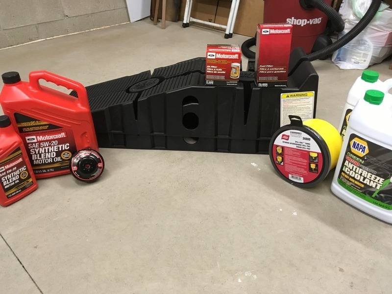

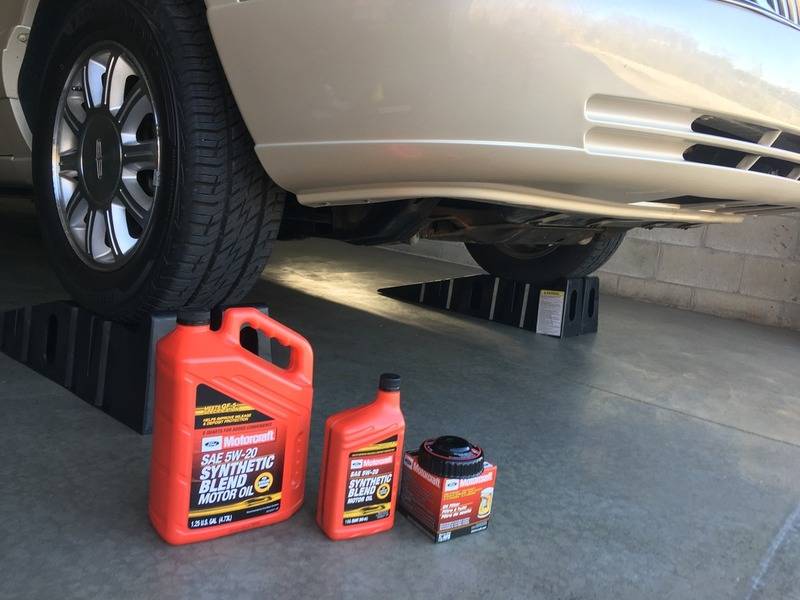

Went ahead and bought some maintenance items:
-6 quarts of Motorcraft 5W 20 synthetic oil
-Motorcraft Fuel filter part #9155 FG-800-A
-2 gallons of NAPA green coolant for 2000 and earlier Ford Lincoln Mercury vehicles pre-diluted 50/50 mix
-Sure Bilt oil filter cap wrench 93 mm 36 flute 3/8 drive
-Rhino Ramps
-Lisle coolant spill free funnel #24680
I will be changing the oil and coolant in the next couple of weeks, stay tuned.

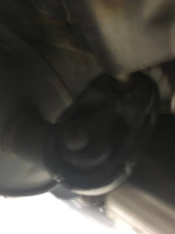

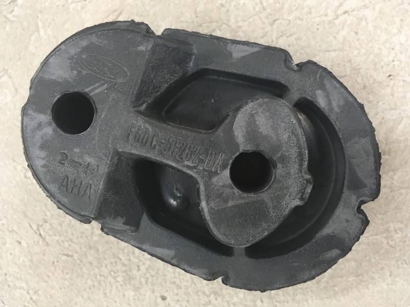

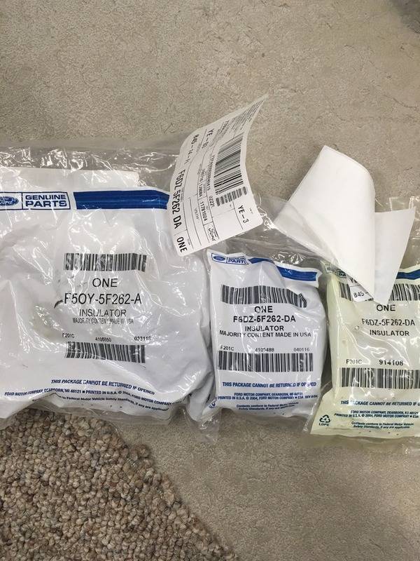

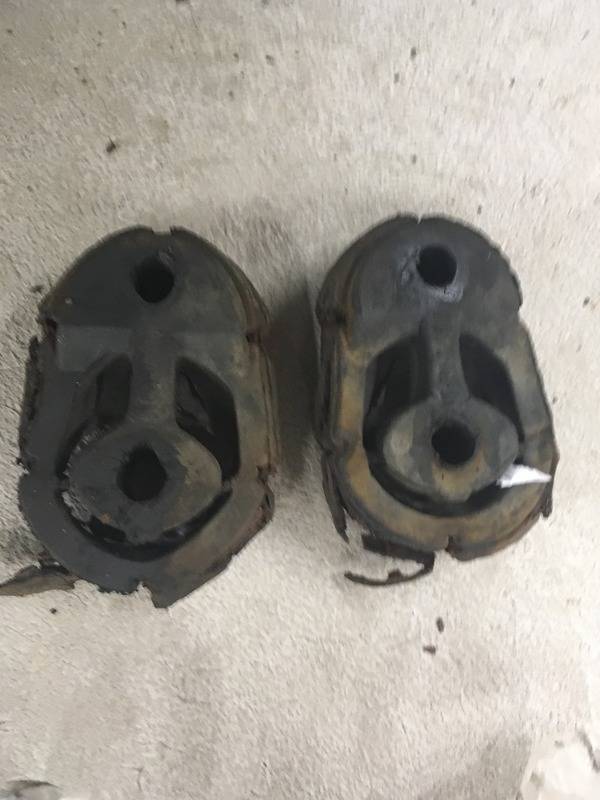

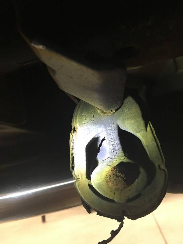

Went ahead and replaced another worn out part on the car. The old parts were dry rotted and falling apart. The exhaust hanger insulators, are a dealer ordered part. They are located where the tailpipes exit the vehicle, the other insulator is located near the center of the car. (I did not replace mine yet it is still in decent condition did not take any photos yet)
Tailpipe muffler insulators (1 comes in each package) : Part #F6DZ*5F262*DA
Center insulator: Part #F50Y*5F262*A
Packaging:
Old insulator on car very deteriorated: Tip* squirt some WD-40 on the inside of the holes where it hangs to slide off easier*
New insulator out of packaging:
Both of the old insulators:
New installed insulator: *Just a tip put some dawn dish soap inside the holes of the part and it will slide on perfectly*:

The new ones will help with the drag down look. Mine had lifted up good after the new ones were installed.
Correct Tasca has them: you need 2 of these considering they are 1 in each package. Same part number for both sides here is the link on Tascas website :
http://www.tascaparts.com/oe-ford/f6dz5f262da
Also your thoughts on soaking them in silicone to delay dry rot?
Well......I guess you can do that, or you can wipe them down with WD or something similar. You can do the same for the rear airbags, I know a lot of people on LVC suggest it. So that can be another thought.
***The middle Insulator*** might need to be ordered through the dealership. That is what I had to do.
Also the part number for the single insulator for the middle section was not found. I copy pasted it from your post.

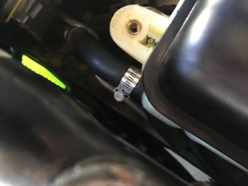

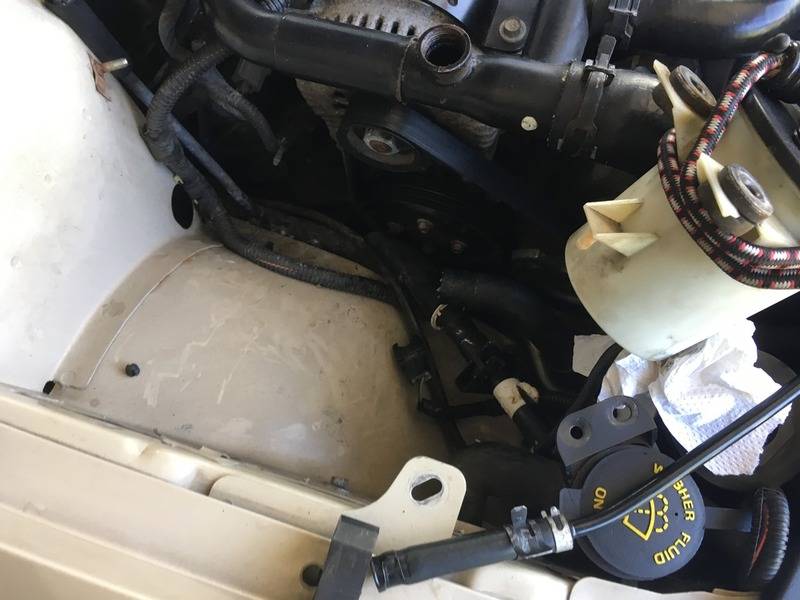

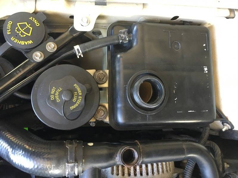

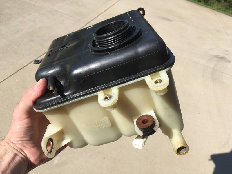

I went ahead and changed the coolant again, this time I took out the recovery tank and cleaned it. I ran into a problem bleeding the system again, I will make a DIY procedure for this and document the problem I am having. This way you all know what to do, if it happens. I might need some help determining what I did wrong. Thanks!
Coolant recovery tank out of car:
Inside nice and clean!! :
Cleaned and detailed the inner fender and hoses, power steering container, and shock tower:
Replaced the damn spring hose clamp with a screw type. Had a hell of a time getting the snap clamp off. All is good:
All back together:

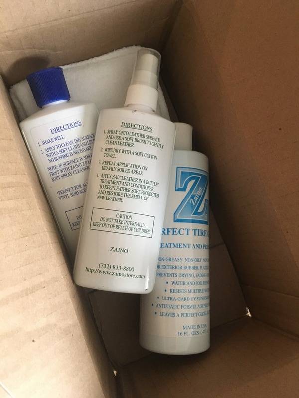

Well I ordered some car care cleaning products from Zaino last week and they had arrived at my door today. I've heard some good things about their products however, I don't have time to do the 12 step process they want you to do to get a "show car shine". A lot of people told me to get their leather care products and also to try their tire shine. So I purchased the Z9 Leather Soft Spray Cleaner (green label), Z10 Leather In A Bottle Treatment and Conditioner (blue label), and finally the Z16 Perfect Tire Gloss. They also included a free applicator pad with my order! That was cool of them. I will show how it cleans up my interior over the winter and provide results of this in my thread. I will also do a DIY for those that want to see results so look for that pretty soon too!
In package:
On the left is the Z9 Leather spray cleaner you use first, Z10 Leather in a bottle in middle, you use this to condition your leather, Bottle on right side is Z16 Tire Gloss:
I can't wait to try this all out!!

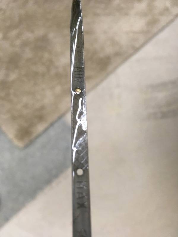

Its getting to be that time of year again so I changed the oil in the Lincoln. Looked at the weather forecast said it was going to snow 1.5 inches tomorrow so I ended up parking it for this season.
Pulled it up on the ramps and got to work. I didn't realize how changing the filter on these gets so messy even when I used a plastic bag to catch the filter.
6 Qts of MotorCraft 5W 20 full synthetic and an FL820S filter (pre-filled half way up):
Fresh and clean a very nice site :headbang: :

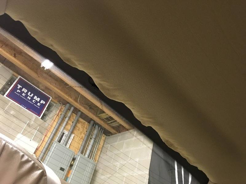

3. Take down headliner and get recovered. (I am in the process of doing this and its a pain because I need the special Torq bit/star bit to take out bolt for seat belts. I don't even know where to get this. Plus I have side curtain air bags. I don't want to screw those up....I may just wait until spring and take it to an upholstery shop and have it done. Shouldn't cost that much, considering I took down the over head consolete, and all 3 grab handles.
4. Condition Leather with Zaino Z9 and Z10.
***I started to take down the headliner, the only thing is I can not take out the bolts for the seat belts. I need a star bit "Federal Govt. tool" as I call it to take seat belts off. Well I have passenger side airbags, I do not want to screw those up. I think I will take the car in to the interior place and have them take it down. I already took off the grab handles, overhead console (I might do a DIY on this if you all would like let me know please), and took off the A pillar covers. *** In the Spring this car will have a new headliner. Hopefully it won't cost to much, considering I took off majority of the interior components. I'll be getting a quote for this process. I'll let you all know how much, so you know what to expect if your's needs redone.
Rear part of headliner that needs replaced, Notice how I had tried to glue it back up with fabric adhesive which didn't work:
Headliner with majority of components removed:
Got a quote of $375.00 to take down the headliner and replace the cloth. Don't know if that is high or not, we only have one place that does upholstery work where I live.

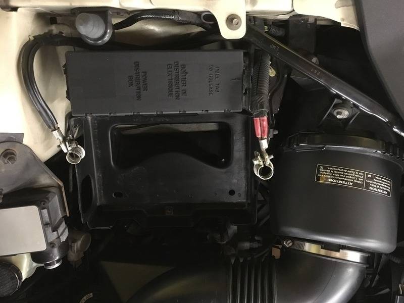

Over time I think I will be placing a Battery Tender Plus on my car full time eventually. I need some feedback as to where a good ground would be to hook up the negative ring terminal from the tender? As to not disturb anything and cause a fire or whatever...thinking to much I know. I'll post some pics I have taken, please provide feedback if you can. I'll use the positive ring terminal and connect directly to the battery, unhook from tender and tuck up into bumper for convenience while off the tender. Easier to place the cover on the car too this way, plug in ready to go. What about if I got the cigarette lighter adapter from Battery Tender Plus and kept it plugged in through the cig outlet? Can you see any harm doing it this way?
I am tired of the rear air bags deflating when disconnecting the battery and taking it out of the car, it looks like a low rider and can not be good for the air ride system....wonder if there is a way to keep rear end up when battery is unhooked??
On a side note any of you dudes used a Deltran Battery Tender Plus before on your Lincolns?
Thanks
Here is a picture of drivers side where battery is located:
I've circled where I think would be a potentially good ground location in yellow.....where else do you dudes think?:
